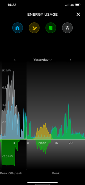

1 hour ago, john0wingnut said:
I have successfully used no peak electricity

4 minutes ago, john0wingnut said:
PV is straight into consumer unit, as is the Powerwall.

1 minute ago, SteamyTea said:
What size inverters are on each.
Just trying to establish how large a load you can draw without importing.
Inverter 1 has 4Kw array and Inverter 2 has 3Kw.
The powerwall itself can provide 5kw peak
In the summer the grid usage was minimal and we still exported a load, as once powerwall charged and house using saying 0.5kw, everything else goes back to the grid. I ideally need another powerwall really. But, heatpump didnt run for most of those months, as DWH was done by the solar thermal, so solar + battery covered everything off and no pre-charging was needed during E7
Recent days has seen about 2-3kw max from the panels around midday, so in theory with the powerwall no grid would be required up to 8kw in peak light, but in reality its putting out about 1.5kw in winter light, so 6.5kw before grid during the day I would say at the minute

Shame there is not a cheap energy monitor that can show the amount and direction of usage.
Just now, SteamyTea said:
Thanks
Solaredge inverters and Powerwall do track all of this.

I look at it in the apps, rather than download, but the graphical representation of the daily graph tells the story nicely in that example I posted.
51 minutes ago, SteamyTea said:
is the dark green that is negative, the imports?
No.
Blue = home usage
White = grid import
Green = powerwall - negative below the line is charging of power wall, above is discharge / use of powerwall.
Yellow = solar
