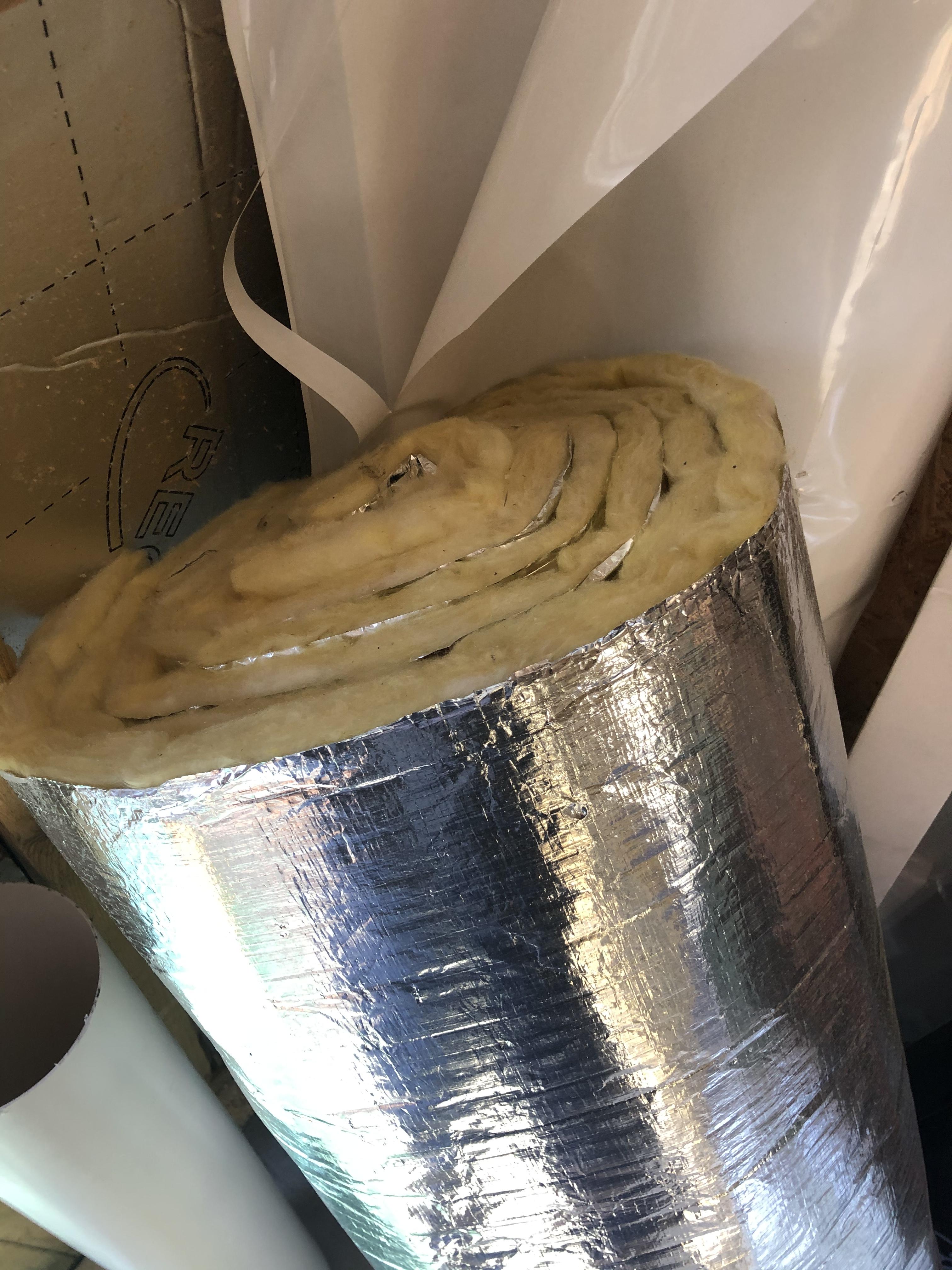

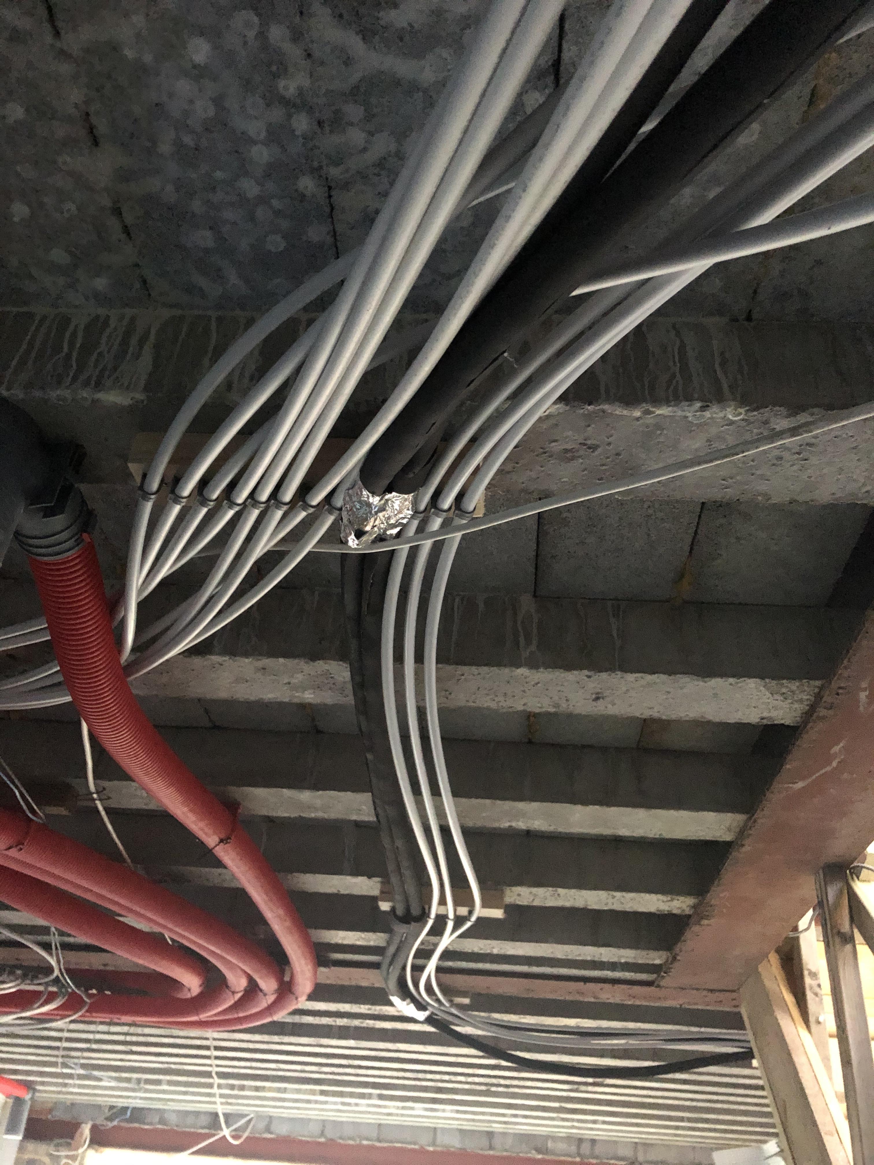

Pocster Posted November 8, 2019 Author Posted November 8, 2019 Ok . Individual hot pipes not an issue . But where they all cross is going to be a pain - photo 2 Rather than try and do each hot individually can I cheat a bit here and wrap the whole lot ( hot and cold ) in some foil backed insulation I have lying around - photo 1
MJNewton Posted November 8, 2019 Posted November 8, 2019 I wouldn't wrap the hot with the cold; there's nothing worse (for me at least!) as getting like warm water out of a 'cold' tap! (Admittedly that's a First World problem if ever I've heard one...)
Pocster Posted November 8, 2019 Author Posted November 8, 2019 4 minutes ago, MJNewton said: I wouldn't wrap the hot with the cold; there's nothing worse (for me at least!) as getting like warm water out of a 'cold' tap! (Admittedly that's a First World problem if ever I've heard one...) Fair point . I’ll semi cheat and wrap all the hots together !!
MJNewton Posted November 8, 2019 Posted November 8, 2019 Weaving sheet insulation in like that may well work perfectly - insulating both hot and cold at the same time but on different sides!

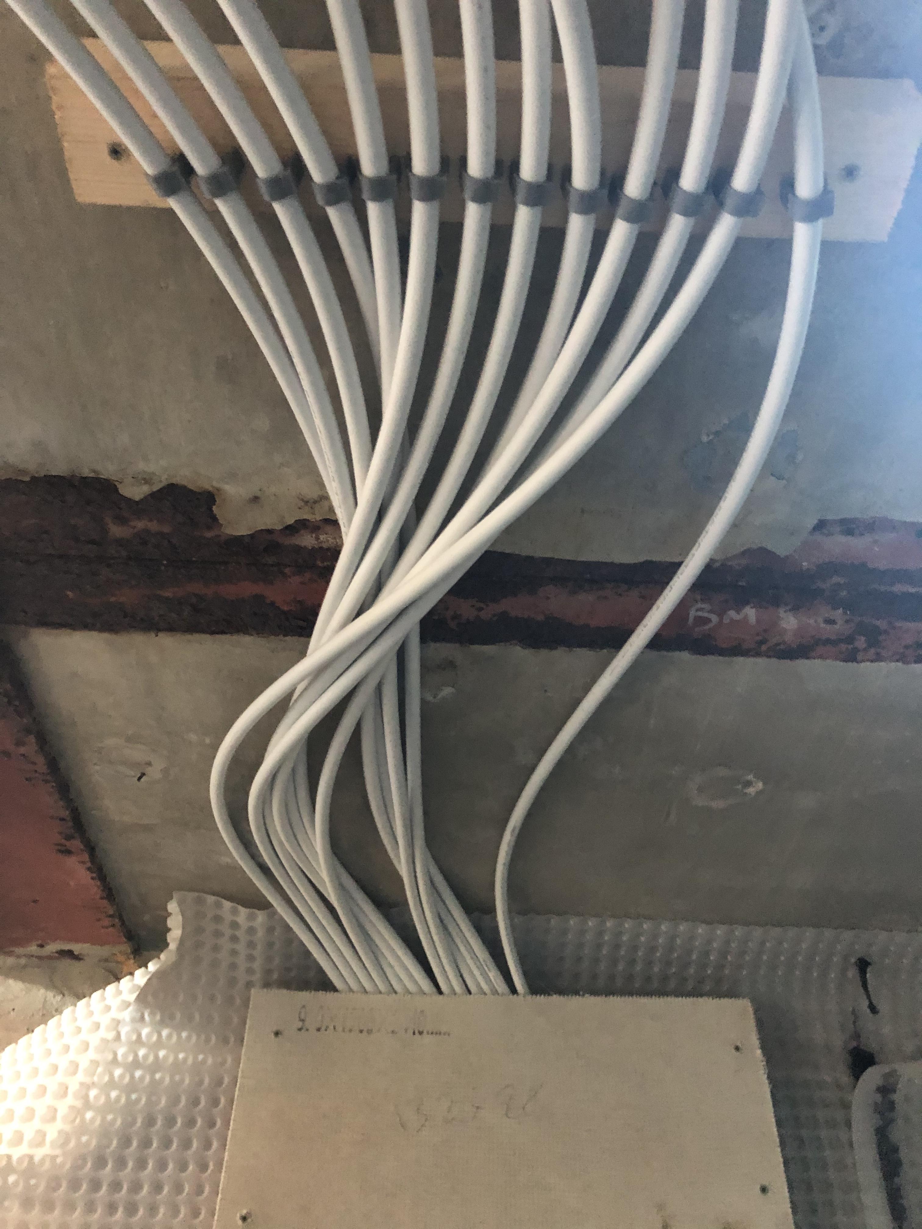

Pocster Posted November 8, 2019 Author Posted November 8, 2019 Note to self . lag pipes as you go not after they have all been installed .

Pocster Posted November 8, 2019 Author Posted November 8, 2019 1 minute ago, Mr Punter said: Not quite the look that @PeterW goes for... ? It was a bit of a mare to get 19 pipes to all play nicely . Functionality over form .

Onoff Posted November 9, 2019 Posted November 9, 2019 Not a criticism but I'm guessing you didn't use a decoiler? Pipe having it's own natural lay etc (like cable). 1
Pocster Posted November 9, 2019 Author Posted November 9, 2019 31 minutes ago, Onoff said: Not a criticism but I'm guessing you didn't use a decoiler? Pipe having it's own natural lay etc (like cable). Nope - didn’t even know there was such a thing . So 100m of pipe when unrolled wants to roll back up . Was a dog to ‘fight’ against . But as I said apart from looking pretty ( and you won’t see it once the false ceiling is in ) I didn’t see any point in making it look nice .
