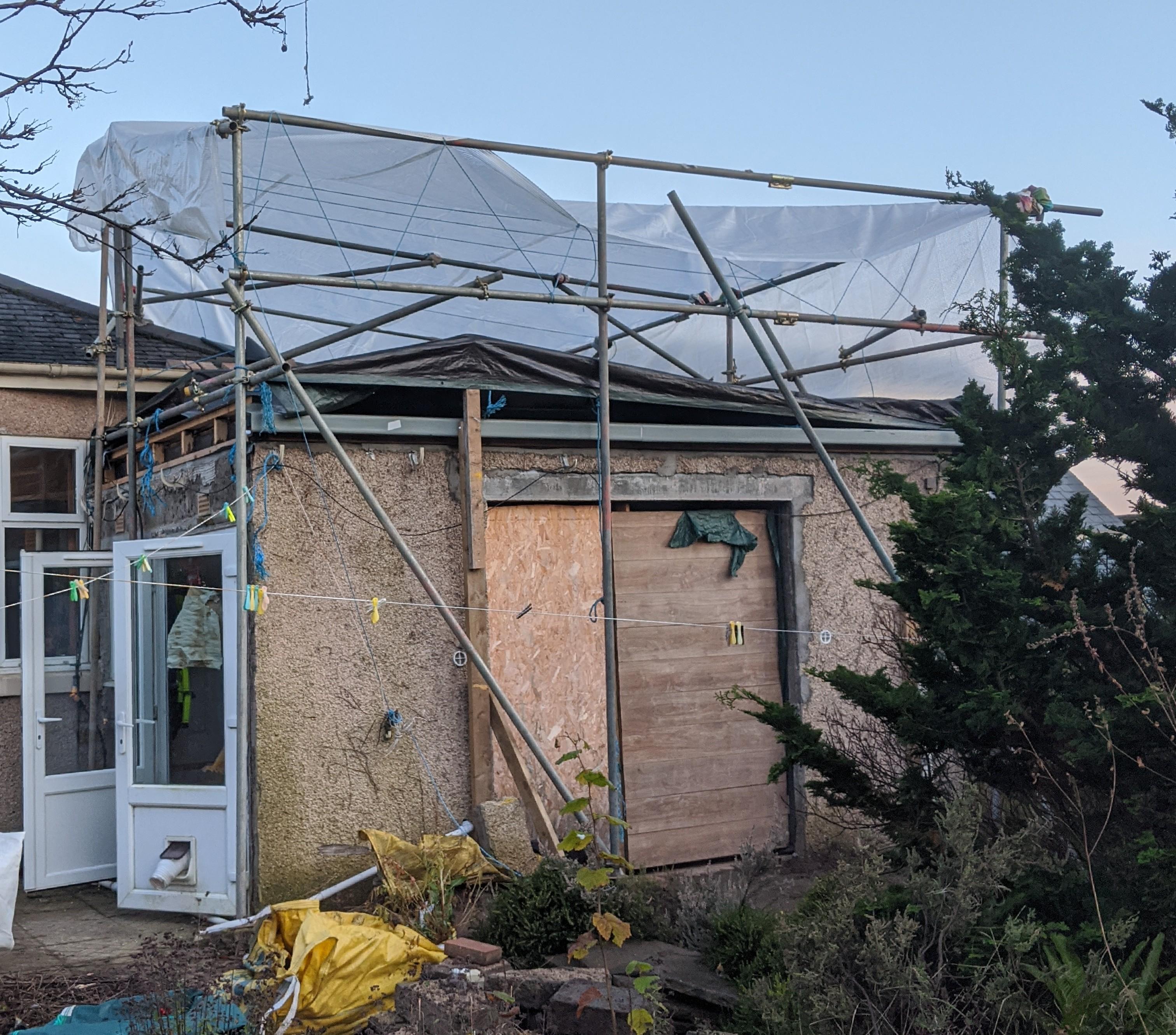

Well, it is up and the top on.
The scaff structure feels very sturdy (I ordered a bunch of spare lengths and we added diagonal braces as we went till it all felt rigid). Only took two lengths of scaff across the top (with braces to centre span) before the sides felt rock solid. So decided to leave most of the rest off and support the tarp with rope along the lines of @Cpd suggestion. That's holding well, will add more to make it more of a web but ran out of time today.
As per @Visti the cover is just sitting over it, tied off to the building rather than the scaff. Went with a big 8m x 10m sheet of clear mono cover tarp which appears to be much the same as the scaffold sheeting @Ed Davies recommended.
Foolishly ordered the long sides to have the fewest pieces, had an entertaining time trying to juggle a couple of 21' horizontals and freestanding legs before they were clamped together. With hindsight should have done that as 8' lengths with couplers and built it a bay at a time...
The wedge-joined-to-a-rectangle shape made it impossible to get the tarp totally taut as a single plane. So instead decided to tension it into natural sags that run downwards to the outside edges at front and back (like a poor man's butterfly roof) - had a bit of light rain today and it's run into the fold and out as expected. Still plenty of headroom under the droops to work.
So far very little wind and the forecast for the next fortnight is fairly calm and light rain so hopefully it will hold up ok. Now just need to get the old tarps off the roof itself, will use them to enclose the sides against driving rain / splash from the tarp "gutters".
As it's going to be pretty draughty up there my plan now is to borrow a couple of electric patio heaters to warm/dry the boards rather than trying to heat the surrounding air.

Posted
On 07/11/2019 at 09:12, andyscotland said:
might make a boat and sail over the ocean and far away to the land where GRP cures
So you have now made the sail, get the hang of the GRP and you are well on your way to making a boat.
Make sure it is warm enough to lay up the GRP.  You could use cobalt accelerator if it looks like the temperature is too low.  If very low, then amine accelerator (have used that for very quick repairs when about 0°C.

Posted
Cromar reckon out of the tin it's OK down to 5°C. Cold for that today (nowhere near @ProDave's -7 thankfully, though low of -4 tonight) but looks like it will warm up again later in the week.
If it's just under (say 3-4°C) towards the start/end of the day, I'm thinking that would be OK so long as the resin has been in the warm and I've a heat lamp gently warming the boards before I start / while it cures? Or is it crucial that the air temperature is also over the minimum?
Posted (edited)
It is a bit if a combination of things.
RH is really only a problem when very high, and in a hot place.
If you warm the boards, curing can start sooner on the first layer. But don't think that will be a problem.
What may be worth while is upping the catalyst a bit if the final layer is put down more that about 15 to 20 minutes after the first layers.
Trouble with having the resin warm and the boards cold is that it reduces the pit life of the resin.
Do a metre by metre square at a time until you get a feel for what is going on.
And don't do too much if there is a chance that it is not going to cure in about an hour and a half. Curing will not catch up the next day.

Posted
Wee update : tent is still up and weatherproof, have had 3 electric patio heaters on low continuously and a dehumidifier up there. It's not totally sealed at the corners/edges but I've closed up the worst of the drafts.
The temperature is consistently a good few degrees above outside air, the dehumidifier has cleared up the condensation/dew that was initially forming on the inside and then dripping back onto the boards. Now getting solid 5-6% readings from my electronic moisture meter. Did a couple of small sections of the GRP in lunch breaks last week, sanding and acetoning at the joins between each day's work and it's going down fine. Also much more efficient being able to leave all the tools and materials up there overnight rather than having to bring everything down and back up.
It dropped to 2° in there overnight while it was -5 outside, but otherwise has always been 5° or higher.
Good demo of the power of solar gain too : yesterday lunchtime it was 2° outside but so sunny that with the heaters off the boards and air were at 22°!
Bit of luck I'll finish the laminate this weekend, then going to sand and acetone the whole thing, put a thin coat of resin and then topcoat as I've read that can get a better bond if there's been a delay in getting the topcoat down.
So far seems like the bonkers plan is working!
