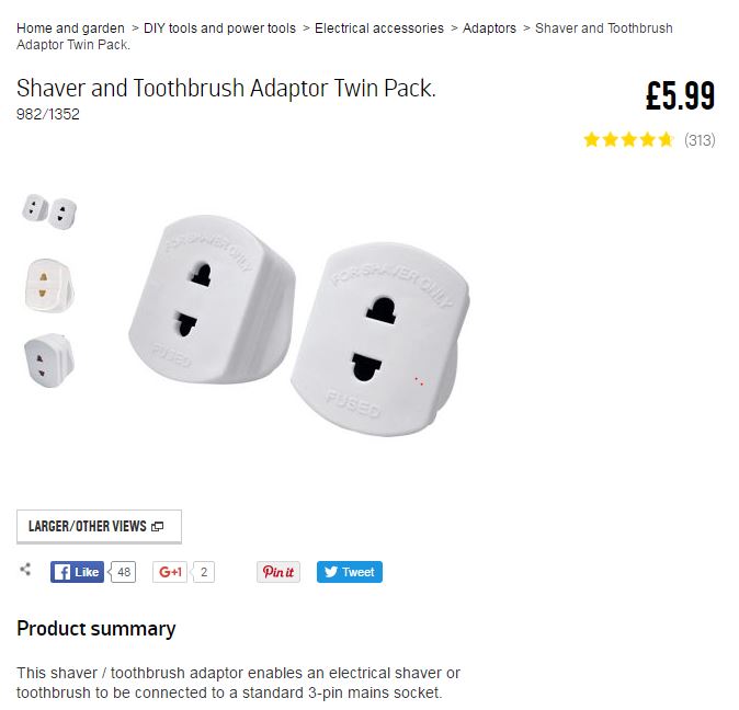

Onoff Posted October 19, 2016 Share Posted October 19, 2016 (edited) Long winded discussion about magnetizing currents, impedance, unloaded trannies and the negligible consumption therein or..... Case closed! Erm......case reopened......just realised she wants to charge in the bathroom. So.....just put the socket 3m away from the bath / shower. Edited October 19, 2016 by Onoff 1 Link to comment Share on other sites More sharing options...
