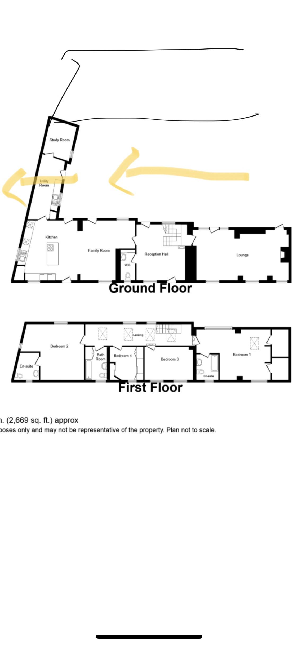

Benjseb Posted November 1, 2019 Share Posted November 1, 2019 We’ve discovered a slight problem.. We have a courtyard at the back of our property which is surrounded on 3 sides by our property and next doors. The top end is open (highest ground level) we have about 5 rainwater gulleys feeding into surface water drainage, plus some from next door. these then flow downhill towards our utility, under the utility and out the other side where they exit the wall as clay pipes and pour water onto a grass verge Except they don’t. I’ve rarely seen water exit these pipes. So got a CCTv survey. Told the drains under our utility have collapsed and need abandoning. So the surface water is sat under our utility. Obviously we need to address this. I’ve been told we can’t line the pipes as they have collapsed. is there a way of reinstating the drains under the utility (about 2.5m wide, external wall on both sides)? I’m trying to avoid digging up our utility inside but not sure if there’s any possibility of laying new pipes without doing this / can they be mole ploughed under a house if there’s access both sides? The only other option is to reverse the drains and run them up the courtyard against the natural fall of the land so it’s an awkward job and will require digging all the pipes up, raising the gulleys, etc. seeming like a huge job that’s possibly wear and tear so not covered by insurance Any tips? Ben Link to comment Share on other sites More sharing options...
ProDave Posted November 1, 2019 Share Posted November 1, 2019 Can you not re lay so the drains go around your study and out to the front alongside the study? Link to comment Share on other sites More sharing options...
Benjseb Posted November 1, 2019 Author Share Posted November 1, 2019 1 minute ago, ProDave said: Can you not re lay so the drains go around your study and out to the front alongside the study? the neighbours house is attached to our study unfortunately. So the only “free” place is on the far right of that diagram which is uphill or possibly at the top of that diagram which goes to next doors courtyard but not sure how happy they will be with our drains redirected through their property Link to comment Share on other sites More sharing options...
