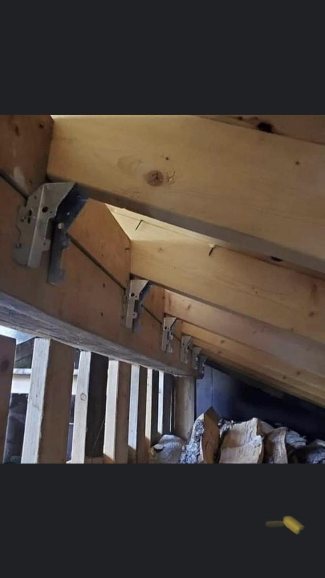

nod Posted November 1, 2019 Share Posted November 1, 2019 2 2 2 Link to comment Share on other sites More sharing options...
Moonshine Posted November 1, 2019 Share Posted November 1, 2019 Nice handy work @nod (i know its now yours). An actual question, even if they were flipped it would still not be a suitable install as it won't be flat on the hanger. Also are they actually needed at all as the timbers seem to be supported on that cross member absolutely fine, someone going a bit belt and braces? 1 Link to comment Share on other sites More sharing options...
Barney12 Posted November 1, 2019 Share Posted November 1, 2019 If that header is being boarded and plastered then I'd like to see the plasterers face when they arrive on the job Link to comment Share on other sites More sharing options...
ToughButterCup Posted November 1, 2019 Share Posted November 1, 2019 Oh to be a fly on the wall when a trades person tries that on with any BuildHubber .... And, just for fun, lets time how long it takes our @Russell griffiths to notice that the chippie missed the rafter - twice (at least) Link to comment Share on other sites More sharing options...
Temp Posted November 1, 2019 Share Posted November 1, 2019 Looks like two purlins one above the other? Are the joist hangers holding up the lower one or are the ends supported? Has the upper purlin been notched for the rafters or have the rafters been notched? Can't tell on my phone. Link to comment Share on other sites More sharing options...
Russell griffiths Posted November 1, 2019 Share Posted November 1, 2019 6 hours ago, AnonymousBosch said: Oh to be a fly on the wall when a trades person tries that on with any BuildHubber .... And, just for fun, lets time how long it takes our @Russell griffiths to notice that the chippie missed the rafter - twice (at least) I spotted it about 15mins after nod posted it you need to get up early in the morning @AnonymousBosch To get one past me. Link to comment Share on other sites More sharing options...
