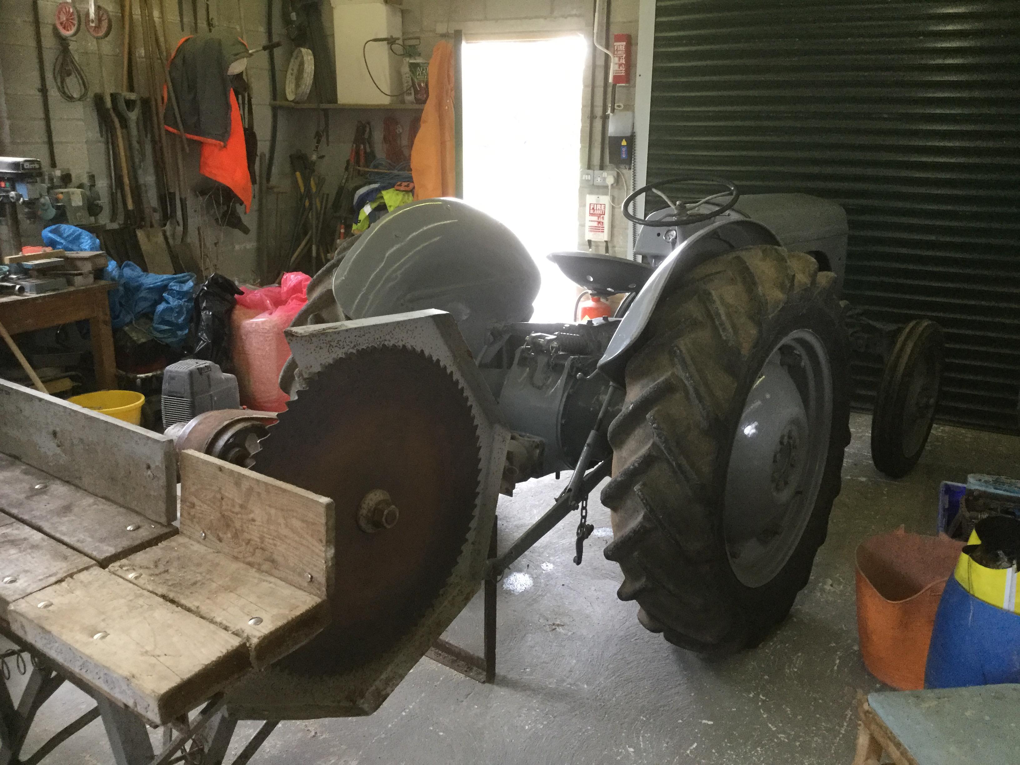

joe90 Posted October 27, 2019 Posted October 27, 2019 I think it’s all about stability when messing with a chainsaw, I like these. https://www.screwfix.com/p/roughneck-loggers-mate-24cm-log-capacity-log-saw-horse/76387?wcBtc=SB6&ds_kid=92700022855719897&gclsrc=aw.ds&ds_rl=1241687&ds_rl=1245250&ds_rl=1244066&gclid=Cj0KCQjwgNXtBRC6ARIsAIPP7Ru-t6JsSoMZcVQTybSsfFaFExlMq8sZcv4RiWifSHnDM8R3gnD1YdMaAnoEEALw Long bits of log are ok on a horse but difficult to deal with the short bits. I bought one of these instead to stick on the back of my furgy

ProDave Posted October 27, 2019 Posted October 27, 2019 27 minutes ago, joe90 said: I think it’s all about stability when messing with a chainsaw, I like these. https://www.screwfix.com/p/roughneck-loggers-mate-24cm-log-capacity-log-saw-horse/76387?wcBtc=SB6&ds_kid=92700022855719897&gclsrc=aw.ds&ds_rl=1241687&ds_rl=1245250&ds_rl=1244066&gclid=Cj0KCQjwgNXtBRC6ARIsAIPP7Ru-t6JsSoMZcVQTybSsfFaFExlMq8sZcv4RiWifSHnDM8R3gnD1YdMaAnoEEALw I like the look of that. It looks like you can clamp a log right at the end then go along sawing off slices of the right size to then be split for the fire. I built a traditional saw horse at the last house (but made it a built in feature of the wood shed under a verandah so it stayed there) and while it worked well to hold the logs you were lucky to get 2 slices before you had to move the log, making it very tedious keep putting the saw down * to move the log along, and really made it a 2 person job, one to keep moving the logs and one to saw. * My chain saw has never been good at idling and even though it appears to idle at the right speed, will often just stop for no reason, so often when putting it down to move a log you then had to re start it. I would love a Fergie with a saw bench like that but I think the Landrover would have to go if I bought one.

H F Posted October 27, 2019 Author Posted October 27, 2019 1 hour ago, joe90 said: bought one of these instead to stick on the back of my furgy that is awesome!

joe90 Posted October 27, 2019 Posted October 27, 2019 1 hour ago, ProDave said: would love a Fergie with a saw bench like that but I think the Landrover would have to go if I bought one. Dave, Can’t you invent a PTO to fit the land rover ?, I have a spare furgy for sale but your a bit far away!. This is might be good, chainsaw and and fixed bench in one. https://www.ebay.co.uk/i/372485192387?chn=ps&norover=1&mkevt=1&mkrid=710-134428-41853-0&mkcid=2&itemid=372485192387&targetid=487744081563&device=t&mktype=pla&googleloc=9045292&poi=&campaignid=1506023755&mkgroupid=63481328372&rlsatarget=pla-487744081563&abcId=1139576&merchantid=115139766&gclid=Cj0KCQjwgNXtBRC6ARIsAIPP7RuMjY0YQWw976BFAEpW-x6yhQFNXbktX50XQmL7gG2IKEOX7HIrZNEaAnQ2EALw_wcB
