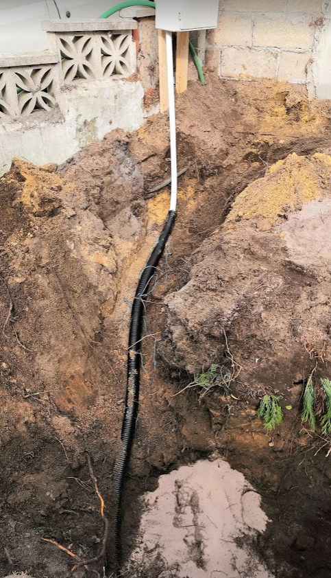

Adam2 Posted October 26, 2019 Share Posted October 26, 2019 As above, if demolishing and if meter inside or outside and will be moved then you need the DNO to relocate supply. Just had mine done (SSE). I did my own trench + duct to new location + put up a kiosk for the supply + meter + consumer unit. SSE (DNO part) did the connection into the new kiosk. The original cable was in what looked like lead protection and apparently if you cut into that you can quite easily short it. SSE charge was £411 (for 8m relocation) didn't ask their price to trench but imagine that would have been a lot more as has some unknowns and needs more equipment (guessing they won't hand dig). The meter was moved also by SSE as I happen to have them as my billing company FOC. Through some pain on the phone you can get them to come one after the other on same day - lead time was about 3 weeks from the survey by the DNO part. My electrician then connected into the meter + added some sockets into another kiosk I installed alongside - probably 2 hours for him. If you move it then you'll need to buy the hockey stick and maybe some duct - though may be able to not use it (not sure on rules there so OI got some as the survey mentioned it). In the pic the pile of sand at the bottom was put on after the resin was applied on the connection by the DNO before we back-filled and put in place the plastic tape to try and save someone digging through the cable. My helpful neighbour has a digger at the moment so made light work of the trench digging! Link to comment Share on other sites More sharing options...
