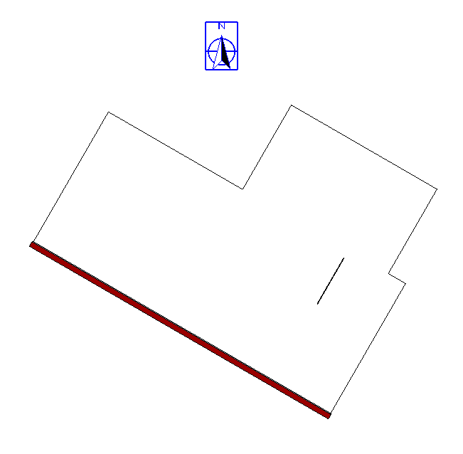

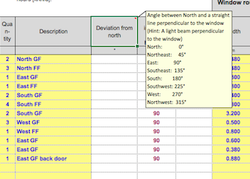

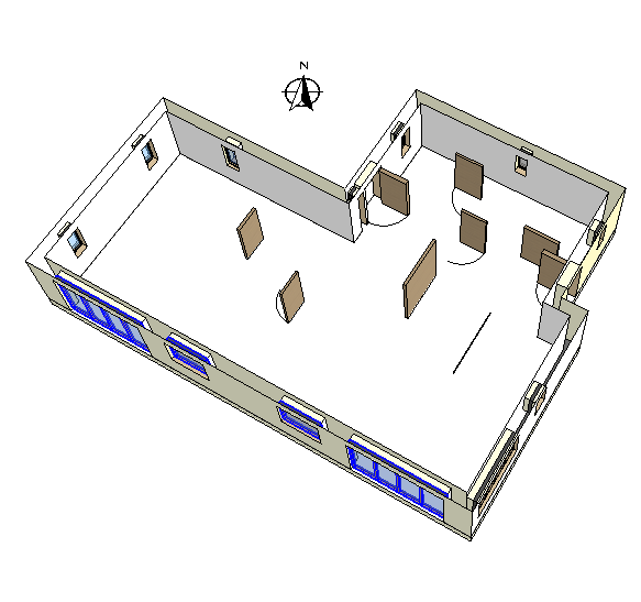

Russdl Posted June 27, 2017 Author Posted June 27, 2017 Many thanks so far. Perhaps I should have added a bit more clarity and detail. Once again, this is the same floor plan (with walls and windows now visible), it's the windows highlighted in blue that I'm after the 'DEVIATION FROM NORTH' for. The second image is a 'help' screen from the PHPP package explaining how to work it out.
Ferdinand Posted June 27, 2017 Posted June 27, 2017 Are you sure one of you isn't talking about the face of the wall angle and the other the light direction? Add. Reading your last post I make the light beam perp to the window as about 7:00 on a clock, which is ... umm ... umm ... 210 degrees. F
Russdl Posted June 27, 2017 Author Posted June 27, 2017 Thanks again, I shouldn't have been so vague in my first post but I was trying not to lead the jury.
PeterW Posted June 27, 2017 Posted June 27, 2017 Yep that makes three of us ..!! 210 degrees based on that description

Russdl Posted June 28, 2017 Author Posted June 28, 2017 Thanks for the all the replies. I had a figure of 210 degrees (ballpark'd in exactly the same way as Ferdinand) On 27/06/2017 at 09:22, Ferdinand said: light beam perp to the window as about 7:00 on a clock, which is ... umm ... umm ... 210 degrees. The figure the consultant has come up with is 60 degrees out and, of course, all the other elevations differ by the same amount compared to what I expected. I explained to the consultant what I considered to be his error, including copying the 'help' menu from the PHPP (leaving plenty of wriggle room for him to 'cough' to the mistake) but he insisted he was correct and that the measurement should be taken from the window perpendicular, clockwise to north, which of course would be 150 degrees... I won't be using him - I need the book! On the thread creep regarding certification, I'm still undecided if I will or not. I want to use the PHPP to ensure that my new build doesn't overheat as that seems to be the biggest problem for a passive house, so the more I can do to design that risk out the better, hence my desire to use PHPP.
