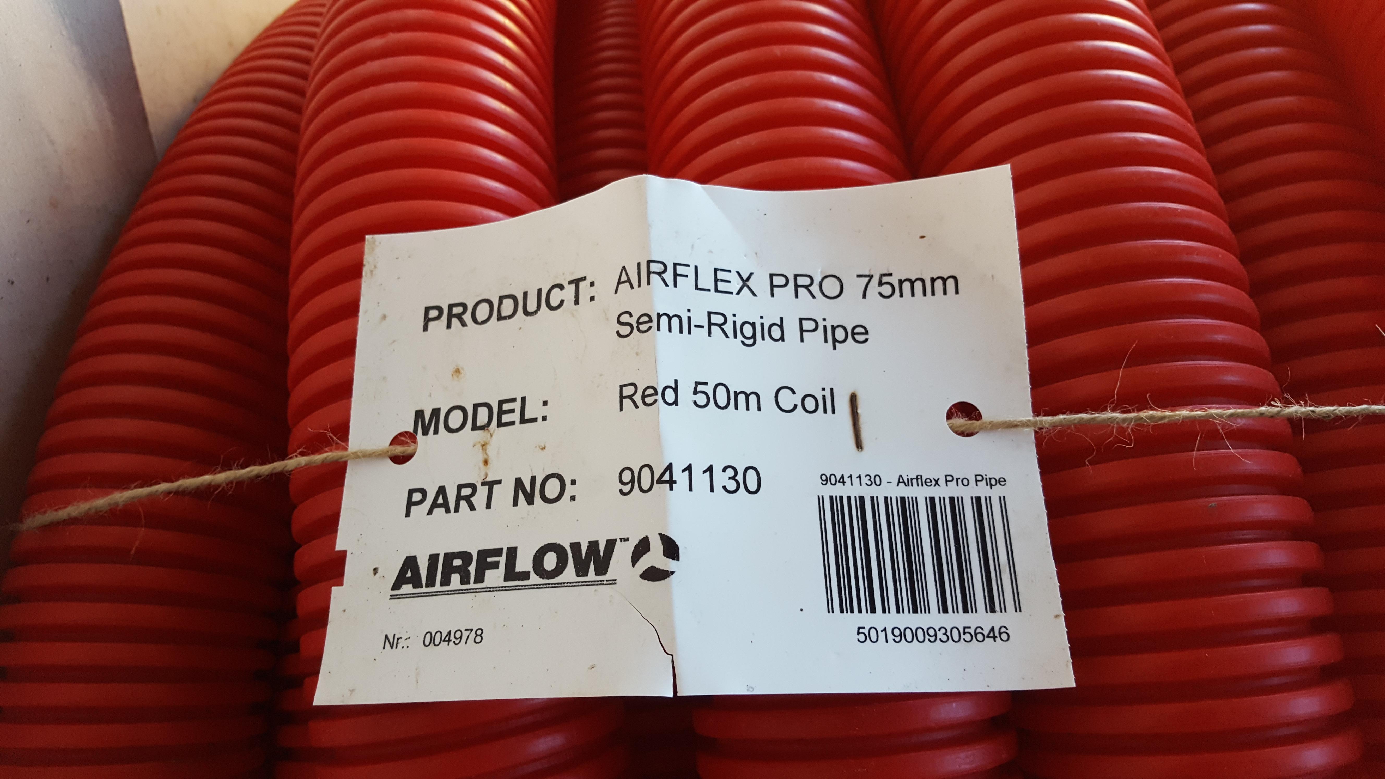

If you want an Airflow offcut message me your address and I'll send a piece over. I've also got a spare 50m roll (or nearly 50m - not sure if I used any) which I need to move on at some point too.

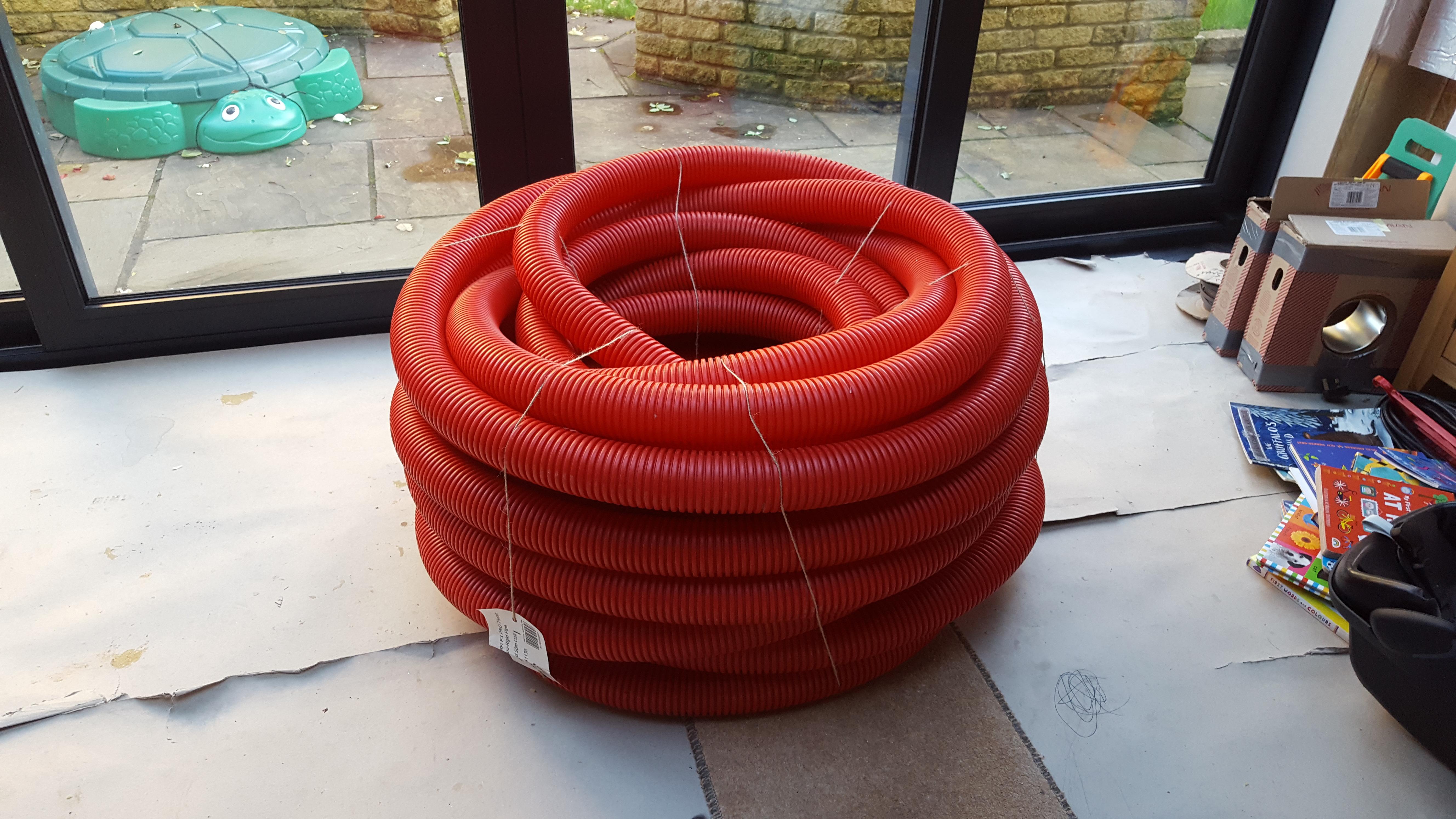

Between my brother and I we massively over-ordered (due mainly to a change in approach for both jobs midway!) and so I've already shipped a couple of rolls. It was only £12(?) via Parcelforce48 although they were right on the limit for dimensions and so crossed my fingers on both occasions that I wouldn't be pulled up on it! This roll has been opened though so might not go quite as small as when first delivered, but then it might be slightly short.
I'll sort out some photos this weekend as I've been meaning to do something about it for a while.

Posted
I did! ish...
The ducting is the full 50m and still has the end caps in place, however there are a some scuffs and scrapes and it's picked up some dust/dirt on the outside in places where the wind has blown through. The biggest concern though is that I think I may have misunderstood Parcelforce's dimension limits as the 3m limit is for length+girth combined whereas I must've previusouly assumed it was just the girth (with length having its own 1.5m limit)! The coil is roughly 1m in diameter and 53cm high hence why I thought the 1+1+.53+.53=3.06m was pushing it. Perhaps they don't mind too much if it's still able to be handled (it's a one-man lift at around 17kg) and they've taken two previously without issue.
Given its condition and being more keen for space than excess ducting I'd be happy to offer it at half-price (so, £80 + £12.99 postage) if it's of interest otherwise I might just stick it on eBay as collection only the that avoids the risk of Parcelforce demanding excess fees if they decide it is over limit with this one!
