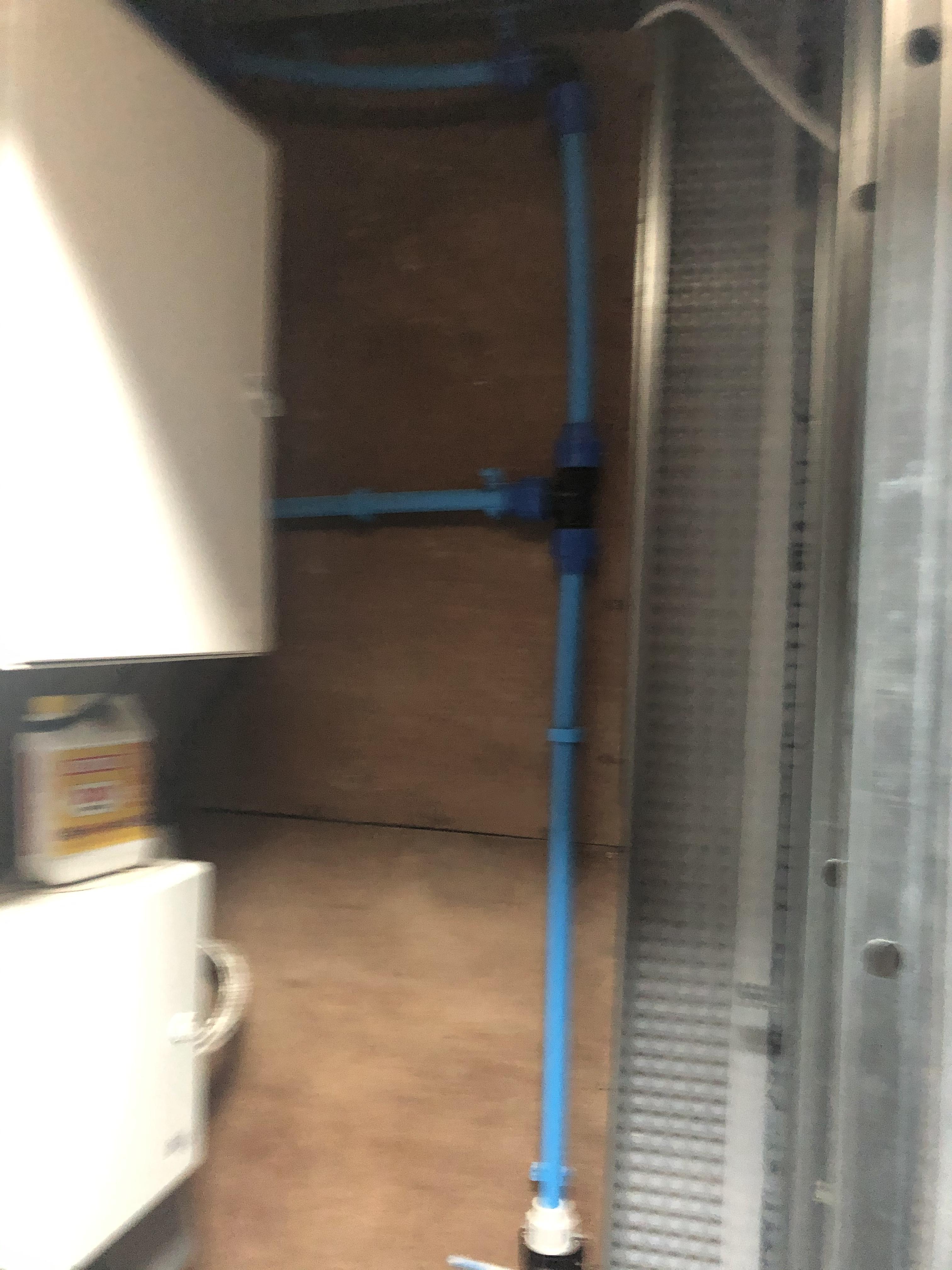

Pocster Posted October 23, 2019 Posted October 23, 2019 (edited) Having one of those days . Me and mdpe have a bad relationship- some fittings no probs others I start swearing as they leak . Harder I try colder and wetter my hands get lessen the chance of success . Then you can’t undo a fixing ; so you undo at the other end . Then when you put back other end leaks - more swearing . Hands numbing from cold water in dungeon . I put the gun down ( do I shoot me or hunt down the mdpe inventor ) . “Speedfit fixings” think I might have a court case there for misleading title . I know the pipe has to be straight to go in the fitting snug but (expletive deleted) me ! I lie it on a flat bit of timber - yes it bends maybe 1mm - still leaks . More swearing . Then the suicidal voice says “ F this ; go for a jog “ I hate mdpe - I hate it . It’s not ‘flexible pipe’ , a fitting that hasn’t ever leaked decides it wants to today . Push fit to brass - give me strength ! STOP LEAKING ! I’ll stop otherwise it will be the call to the Samaritans . Edited October 23, 2019 by pocster

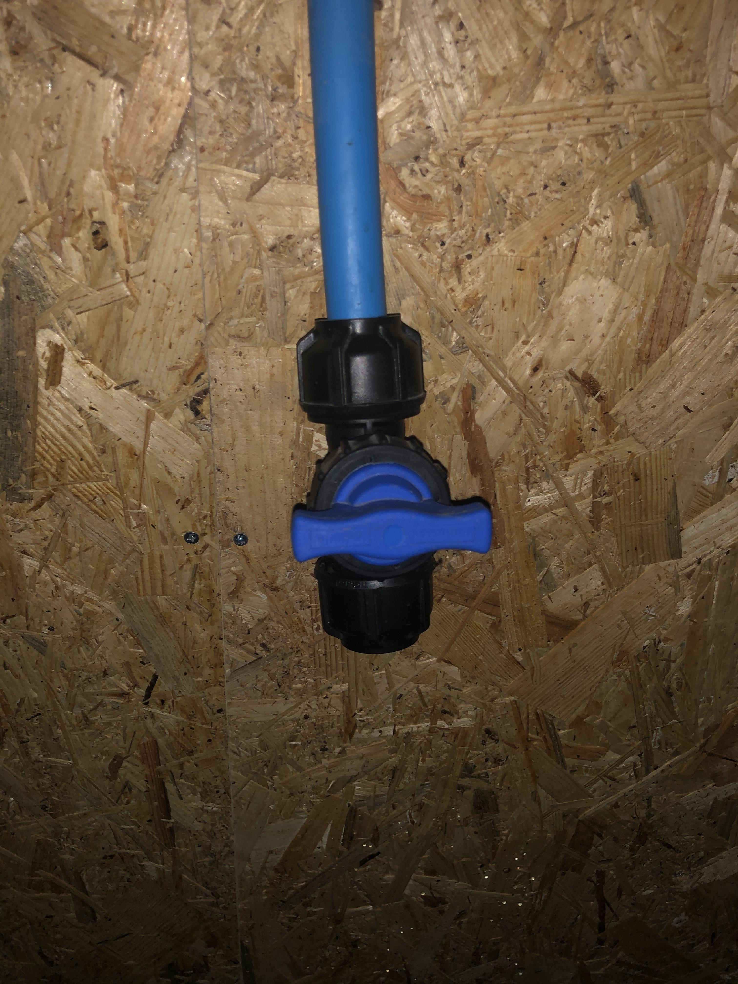

Pocster Posted October 23, 2019 Author Posted October 23, 2019 This is the worse offender . All my 90 degree fittings are plasson . You get that satisfying click when the pipe is fully in . Not with this crap tap and it wasn’t cheap . You can put the pipe in , no click , force it as hard as you can and it’s still loose and can almost fall out . I won’t swear in type I’ll just vent it out here on my own !
Pocster Posted October 23, 2019 Author Posted October 23, 2019 (edited) Tempted to rip all the mdpe out and just have 1 mdpe to Hep2o converter .... They exist I assume ! Edited October 23, 2019 by pocster
Pocster Posted October 23, 2019 Author Posted October 23, 2019 Right ! Decided ! Rip this out and re do with Hep2o . I think the mdpe is 25mm

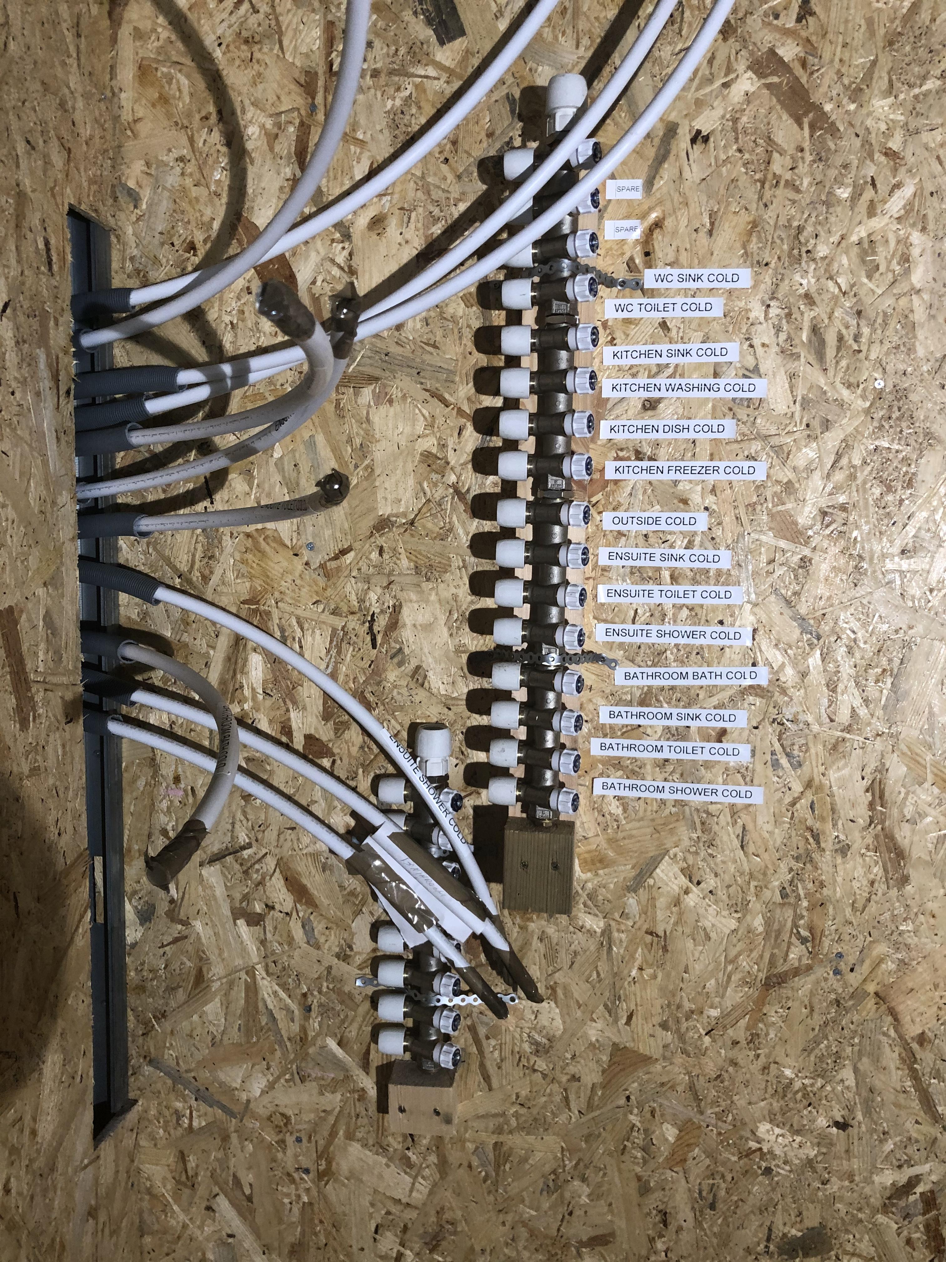

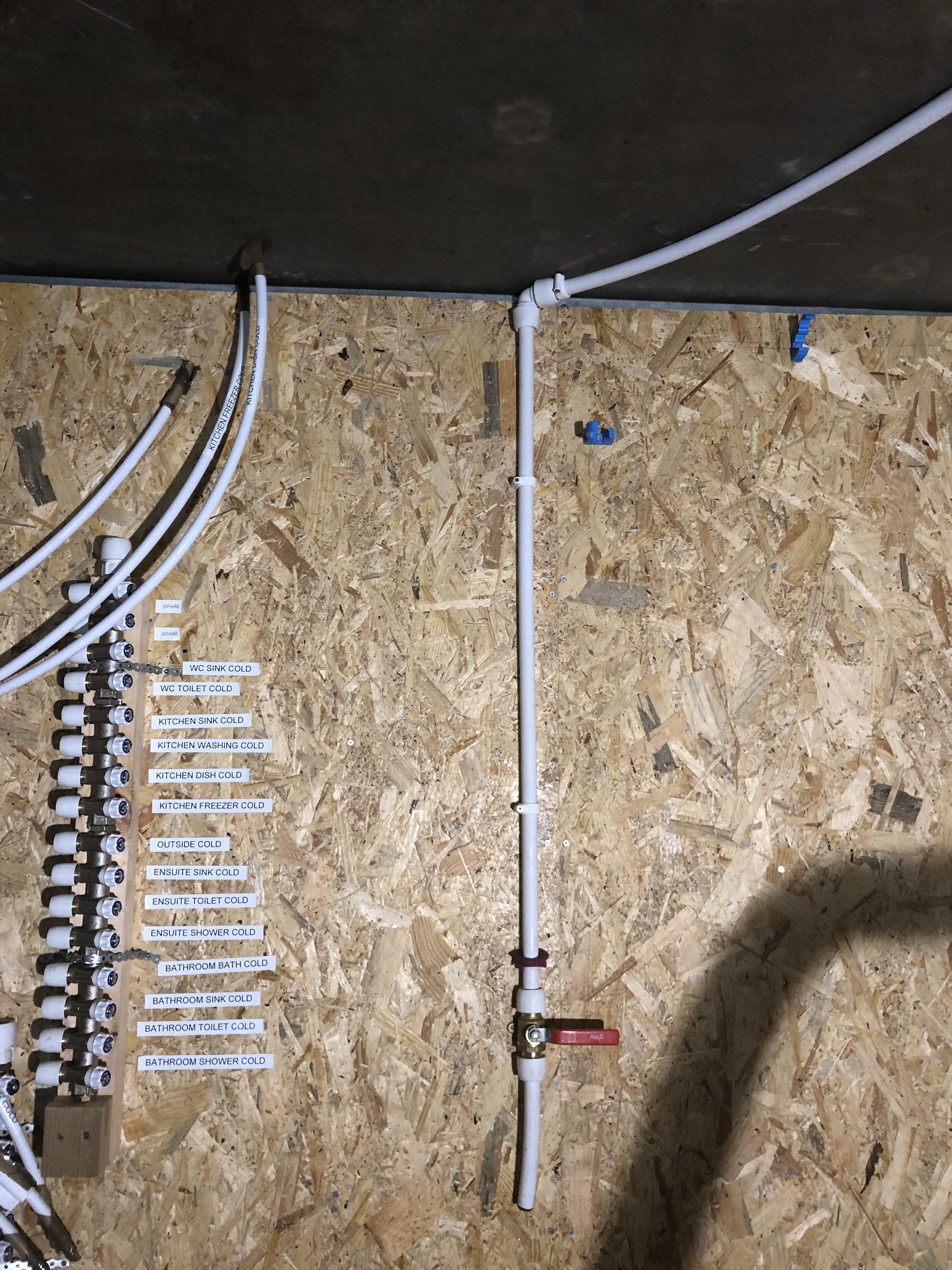

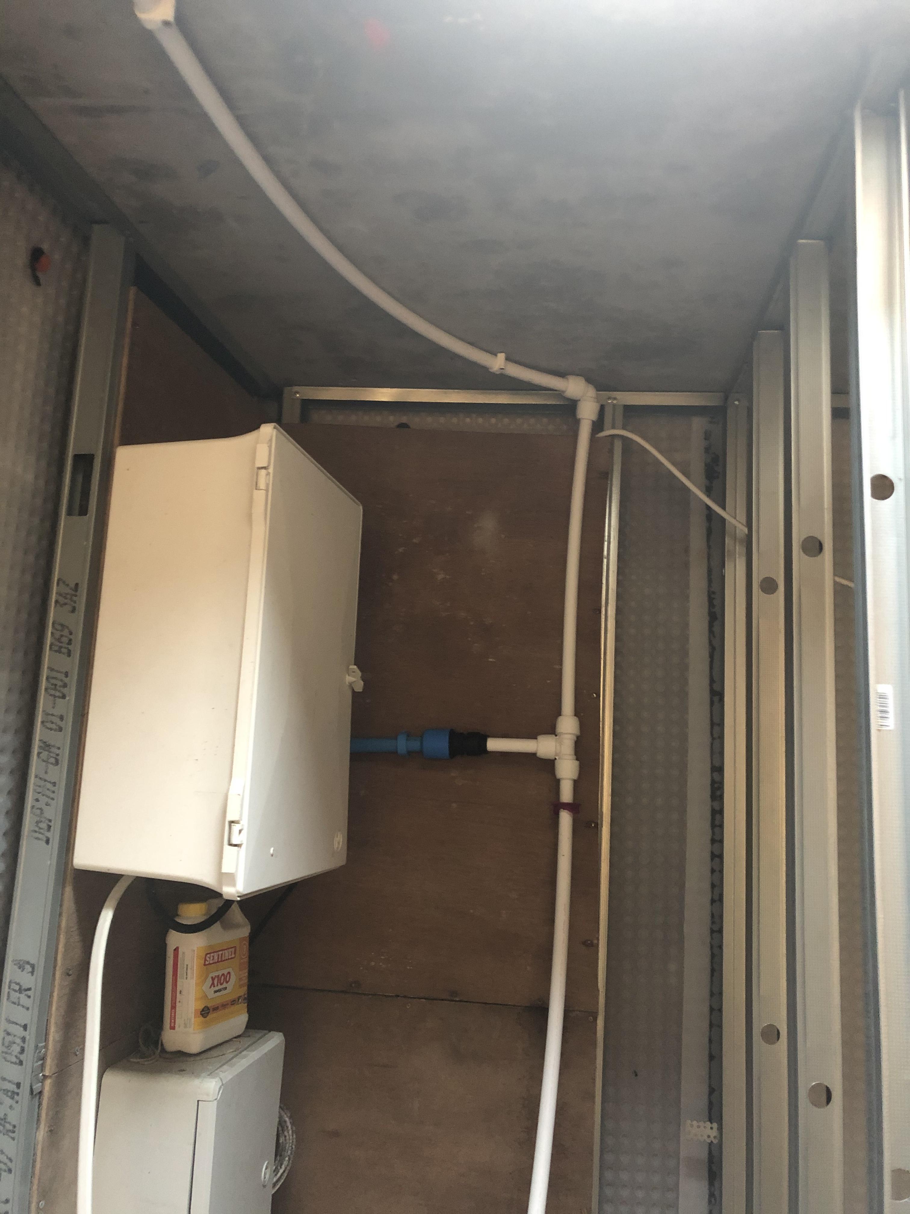

Pocster Posted November 1, 2019 Author Posted November 1, 2019 (edited) So ! I replaced mdpe with Hep2o. So as Hep2o is a lot more forgiving on bends I now have just 2 tee’s where it crosses the ceiling . These joints will always be exposed so can always get to them . Hep2o much easier to work with; only issues I experienced. Once the pipe inserts are in they are in unlike mdpe ones you can remove . Not an issue though . Hep2o 22mm more difficult to dismount - but then the key isn’t like the 15mm or perhaps it’s just me . Hep2o fittings that go Hep2o to plastic thread ( say for a tap ) leak no matter how much plumbers tape and washers I use ( hence why tap is upside down to reduce leak ! ) . Will change this to a brass wall plate I think . Tested manifolds off the main tap - leak free now . Edited November 1, 2019 by pocster 1

epsilonGreedy Posted November 1, 2019 Posted November 1, 2019 (edited) On 23/10/2019 at 13:28, pocster said: This is the worse offender . All my 90 degree fittings are plasson . You get that satisfying click when the pipe is fully in . Not with this crap tap and it wasn’t cheap . You can put the pipe in , no click , force it as hard as you can and it’s still loose and can almost fall out . I won’t swear in type I’ll just vent it out here on my own ! That looks like a Philmac stopcock. This brand has caused me similar anguish and like you I found the loose fit a problem, maybe Philmacs are only suitable for mutant plumbers with 4 arms. As it happens I have yet another slow leak in my shed at a Philmac connector and find Philmac connection collars have to be cranked down to the thread endstop before they stop leaking. A plumbing trade old-hand explained they were originally designed to accommodate two common pipe sizes in use decades ago. I suspect that original USP has become a liability today. Edited November 1, 2019 by epsilonGreedy 1
