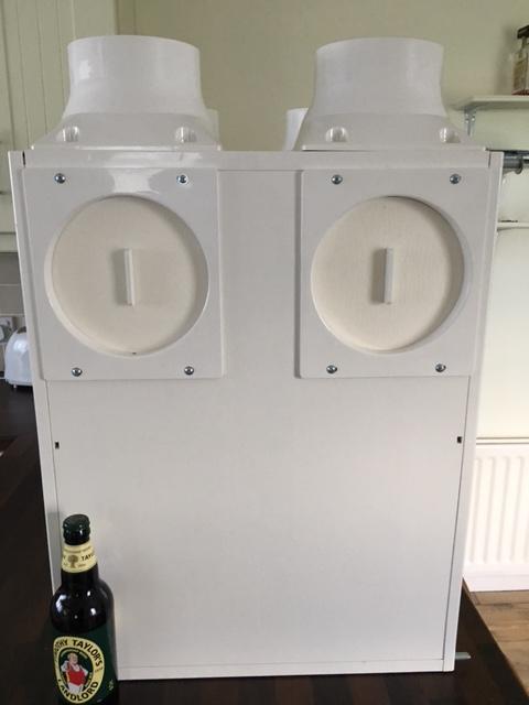

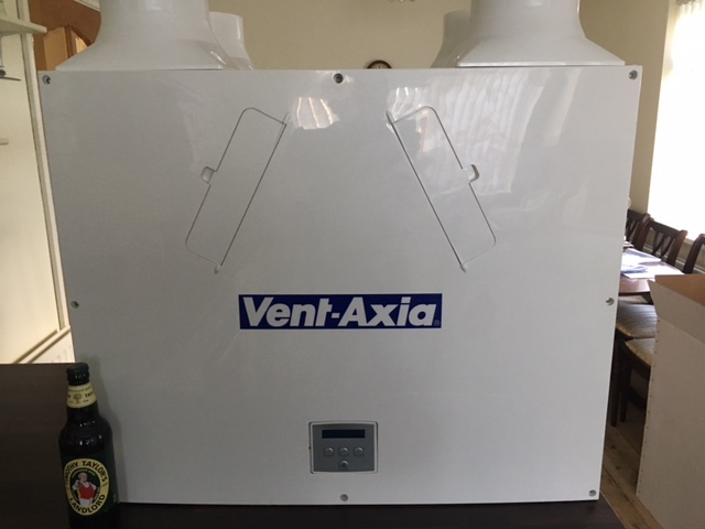

Guest Alphonsox Posted October 16, 2016 Share Posted October 16, 2016 I have spent a couple of hours today wrestling with another new purchase. This is a Vent-Axia Sentinel Kinetic Plus MVHR unit. This was sourced along with all the other MVHR ducts, vents etc from BPC Ventilation @bpc ventilation (highly recommended). I thought a few pics might be useful to give an impression of the size of the unit - It is big and bulky but not particularly heavy, an easy two person lift. It seems reasonably quite when powered up despite not have any ducting attached to provide acoustic attenuation, although this is at zero load. Link to comment Share on other sites More sharing options...
ProDave Posted October 16, 2016 Share Posted October 16, 2016 I see a bottle of beer is now the standard forum yard stick to show somethings size. Link to comment Share on other sites More sharing options...

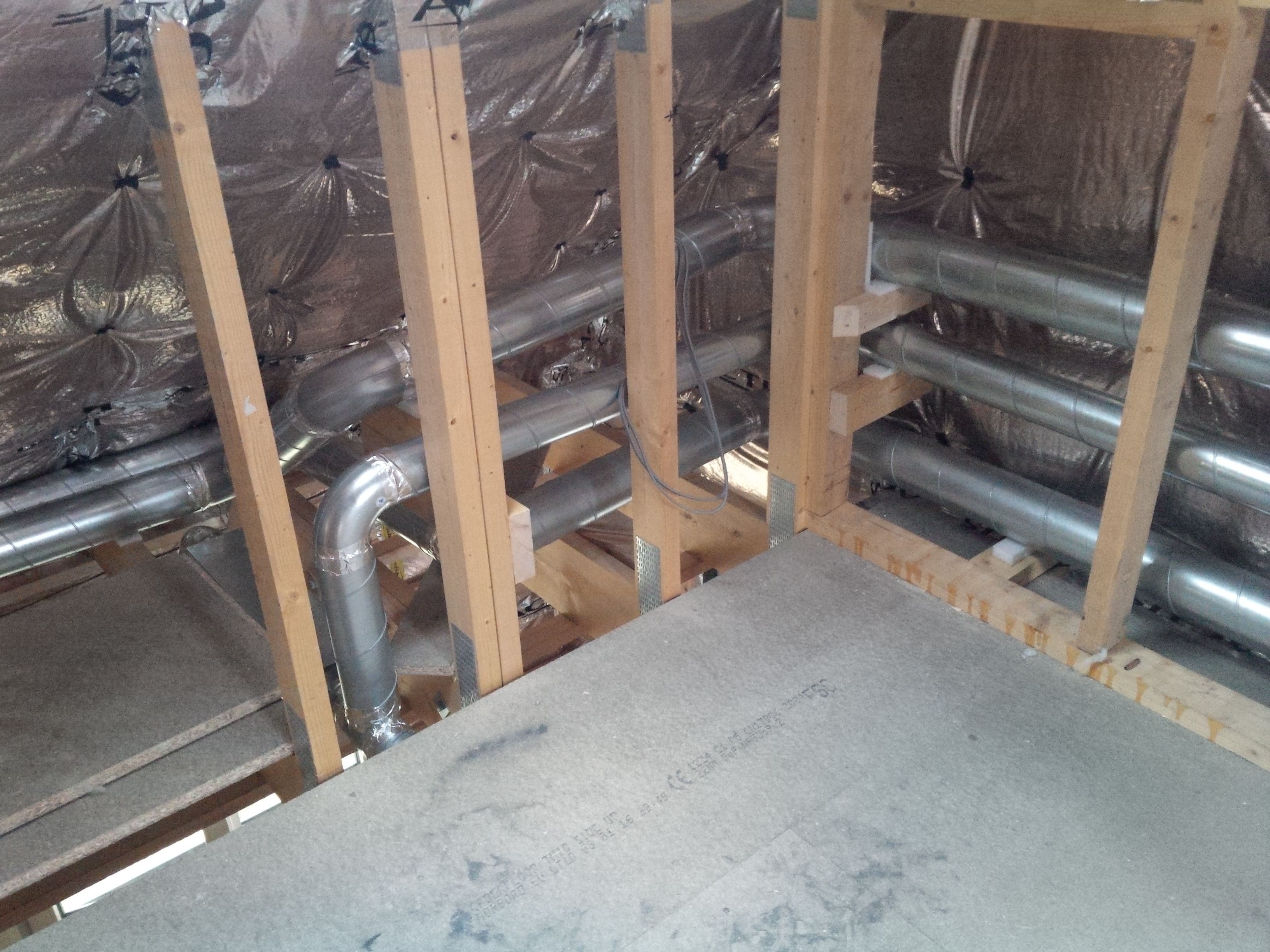

NSS Posted October 16, 2016 Share Posted October 16, 2016 Sorry, no bottle in view, but coincidentally we've just offered up our MVHR unit to check clearances for the ducting which, as you can see, is of the rigid variety. Link to comment Share on other sites More sharing options...

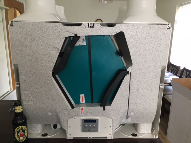

Declan52 Posted October 16, 2016 Share Posted October 16, 2016 Same unit as mine. Watch the screws on the front as they are poison to line up. Took mine apart yesterday to clean the heat exchanger and filters. Wasnt that bad considering I live in the countryside. If you hold in the * it goes into purge mode and goes at 100% and even then it's quiet. Link to comment Share on other sites More sharing options...
Guest Alphonsox Posted October 16, 2016 Share Posted October 16, 2016 How do you go about cleaning the heat exchanger ? Blast with an air gun or soapy water ? Link to comment Share on other sites More sharing options...
Declan52 Posted October 16, 2016 Share Posted October 16, 2016 Took into the bath and run soapy water through it then let it sit to dry out then stuck the wife's hair dryer on it too give it a good dry. Link to comment Share on other sites More sharing options...
