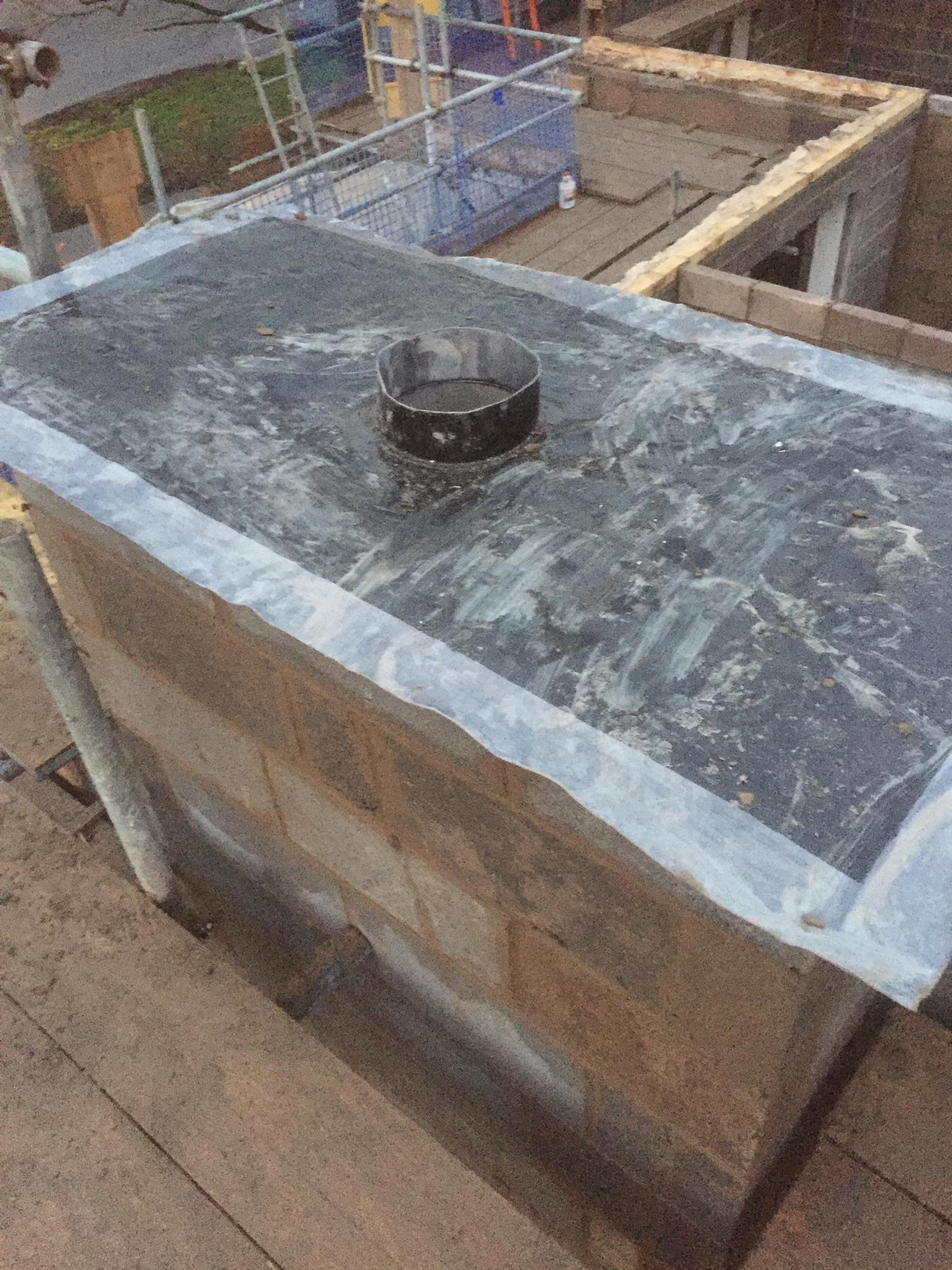

nod Posted October 19, 2019 Posted October 19, 2019 I needed a lead saddle and a tray for the top of the chimney with a 200 mil upstand I found a chap in Cornwall who made and braised these to order and posted them out to me For not a lot more than what it would have cost me to buy the lead 1
