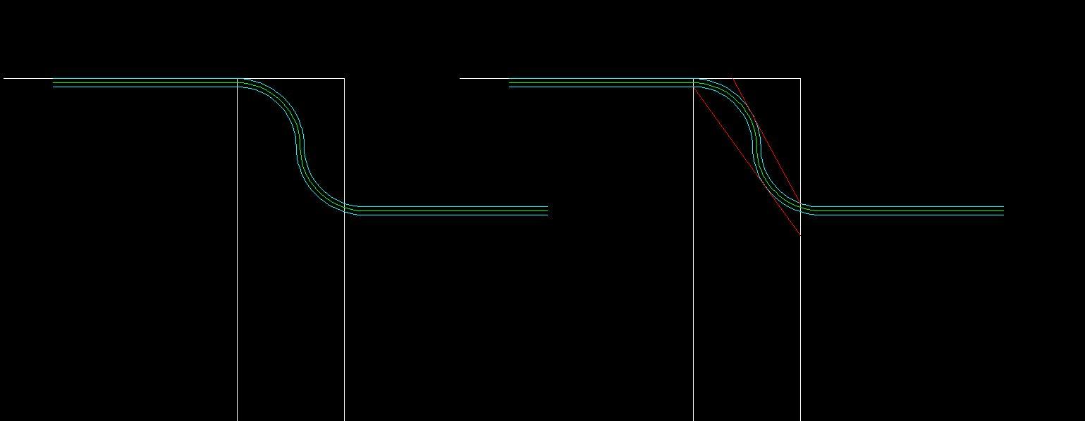

Pocster Posted October 14, 2019 Posted October 14, 2019 Ok . Got some 15mm Hep2o tested its ‘bendability ‘ - kinks quite easy . I need to get it through a 200mm solid wall - bend to run up it the bend at the ceiling . I see these ‘cold formers’ would that do what I need ? ( 1 at each bend ) . Desperately trying to avoid any joints . Plan was maybe to drill a 20mm hole through wall so 15mm Hep2o has wiggle room . Perhaps that former goes half in the wall ??
Onoff Posted October 14, 2019 Posted October 14, 2019 120mm radius: tgl-coshh-tech-hep20-performance.pdf 1
Jeremy Harris Posted October 14, 2019 Posted October 14, 2019 Can you angle the hole through the wall to reduce the angle of the bends? 1
Barney12 Posted October 14, 2019 Posted October 14, 2019 As Jeremy says, try and create the hole at an angle. The Cold form bends do work very well at creating a reasonably tight radius without kinking. I'd also be putting a sleeve (or wrap in wadding) where it passes through the block work but I've seen plenty of "professional" [cough] installs where they don't bother. 1

Pocster Posted October 14, 2019 Author Posted October 14, 2019 29 minutes ago, JSHarris said: Can you angle the hole through the wall to reduce the angle of the bends? Yeah I guess so . Still a tight turn at the ceiling - but a good point !
Pocster Posted October 14, 2019 Author Posted October 14, 2019 25 minutes ago, Barney12 said: As Jeremy says, try and create the hole at an angle. The Cold form bends do work very well at creating a reasonably tight radius without kinking. I'd also be putting a sleeve (or wrap in wadding) where it passes through the block work but I've seen plenty of "professional" [cough] installs where they don't bother. Yeah - that’s why I was making the hole larger so perhaps I can put some kind of sleeve around it .
joe90 Posted October 14, 2019 Posted October 14, 2019 How far from hole to ceiling. Can you not drill at ceiling height?
Jeremy Harris Posted October 14, 2019 Posted October 14, 2019 20mm flexible electrical conduit has a bore of about 16mm, and is pretty much ideal for protecting 15mm pipe where it goes through walls. Likewise, 32mm flexible electrical conduit is sort of OK for 22mm pipe (it has a bore of about 25mm, so the pipe's a bit of a sloppy fit). 1

AdamSee Posted October 14, 2019 Posted October 14, 2019 The speedfit cold form that Toolstation sell (but keep limited stock of) is the same as the Hep2o ones, I've used a lot of them rather than putting in joins everwhere and its been just fine. When passing it through a wall its best to use a bit of conduit as to not score it. I've found a dishwasher waste pipe to be the perfect size for the job and comes in handy lengths rather than having to buying 25m of the dam stuff. 1 1
Pocster Posted October 14, 2019 Author Posted October 14, 2019 (edited) 15 minutes ago, AdamSee said: The speedfit cold form that Toolstation sell (but keep limited stock of) is the same as the Hep2o ones, I've used a lot of them rather than putting in joins everwhere and its been just fine. When passing it through a wall its best to use a bit of conduit as to not score it. I've found a dishwasher waste pipe to be the perfect size for the job and comes in handy lengths rather than having to buying 25m of the dam stuff. What’s the diameter of a dishwasher waste pipe ? . Just bought a 25mm drill bit - so if it fits in that ( and Hep2o in dishwasher pipe ) then perfect ! Edited October 14, 2019 by pocster

Jeremy Harris Posted October 14, 2019 Posted October 14, 2019 40 minutes ago, pocster said: Googling seems to range from 16mm to 20mm . If that’s correct would be good ! I don't know, but flexible plastic 20mm electrical conduit has an ID of 16mm and is pretty cheap: https://www.screwfix.com/p/tower-corrugated-conduit-black-20mm-x-10m/50443 £5.29 for 10m is pretty reasonable, even if you end up throwing some away. 1
