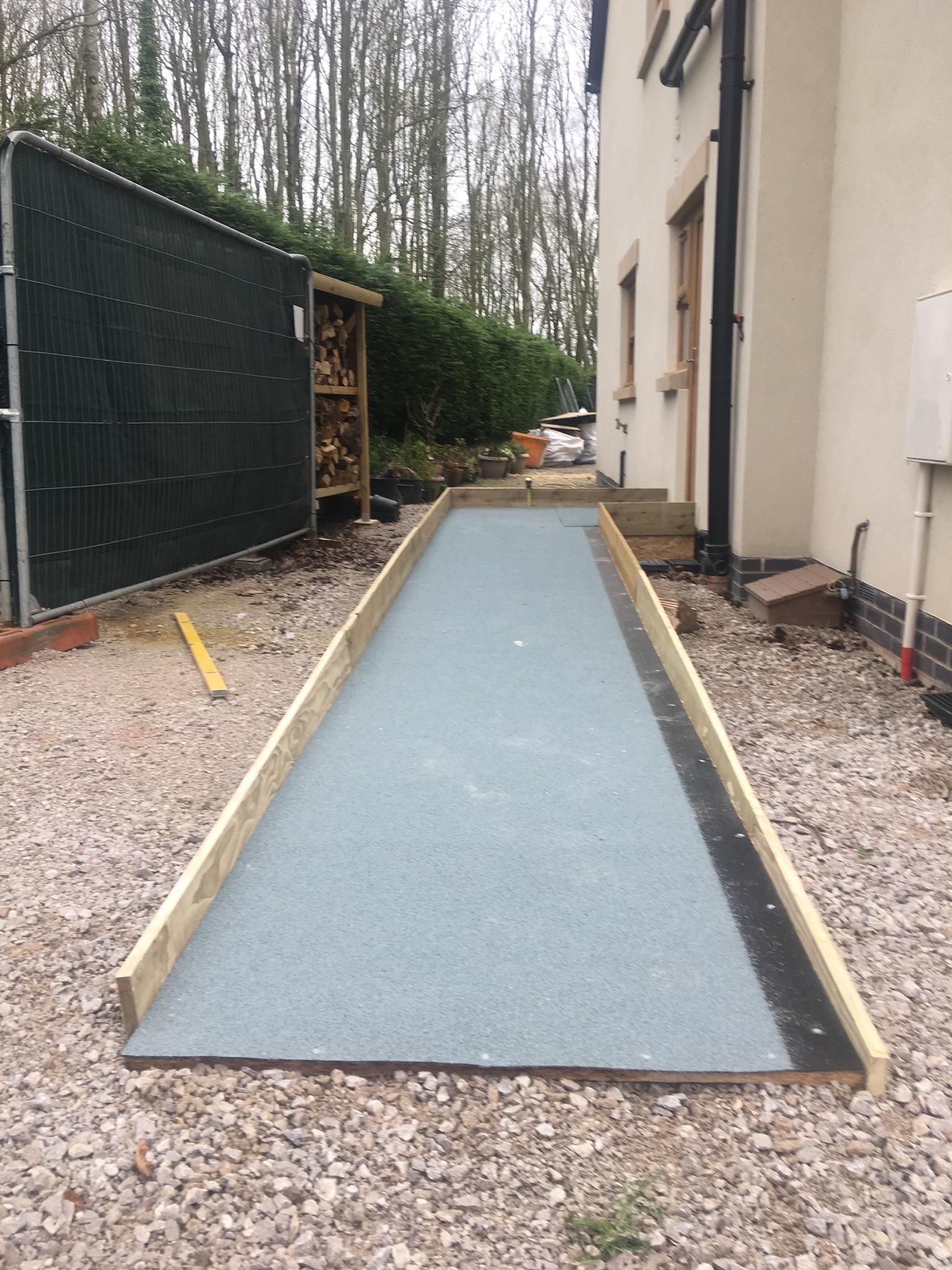

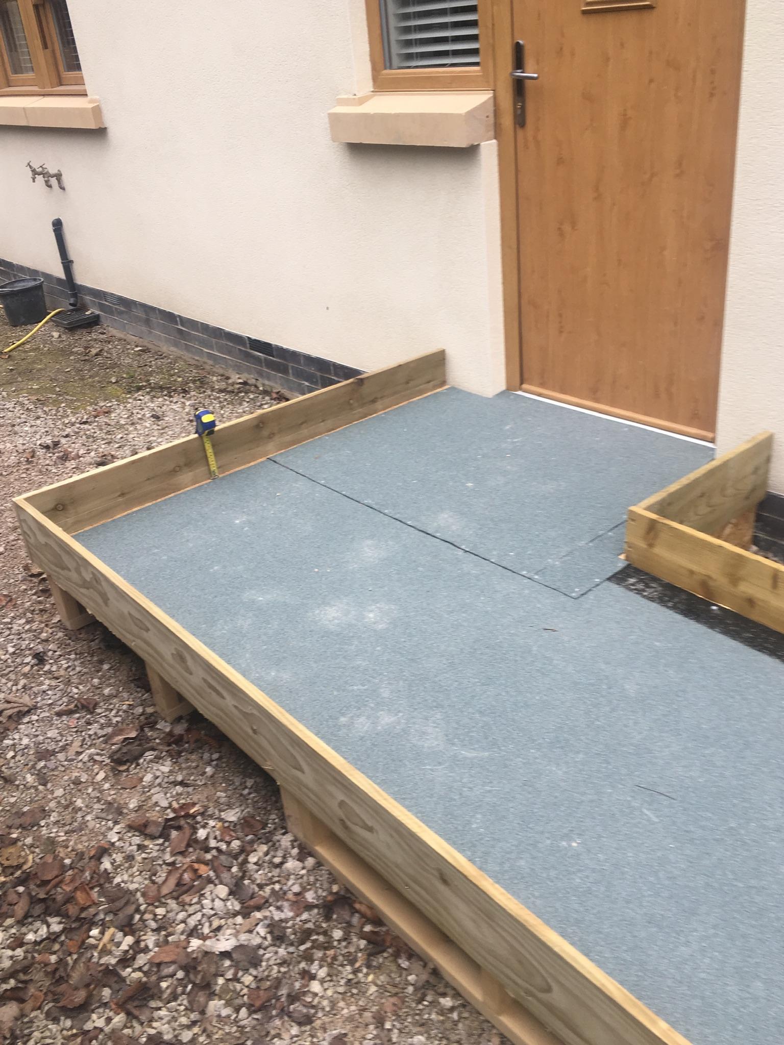

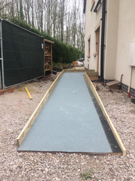

Jeremy Harris Posted October 11, 2019 Posted October 11, 2019 The key thing I found was the "unless it is impracticable to do so" clause, plus the fact that the Approved Documents are not actually the regulations, and the regulations allow for a fairly broad range of means of compliance, not just those in the Approved Documents.  I opted to run a gently sloped, paved, ramp from the end of our drive around to the back door, with a large flat turning area immediately outside the back door. The back door opens to our utility room, and the WC leads off that. As I've a paraplegic, wheelchair using, friend, who regularly visits, I was more interested in getting his opinion than that of anyone else. One thing he mentioned was that the flat area outside a door needs to be larger than that stipulated in Part M, as even his very narrow and small titanium chariot needs more space to be able to turn and for him to be able to operate the door handle (bearing in mind that he cannot lean forward in the chair, so has to do this side on, then turn his chair around).  Building control were absolutely fine with us having steps up to the front door, and the Part M compliant access ramp to the back door. Apart from anything else, the length of ramp needed to comply with the maximum allowable gradient, together with the EA stipulated finished height for the car parking area and the house finished floor height, meant that including a ramp to the front door would have meant to loss of most of the car parking space.  I think there's sometimes a tendency to assume that the Approved Documents are actually the law, when the reality is that they have no legal authority, they are simply a guide as to how the regulations (which are law) may be complied with.  Often they are the most common sense way to comply with the regulations, but they aren't the only way, and it's sometimes worth going back to the wording of the regulations themselves, in the Building Act 1984 (here: https://www.legislation.gov.uk/ukpga/1984/55 ) and seeing what the intention is behind any particular requirement.
