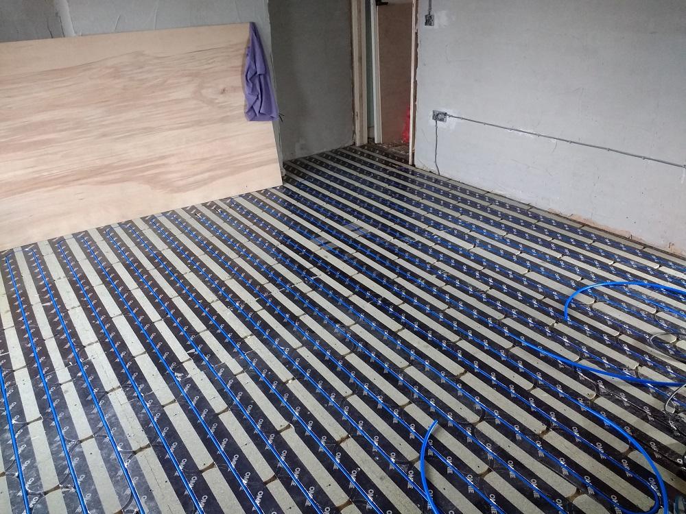

I’m trying to decide if paying extra for TorBoard is worth the minimized installation hassle when compared to using aluminum spreader plates.
Lots of you seem to have used aluminum spreader plates but I’m imagining a difficult job pulling pipe through posi-joists as they can’t be notched. Is there an easy method?
This is how the pricing looks
22mm P5 chipboard (£7/m2) and aluminum spreader plates (£14/m2)
Vs
Torboard (£24.8/m2) plus 6mm ply on top at £4/m2.
I’m assuming pipe, fixings and everything else balances out.
My heating demand is very low, upstairs UFH isn’t really a necessity but I would prefer a fitted system rather than having to plug in electric heaters on the coldest of days.
Because of the low demand I’m also considering a ‘half arsed’ job, where I make sure a smallish area of each room is covered with spreader plates and pipe. A similar style could also be achieved with TorBoard but I would then still need to cover the entire floor with 6mm ply.
Any thoughts always appreciated.

Very simple actually.
11mm OSB deck over the joists.  This is just to support the pipe and pug mix.
25 by 50mm battens following the lines of the joists.  These are notched where needed for pipes to pass.
Pipes laid between battens and pug mix added.
Final floor on top, in this case engineered oak boards.  The boards sit on the battens, not the pug mix, that is there just as a heat dispersant.

Thanks for the explanation. I dont have the height to build up off the joists unfortunately, (can swallow 6mm for ply) so no option other than to take the pipe under the joists.

I think if I'm going to use it, I will go for a half and half approach. Using normal P5 chipboard around the perimeter and then TorBoard everywhere else. This might reduce the cost enough to make the extra expense justifiable and will avoid passing the pipe under the joists with the spreader plate method.
It certainly sounds like a plan. I guess that as you're having heating downstairs as well it should be just fine to localize the heating upstairs. Currently we don't have any heating downstairs and the UFH upstairs in the bedrooms is more than enough to warm it up. Granted its not that cold yet.
Because the pipe channels run in one direction you usually do need to pass the pipes under the floor and through the joists. But if you putting in regular T&G panels around the edges you could route these to send your pipes to the necessary location without needing to get underneath and drill things. would make for a tidy installation.
I did that in my en-suits.  They were both only a short run of pipe, but it was a right pain feeding still quite long bits of pipe under and between the posi joist webs.  With anything like a full room e.g. a bedroom I think it would become an impossible task.
