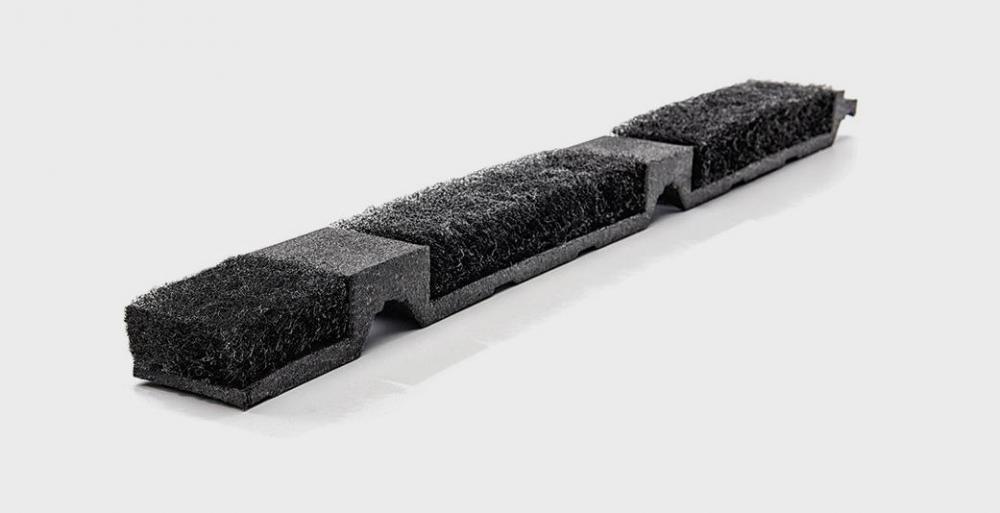

Tom's Barn Posted October 9, 2019 Share Posted October 9, 2019 (edited) Hi All I am in the process of specifying the details for our new corrugated roof (dictated by the conservation officer). The main issue I am coming across is how to ventilate the roof panels because the foam closure strips have no ventilation holes in them. One supplier has sent me a foam closure for the panels which has holes drilled in it and mesh infils. This seems like a great solution but it is 20mm higher than the normal strips. Before I fully commit to this product (the only one I have seen so far), how did you ventilate your corrugated roof? Many thanks for sharing your experience with this matter Tom Edited October 9, 2019 by Tom's Barn Link to comment Share on other sites More sharing options...

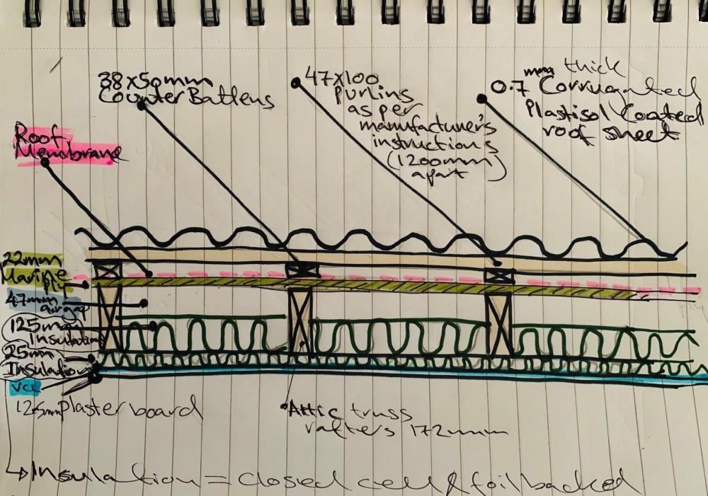

Tom's Barn Posted January 21, 2020 Author Share Posted January 21, 2020 On 10/10/2019 at 17:24, Visti said: We've battented and counter battented with standard treated battens, 38 by 25mm. I guess you could place instect or rodent mesh along with the first line of counter battens to your structure, with your foam filler stapled against the counter batten and topped with mastic tape, ready for when you install the corrugated on top... It'd probably be only a little bit of extra effort, but I can imagine installing the sheets on top of that will get quite faffy. Win and rain has been the main concern for us, the insect and rodent issue hasn't been. Our roofers, architect and building control haven't said a thing about it either Hi @Visti I hope the roof installation went well....any lessons learnt? Also I cannot find any guidance re batten size. How did you choose the 38 X 25 battens? Surely in a strong wind the uplift on the screws for the horizontal batten at 25mm is too much. I would have thought a 50mm horizontal batten at the very least. Any guidance appreciated. Do you have a spec sheet for fitting the sheets. I am struggling to find a capable person to fit. I know in the end it will be me that ends up fitting it which I don't really have time. Thanks oh and any photos? Link to comment Share on other sites More sharing options...

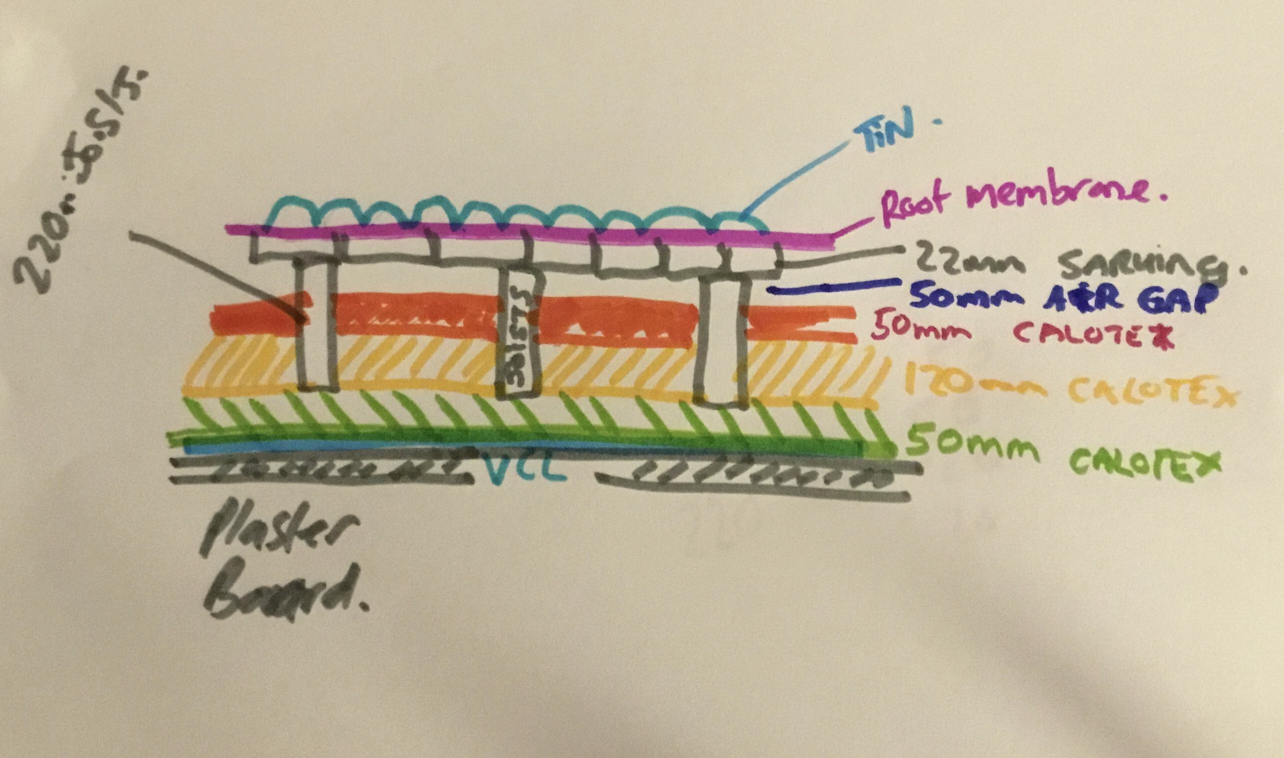

Cpd Posted January 21, 2020 Share Posted January 21, 2020 1 hour ago, Tom's Barn said: Thanks again for the previous info. Question if I may.....what batten sizes have you used on your roofs? My roof is treated sarking board 150x22mm onto 400mm roof joists with membrane on top of the sarking, it’s vented below the sarking with a 50mm gap between sarking and inserted and fully sealed / taped calotex the gap is vented at the soffit with vents at each bay and up to a fully vented ridge.... so I decided to not use battens and fixed directly to the sarking and through the roof membrane, I observed this for about 3 years before I got round to closing it all in from the inside and everything was bone dry with a really good draught up each of the Joist bays, It’s probably NOT the correct way but in my very windy location (a few hundred yards from the sea and prevailing ocean breeze) its worked really well, any condensation that may form will dry out pretty quickly. The lack of space under the tin will also provide very little space for interested wildlife looking for a new home. Was I doing it again and knowing what I know now I would probable batten the roof out just as good practice and to increase ventilation even more. However I don’t loose and sleep over what I have done. Link to comment Share on other sites More sharing options...
Patrick Posted January 21, 2020 Share Posted January 21, 2020 https://www.ebay.co.uk/itm/New-Roof-Eaves-Comb-Filler-Bird-Stop-Fills-Gap-In-Tiles-/350456857361 Link to comment Share on other sites More sharing options...
Tom's Barn Posted January 21, 2020 Author Share Posted January 21, 2020 8 hours ago, Patrick said: https://www.ebay.co.uk/itm/New-Roof-Eaves-Comb-Filler-Bird-Stop-Fills-Gap-In-Tiles-/350456857361 Thank you. Just ordered some to see what they are like. Much appreciated. Link to comment Share on other sites More sharing options...
Tom's Barn Posted January 21, 2020 Author Share Posted January 21, 2020 9 hours ago, Cpd said: My roof is treated sarking board 150x22mm onto 400mm roof joists with membrane on top of the sarking, it’s vented below the sarking with a 50mm gap between sarking and inserted and fully sealed / taped calotex the gap is vented at the soffit with vents at each bay and up to a fully vented ridge.... so I decided to not use battens and fixed directly to the sarking and through the roof membrane, I observed this for about 3 years before I got round to closing it all in from the inside and everything was bone dry with a really good draught up each of the Joist bays, It’s probably NOT the correct way but in my very windy location (a few hundred yards from the sea and prevailing ocean breeze) its worked really well, any condensation that may form will dry out pretty quickly. The lack of space under the tin will also provide very little space for interested wildlife looking for a new home. Was I doing it again and knowing what I know now I would probable batten the roof out just as good practice and to increase ventilation even more. However I don’t loose and sleep over what I have done. Many thanks for sharing this info. Are you saying you have now closed the ventilation gap within the roof space completely? I talked with proctor recently and they said as long as the roof space was completely filled with rockwool and a vapour membrane was attached inside then there was no need to ventilate due to the 75mm of ventilation above the membrane. Thank you Link to comment Share on other sites More sharing options...
Cpd Posted January 21, 2020 Share Posted January 21, 2020 No I have a vented area of 50mm above the insulation and below the sarking running up between each joist. my vcl is behind the plasterboard but all the insulation is fully fitted and foamed / taped at each layer. there is No where for air to move between the layers of insulation as there are no gaps. the vented area is open at the bottom of the roof with soffit vents and open at the top with roof vents as well as a 200mm open vented triangle just below the ridge. air freely moves in this area, you will of course get air flowing up beneath the tin in each of the curves / profiles as they are open at the bottom and open at the top as I said probably not the text book roof but it seems to be working well, I expect if you did a condensation risk analysis then it would show potential problems with the joists but due to my windy location I am happy with how it works. I have also read that you can fully fill with the correct build up but I have always felt that should there be any issues with damp then I want it capable of drying out ASAP. My shed roof is far more basic and until I decide on whats going on in there I will keep my options open. Link to comment Share on other sites More sharing options...
Patrick Posted January 21, 2020 Share Posted January 21, 2020 1 hour ago, Tom's Barn said: Thank you. Just ordered some to see what they are like. Much appreciated. I can't comment on the quality of this one as I on purpose put a link from random ebay seller to not create a conflict of interest, but generally we use this kind of thing all the time on our roofs, corrugated and box profile, and it works perfect. Link to comment Share on other sites More sharing options...
Visti Posted January 21, 2020 Share Posted January 21, 2020 @Tom's Barn the battens were all fixed through the external timber marine board and external membrane down to the joists themselves, both vertical and cross battens. Any other way is asking for trouble. That results in 50mm clearance between the sheet and the board which allows it to ventilate and try if you get any condensation on the underside. WeYou don't want to fully block the passage of air under the sheets for this reason. We got our sheets treated on the backside with an anti-condensation layer to help avoid that anyway. Cladco, the steel sheet supplier has some decent installation manuals on their website. Highly recommend. See my post below in how not to install corrugated sheeting. Very DIYable, wouldn't pay a roofer to do it next time when I do the car port. I'd recommend listening to @Cpd's posts as they are very helpful. My own tips are: - get the domestic screws and caps, we didn't know there were options and the commercial ones are quite obvious, even with caps. - you only need to cut sheets down to length. Don't cut along the length of you can avoid it. For windows, one sheet each side and then shorter sheets above and below, don't cut out the corner for the sheet to wrap around. Looks horrid. - use the right tool to cut the sheets (nibbler) and it is a breeze. Don't be and idiot and try with a recip saw... Very very bad cuts. - plan the spacing of your fixings ahead of time. It is really obvious if they aren't aligned or regular - don't trust trades when they claim they can do a job. Check their references, give them the supplier instructions, walk it through with them, check up on them, inspect the work as they go, get a paper trail via email... - ... Or just DIY this. Low skilled job provided flashings are in place along the edges of the sheets Link to comment Share on other sites More sharing options...

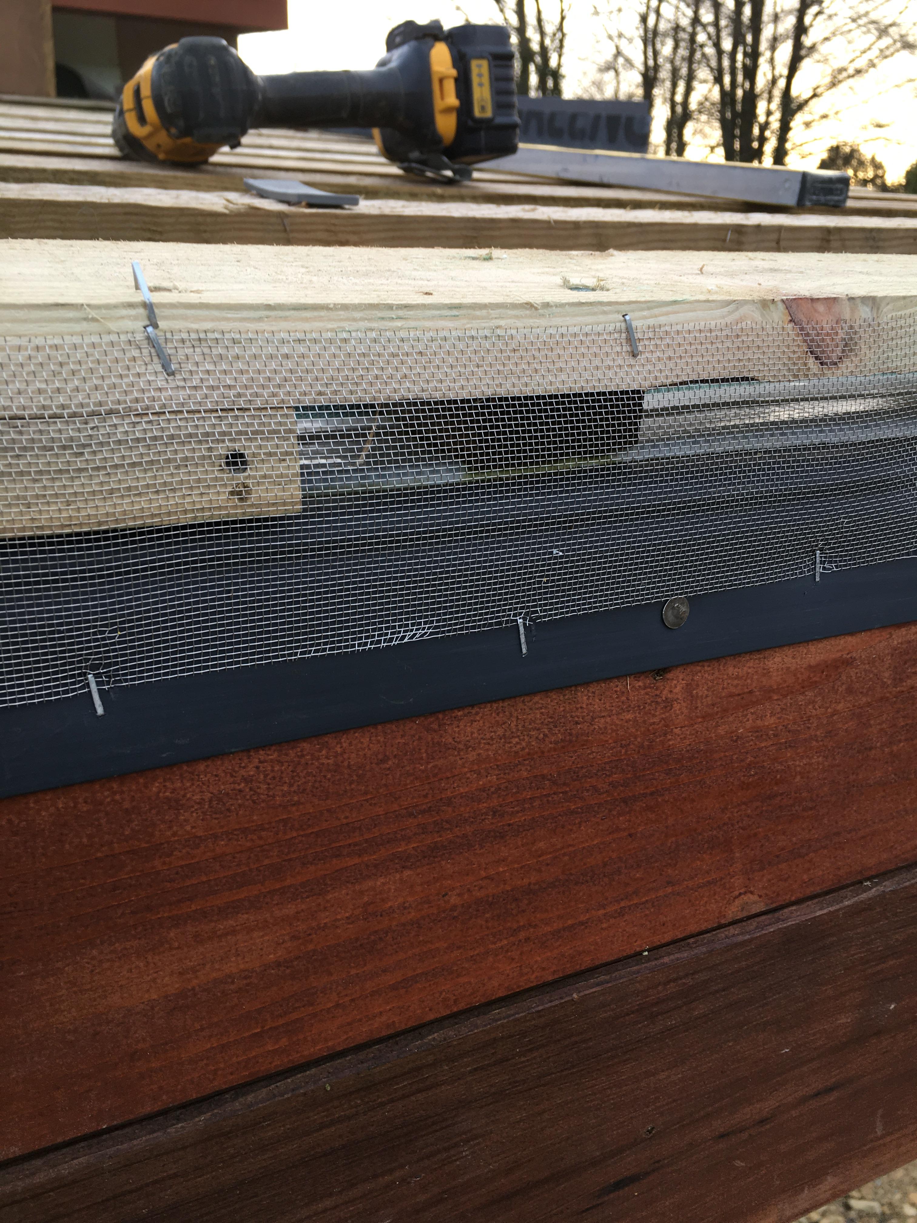

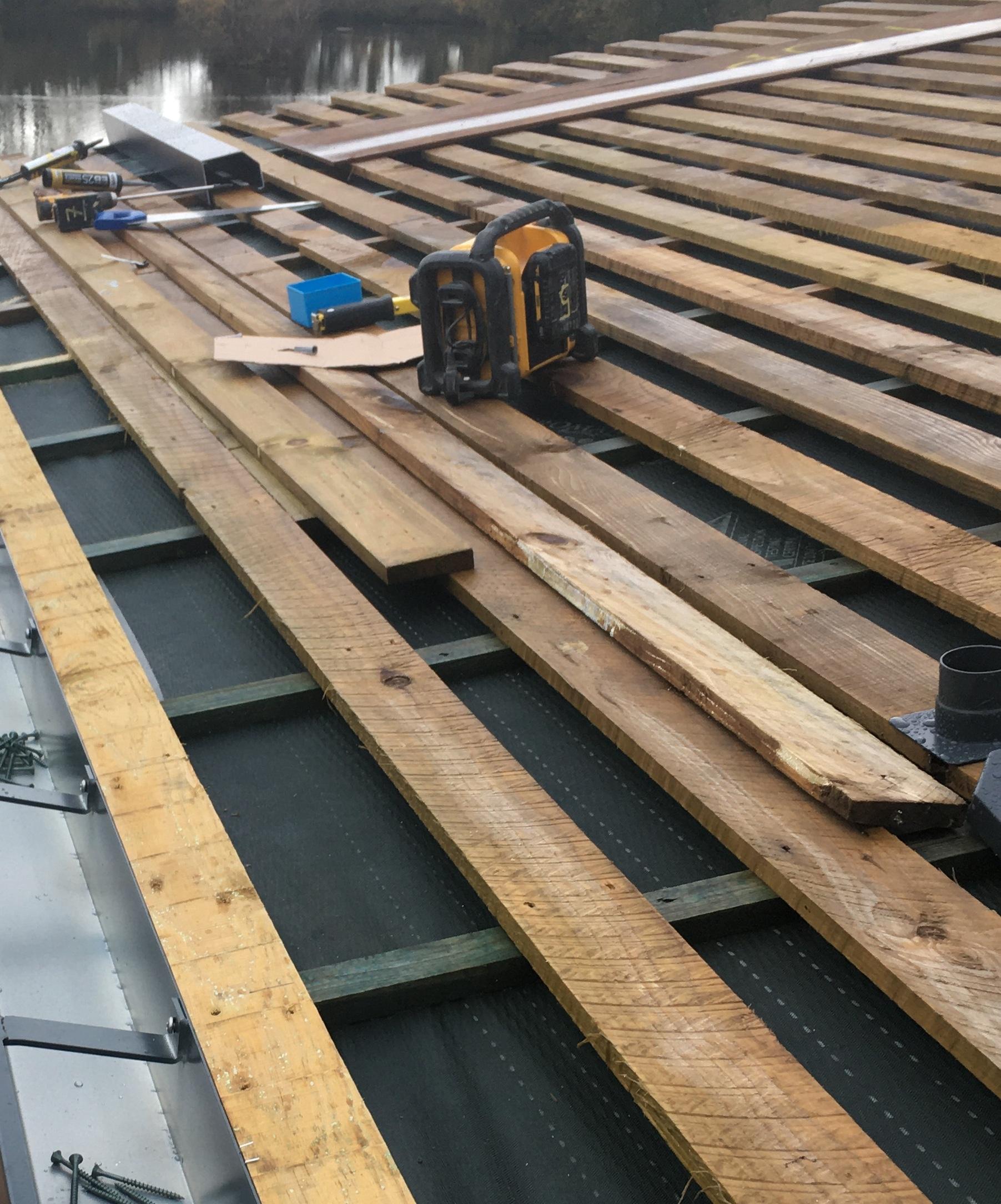

Russell griffiths Posted January 22, 2020 Share Posted January 22, 2020 (edited) Is this any help. Stainless mesh over counter batten gap. then 100x25treated batten to take the sheets. Not corregated but it is metal. Edited January 22, 2020 by Russell griffiths 1 Link to comment Share on other sites More sharing options...
Cpd Posted January 22, 2020 Share Posted January 22, 2020 As always @Russell griffiths solid looking job, if I as doing it all again then this would be how my roof prep work would look. Bombproof 1 Link to comment Share on other sites More sharing options...
