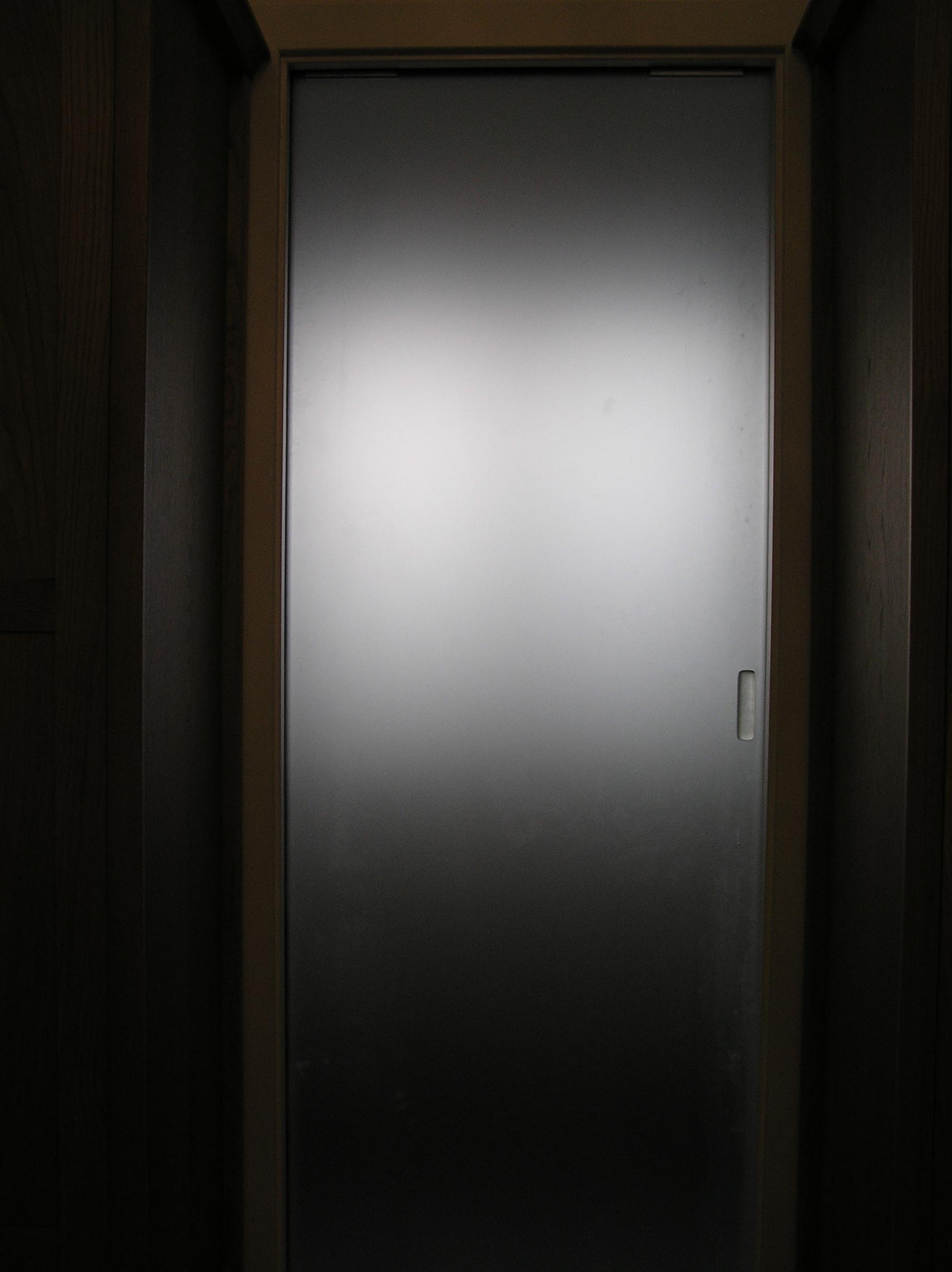

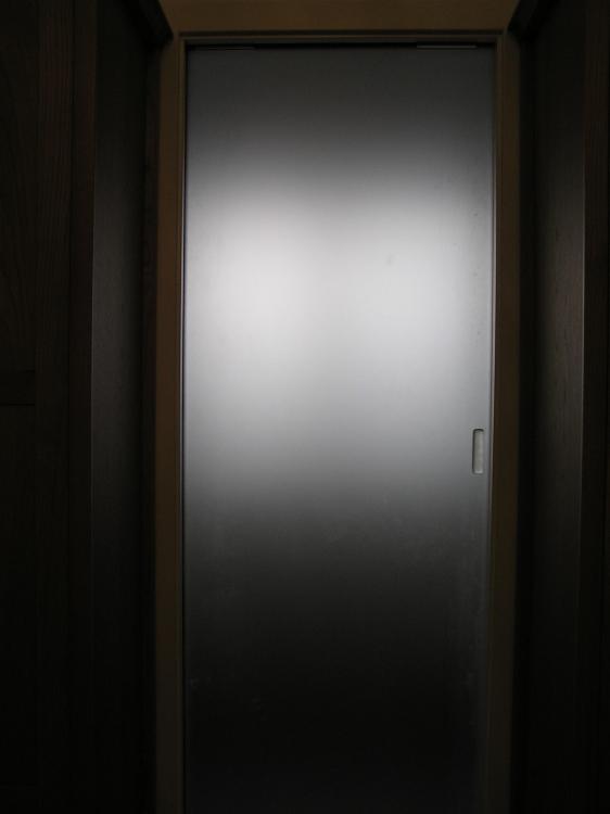

Gone West Posted October 12, 2019 Share Posted October 12, 2019 On 07/10/2019 at 18:47, pocster said: Considering this for an ensuite . Any recommendations ? Assume a glass door that locks ? ta We have an Eclisse glass pocket door on our ensuite but there's no lock on it. Link to comment Share on other sites More sharing options...
Pocster Posted October 12, 2019 Author Share Posted October 12, 2019 1 hour ago, PeterStarck said: We have an Eclisse glass pocket door on our ensuite but there's no lock on it. How did you find the install ? Also the quality? . Any photos ? Link to comment Share on other sites More sharing options...
Temp Posted October 12, 2019 Share Posted October 12, 2019 We have a Eclisee with wood door. If you follow the instructions it goes fine. Watch out you don't overtighten the screws holding plasterboard to the frame. If they go in too far they can scratch the door. 1 Link to comment Share on other sites More sharing options...
Gone West Posted October 13, 2019 Share Posted October 13, 2019 13 hours ago, pocster said: How did you find the install ? Also the quality? . Any photos ? We fitted it about seven years ago so the designs have probably changed but the install was straightforward. Eclisse quality is good. Sorry about the dirty door and photo quality. 1 Link to comment Share on other sites More sharing options...
