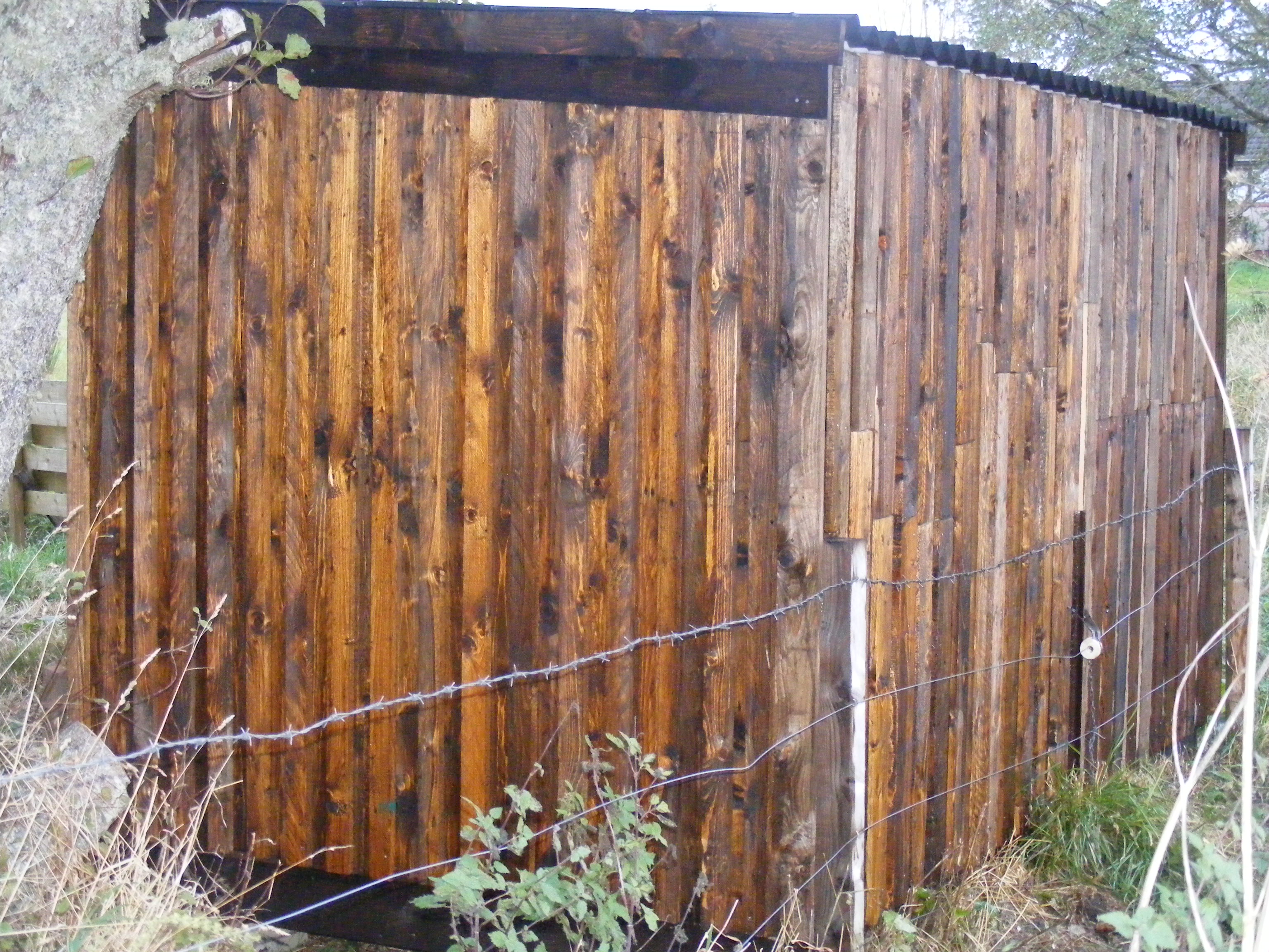

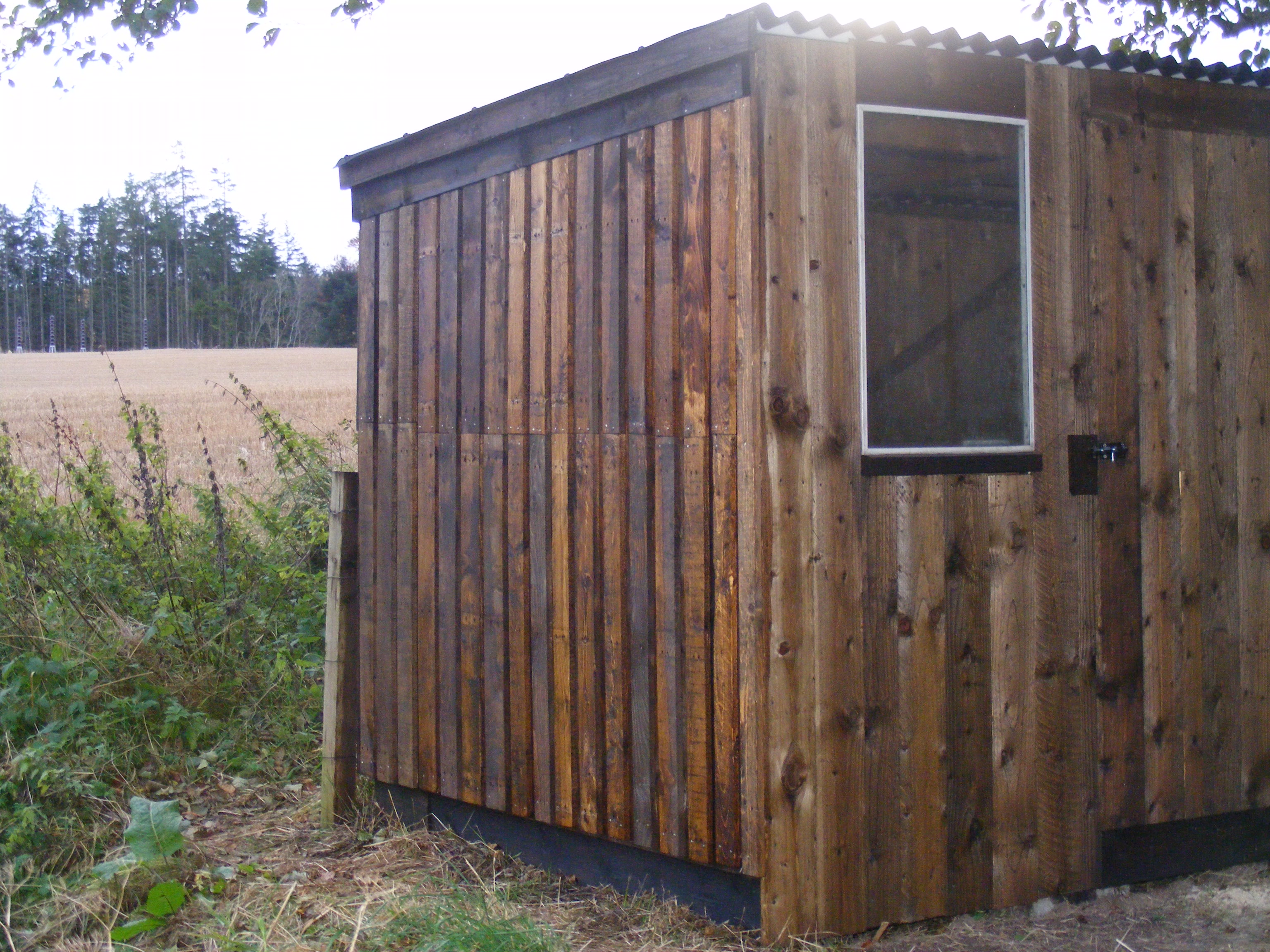

ProDave Posted October 17, 2016 Author Share Posted October 17, 2016 Yes it is very solid. the pallet planks that make up the cladding are about 3/4" thick. The frame is quite sturdy and has diagonal bracing on all sides so it won't start leaning when the wind blows. It's staked down to the ground so it won't blow away. It's all been painted with the modern version of creosote. the lighter brown on the rear was the first to be done and the front, looking darker was the most recent. I suspect it will all lighten up fairly quickly. I like creosote for stuff like this, so easy to apply (and re apply) and effective at repelling water and preventing rot. I forgot to say, the roof timbers are 6 X2 and 4 X 2 timbers that have previously been used as shuttering for a concrete slab, so again, re using previously used timber. 1 Link to comment Share on other sites More sharing options...

ProDave Posted November 7, 2016 Author Share Posted November 7, 2016 A bit more done on "the shed" I have dismantled the rest of my pallet collection. These are mostly the pallets that the roof tiles came on. These have yielded much thinner and narrower planks. these have been used to cover the joints in the original shed wall planks, to stop driven rain entering. What this has shown is just how many pallets you need to get any useful amount of wood from. What started looking like a very large pile of pallets in the end was barely enough to complete the shed. Watch out for the next installment. The bearers from the roof tile pallets are set to become the frame for a bench inside the shed..... Link to comment Share on other sites More sharing options...

ProDave Posted September 12, 2018 Author Share Posted September 12, 2018 You are correct, I forgot to make any more updates. It was only the interior, and that is now looking like a shed, full of "stuff" It's standing up very well and no leaks. Far more sturdy than the shop bought shed I wired for a customer recently, made of something not much stronger than cardboard. 1 1 Link to comment Share on other sites More sharing options...
