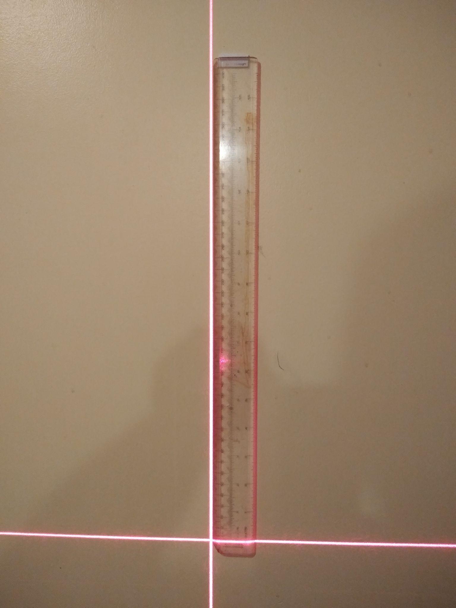

SteamyTea Posted May 7, 2022 Posted May 7, 2022 (edited) You can just put one mark on the wall at the height you want, set the laser up as close to it as you easily can. Measure the distance from the laser line and the mark and the measured height difference, a distance away. Then join the two marks. Edited May 7, 2022 by SteamyTea

SteamyTea Posted May 7, 2022 Posted May 7, 2022 On 07/05/2022 at 20:51, MJNewton said: sounds like you are talking about something different Expand Maybe. But if I wanted to easily set up a new level without moving the laser, below is what I do. Just measure a distance and displace it to the left or the right.

MJNewton Posted May 7, 2022 Posted May 7, 2022 On 07/05/2022 at 21:03, SteamyTea said: Maybe. But if I wanted to easily set up a new level without moving the laser, below is what I do. Just measure a distance and displace it to the left or the right. Expand Yes, absolutely. And of course that method would work if the level is on the floor in my pictures scenario but you'd be measuring 1.47m (assuming the laser sits 3cm above its base) up from that skirting-level mark which then likely introduces other issues!

SteamyTea Posted May 7, 2022 Posted May 7, 2022 On 07/05/2022 at 21:15, MJNewton said: but you'd be measuring 1.47m (assuming the laser sits 3cm above its base) up from that skirting-level mark which then likely introduces other issues! Expand I would use a decent rule, not the ruler in the picture (that is one I had at school, so probably 50 years old now). Accumulative error is a problem, but this is for a house, not precision engineering. If you fit, say that curtain rail dead level, it would show that the ceiling isn't, or the windows. Really just a case of creating a datum and working from that as best you can.
