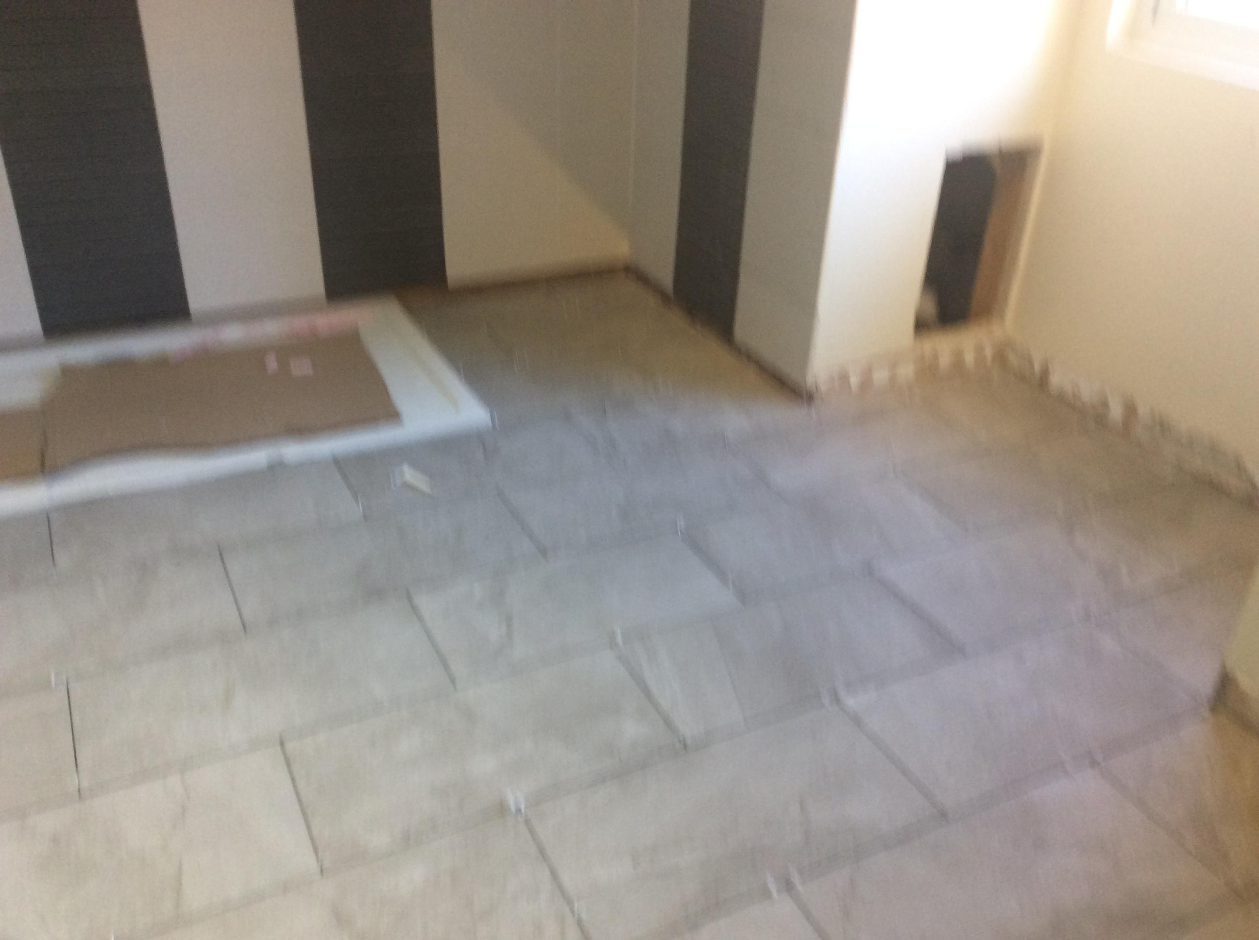

Anyhoo mine is now tiled but not grouted.
FBBF6F7C4-92E6-4FB2-90C9-1B2E565EF078.thumb.jpeg.2f16c71fa905a1f62c04f9b2517e645d.jpeg

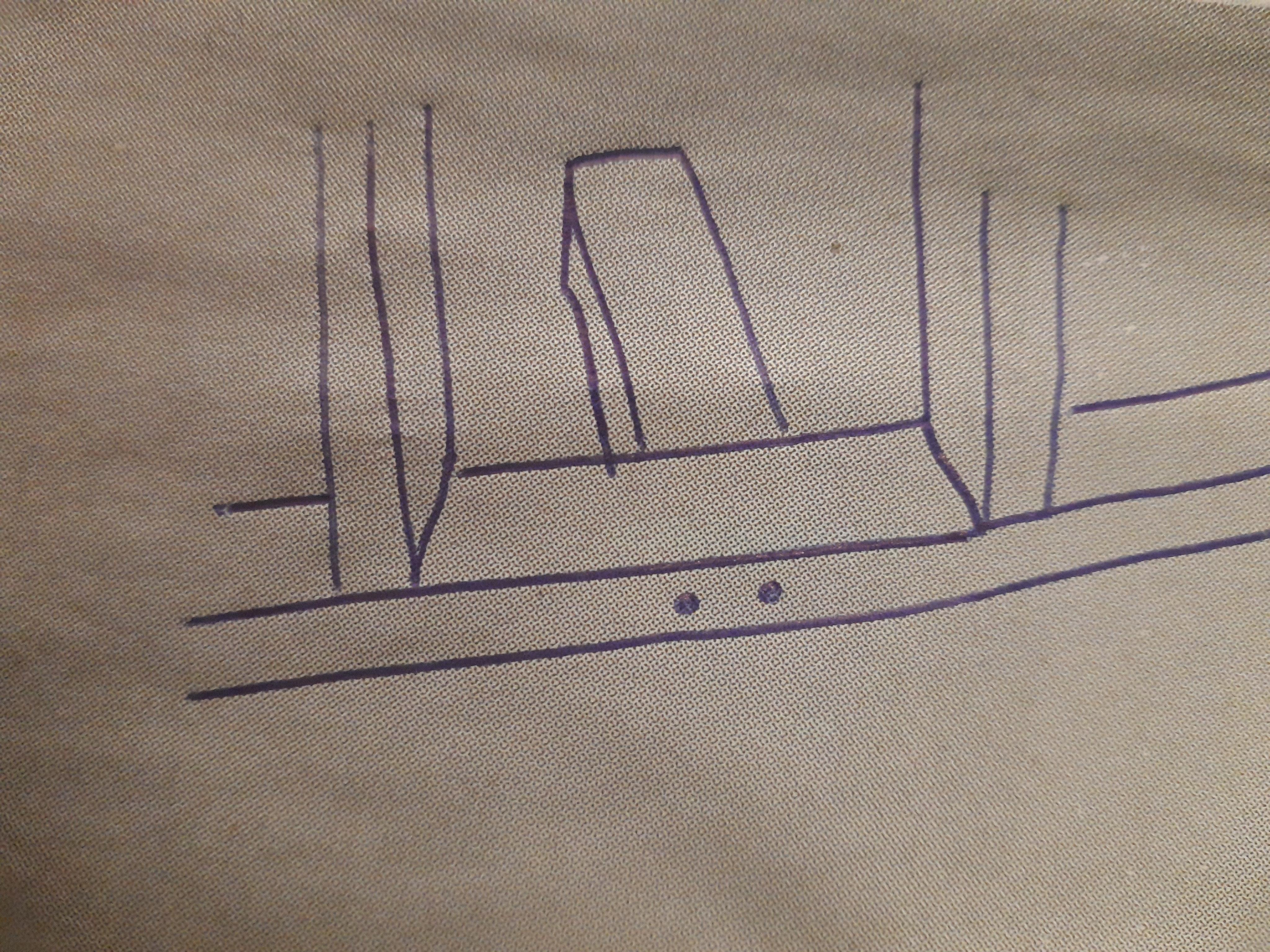

Not sure what you mean .
I was going to noggin across to my new wall off the timber frame ; like this
That's pretty much it but I meant have the noggins level with the front sole plate so the screws aren't in shear. Neater too imo.

I meant tops level! ?
Hmmmmmm . Well if I did it that way the timber would still need to be at an angle to meet the timber frame . My way propping it’s height up - oh ffs ! - does it matter !! ?

I wouldn't do it like that, you would be screwing into the end grain of the noggin / strap, which is never very good.
@pocster way I think is stronger. Plus you don't need to cut the strap to the precise length. :D

Thought modern screws were designed to facilitate screwing into end grain? I pilot and glue anyway.
