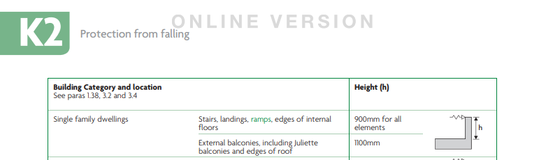

ProDave Posted October 1, 2019 Posted October 1, 2019 Building regs basically say a banister must be 1100 high, but then goes on to say it can be only 900 high in a domestic stair and on a "landing" So a lot of the domestic stair part manufacturers only make 900mm high components. This caused us an issue and several months delay getting our completion certificate in the last house, as our building inspector tried to argue the galleried landing going round 3 sides of the stairwell was not a "landing" and came under "other" which required 1100mm. That was only solved when we refused to accept his verdict so he sought clarification from the Scottish Government, who agree ours only needed to be 900mm. 1 metre high is irelevant to building regs. It will either have to be a minimum of 900, or a minimum of 1100. So if your BC says 900 is no good, then neither is 1M 1

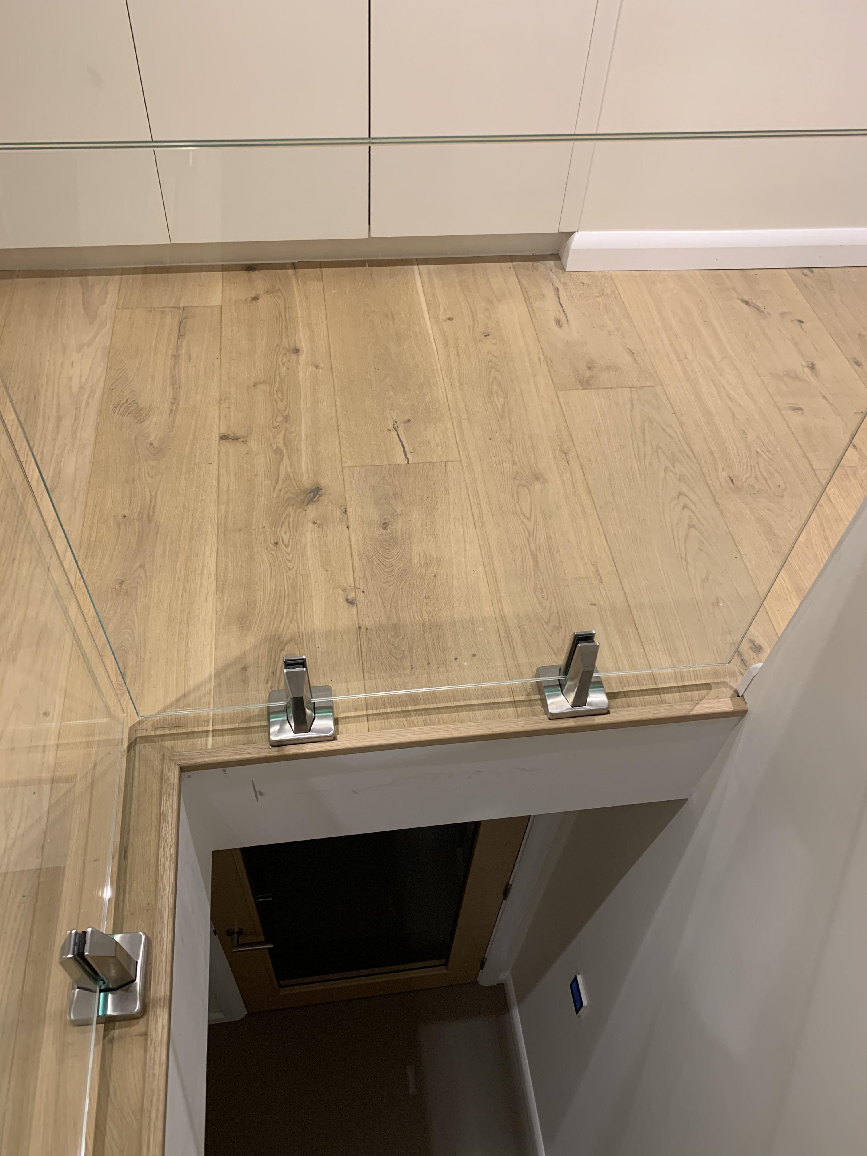

Bitpipe Posted October 1, 2019 Posted October 1, 2019 Our landing balustrade (frameless glass on steel feet) is 900mm - feels taller but no one gone over it yet.
Ferdinand Posted October 2, 2019 Posted October 2, 2019 Having checked, my glass balustrade banister is 900mm, with slightly taller posts.

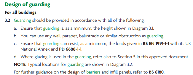

MortarThePoint Posted November 6, 2025 Posted November 6, 2025 On 01/10/2019 at 18:13, ProDave said: Building regs basically say a banister must be 1100 high, but then goes on to say it can be only 900 high in a domestic stair and on a "landing" Looking at table 3.1 in Part K it looks clear that the minimum height for internal elements in a single family dwelling is 900mm. A block of flats however would require 1100mm as would an external balcony of a family dwelling. I just got spooked by a call with Richard Burbidge where they said I need 1100mm even for a singe dwelling. I checked with my BCO to make sure and he says 900mm. -----
