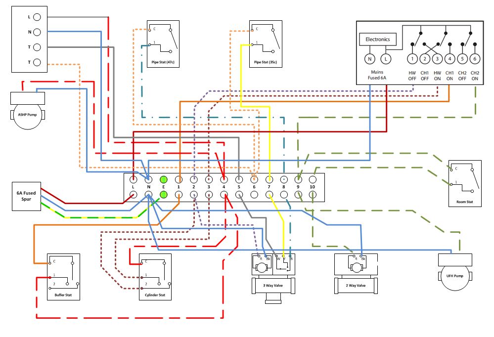

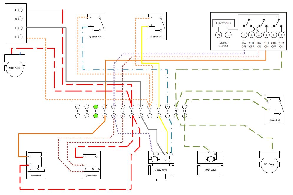

DeeJunFan Posted March 30, 2017 Author Share Posted March 30, 2017 1 minute ago, PeterW said: So this is mine less the PHE which I don't need. Buffer at 0.5Bar/atmospheric pressure. Use a 3 channel timer - one for DHW, one for buffer and one for circ pump and the stat to control the valve to the buffer. W-Plan modified to allow change over of the pipe stats needed to control the ASHP temp (47/35) And last one with power/neutral removed for clarity This looks like something you would see when 007 is walking through a russian nuclear plant. How big have you gone on the buffer tank? And Thanks by the way @PeterW Link to comment Share on other sites More sharing options...
PeterW Posted March 30, 2017 Share Posted March 30, 2017 Looking at a standard 900x300 copper cylinder. I'm leaving the immersion in as that way it means if the ASHP ever fails I've got a big version of @TerryE Willis heater ..! 1 Link to comment Share on other sites More sharing options...
DeeJunFan Posted March 30, 2017 Author Share Posted March 30, 2017 1 minute ago, PeterW said: Looking at a standard 900x300 copper cylinder. I'm leaving the immersion in as that way it means if the ASHP ever fails I've got a big version of @TerryE Willis heater ..! So 58L in old money Thanks D Link to comment Share on other sites More sharing options...
PeterW Posted March 30, 2017 Share Posted March 30, 2017 Meant to add the additional wiring is the link from HW Off to No.2 - this pushes the 3 way into heating mode when the HW is off Link to comment Share on other sites More sharing options...

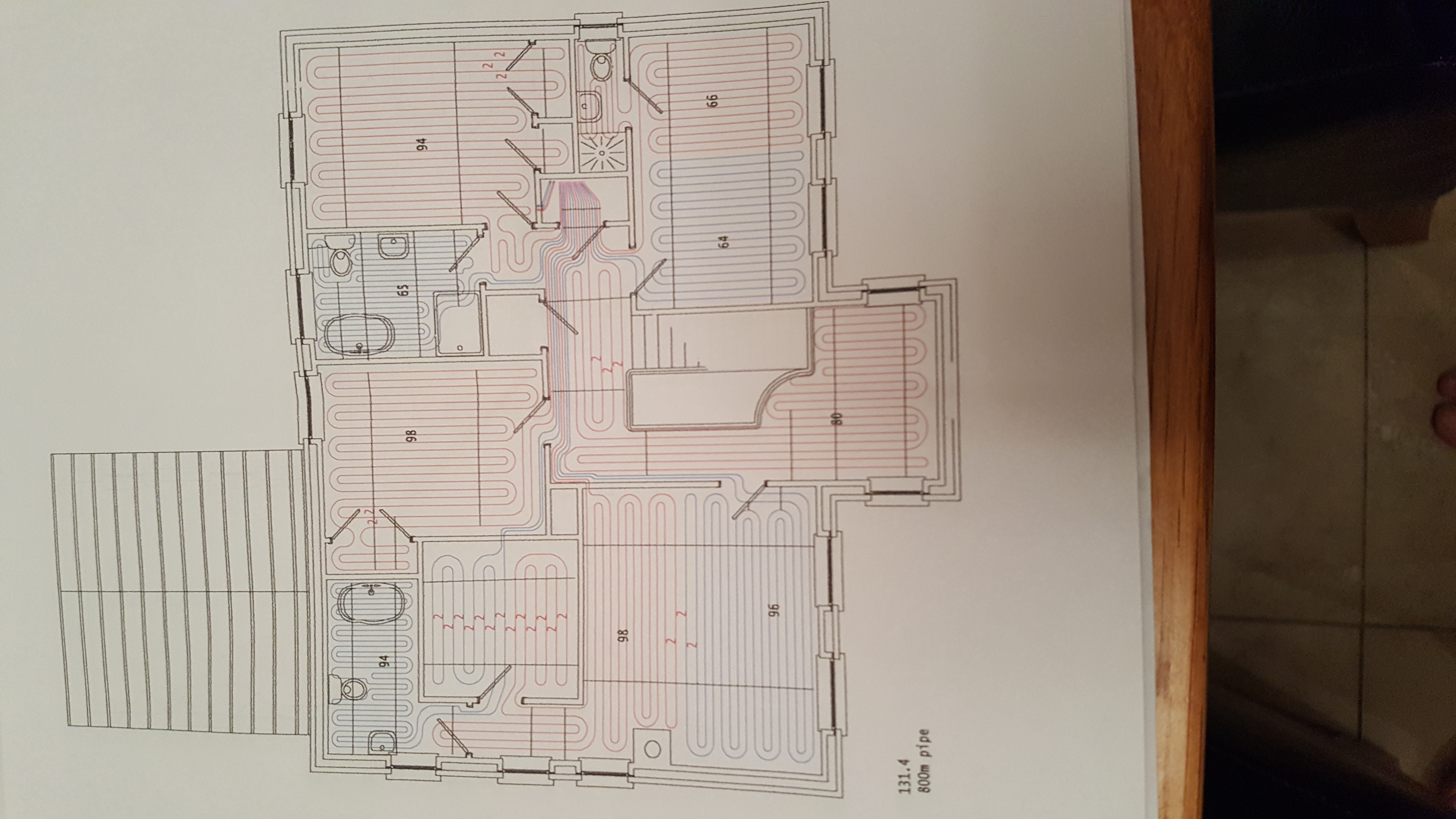

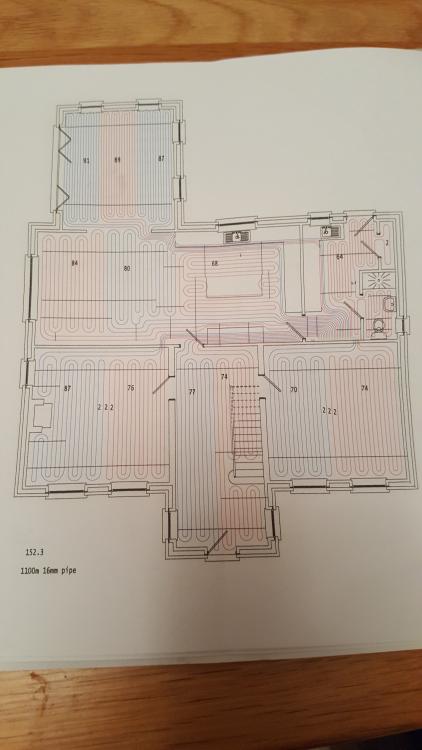

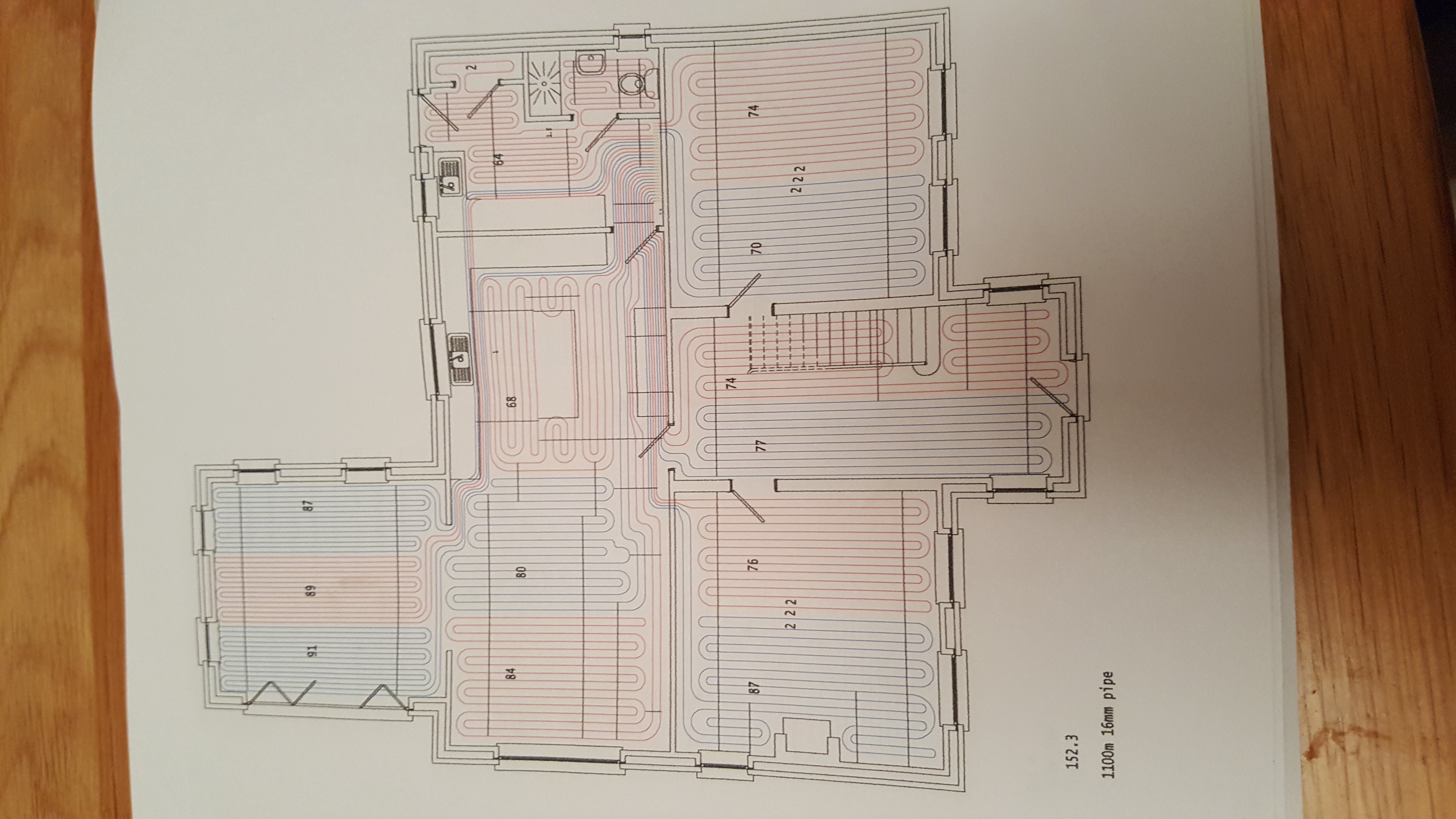

DeeJunFan Posted April 11, 2017 Author Share Posted April 11, 2017 So have a quick update Plumber #1 came back with a crazy quote and offered no justification or breakdown of costs. Plumber #2 2 days later came back with a quote 3-3.5k cheaper depending on cylinder selection. Had a fully itemised quote and UFH pipe layouts drawn so much more impressed with the initial professionalism. Also seems to know a good bit more then plumber #1 about ASHP At any rate he came up with his own design and I wanted to sanity check it to make sure my understanding is sound. So his plan is I'm sure more the out of the box solution for ASHP. Plumber the heat pump directly into the UFH at lower temp say 32 ish ? Then have it prioritise DHW and deliver that at 47 degrees to a 500l buffer with external plate heat exchangers for delivering DHW. Quoted for a heliotherm fresh water 500. Which is an eye watering £2155 I know this design really undermines the maximising of ASHP best COP with the max of 40 degrees but it is simple. I could live with that as using direct electric to lift from say 40 to 47 degrees wouldn't be a major issue especially with the solar PV. Any how. I'm wondering what you guys think and if you could advise on a secondary plan. Could I buy a Telford 500L store and add exrlternal plate heat exchangers at a much reduced cost? What Kw of PHE would I need for DHW delivery? Would that setup work out less than £2155? Also I don't think the heliotherm comes with an immersion so that would have to be added to get the most from the PV. Any thoughts @Nickfromwales @PeterW @JSHarris Have attached UFH drawings for the craic Link to comment Share on other sites More sharing options...
DeeJunFan Posted April 13, 2017 Author Share Posted April 13, 2017 Bump Any thoughts? Any idea of required PHE sizes/costs? Thanks Damian Link to comment Share on other sites More sharing options...
PeterW Posted April 13, 2017 Share Posted April 13, 2017 Sorry missed this..! so are you having a 500 buffer and a 500 UVC..?? 47c is barely hot enough to get most of the blending valves to operate so you probably want Immersions to take this up to 56c (and 65c once a week) and that floor plan has lots of pipe - 100mm centres..?? Link to comment Share on other sites More sharing options...
DeeJunFan Posted April 13, 2017 Author Share Posted April 13, 2017 Hi Peter, Just 1 500L buffer for DHW and ASHP going directly into the UFH. Centers are mostly 150 with a few 200mm. The sunroom is at 100mm. I have solar PV so will be getting hotter than that during the summer and taking it up a bit higher by direct electric i would think during the winter months. Link to comment Share on other sites More sharing options...
