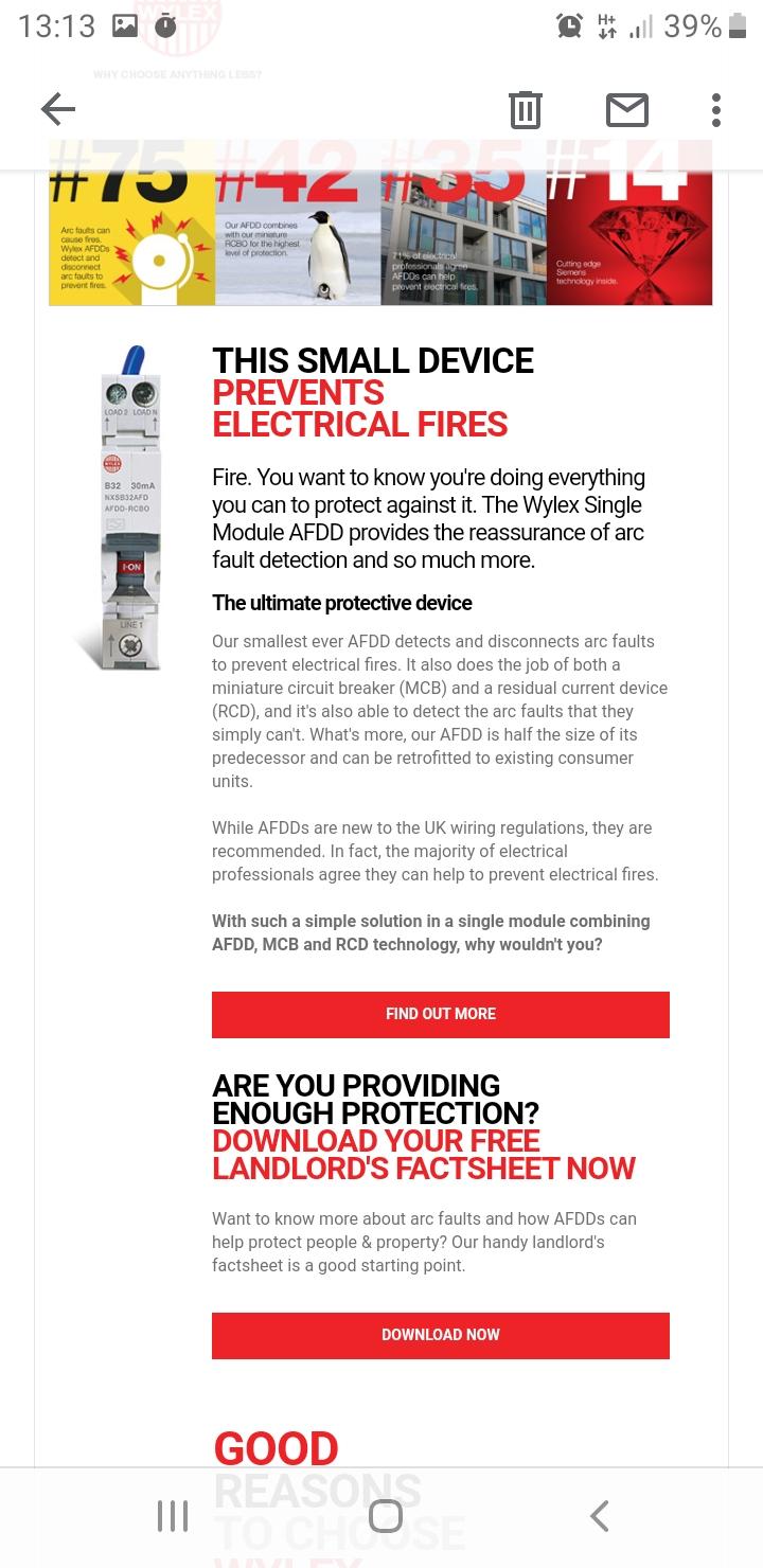

Wylex Combined AFDD/RCD/MCB
I like this!
Having recently done my 18th I was left like many others thinking wtf when it came to AFDDs. As in what circuits to protect and if one why not all etc and how to implement without having a massive cu. I know 2 module units have been available for a while but this is a one module wide unit combining AFDD/RCD & MCB. Haven't read any further as to price and assume its single pole switching. Only just dropped in my inbox.

1 hour ago, ProDave said:
I am just quietly ignoring them.  Isn't there a lot of concern about spurious tripping?
Yep, allegedly they work on a better safe than sorry principle! ?
I just like the idea / technical aspect of the 3 in one...wonder if they make them double pole...
The conspiracy theorist in me wonders if they are in fact a subtle way of reducing demand on the grid...more take up = more trips = less draw! ?
