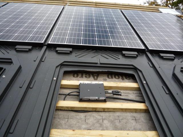

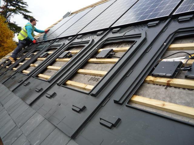

MikeSharp01 Posted September 10, 2019 Posted September 10, 2019 On another wrinkle - I have been looking at these in roof systems but I am struggling to get the panels flush with our fibre cement (Thrutone) tiles, this is similar to the problems I am having getting a water tight design for the roof windows flush with the tiles.
MikeSharp01 Posted September 10, 2019 Posted September 10, 2019 1 minute ago, PeterStarck said: If we fit a system, I'm still thinking about whether it's worth it, it will be using Enphase IQ7 micro-inverters. Yes - sorry Peter - I was only there last week and we talked about the possible array, should have remembered.
Jeremy Harris Posted September 10, 2019 Posted September 10, 2019 1 minute ago, MikeSharp01 said: On another wrinkle - I have been looking at these in roof systems but I am struggling to get the panels flush with our fibre cement (Thrutone) tiles, this is similar to the problems I am having getting a water tight design for the roof windows flush with the tiles. Our panels are proud of the slates by a fair bit, but it doesn't really stand out when looking from the ground. At a guess I'd say the panels may be around 30mm to 40mm higher than the slates:
Bitpipe Posted September 10, 2019 Posted September 10, 2019 We used micro inverters and I agree that maintenance may be an issue (and something I gave no consideration to), although our roof design is a bit more forgiving as it has a GRP ledge at the base and a sizeable flat area at the front. As we have slates, the trays are flush with those but the panels do sit proud, however all is watertight so not sure whether that's a function of the panel or tray.
