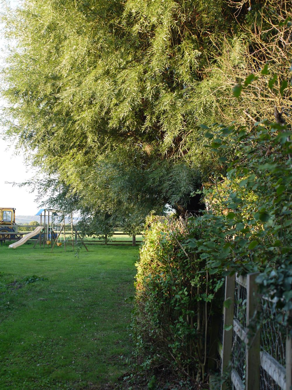

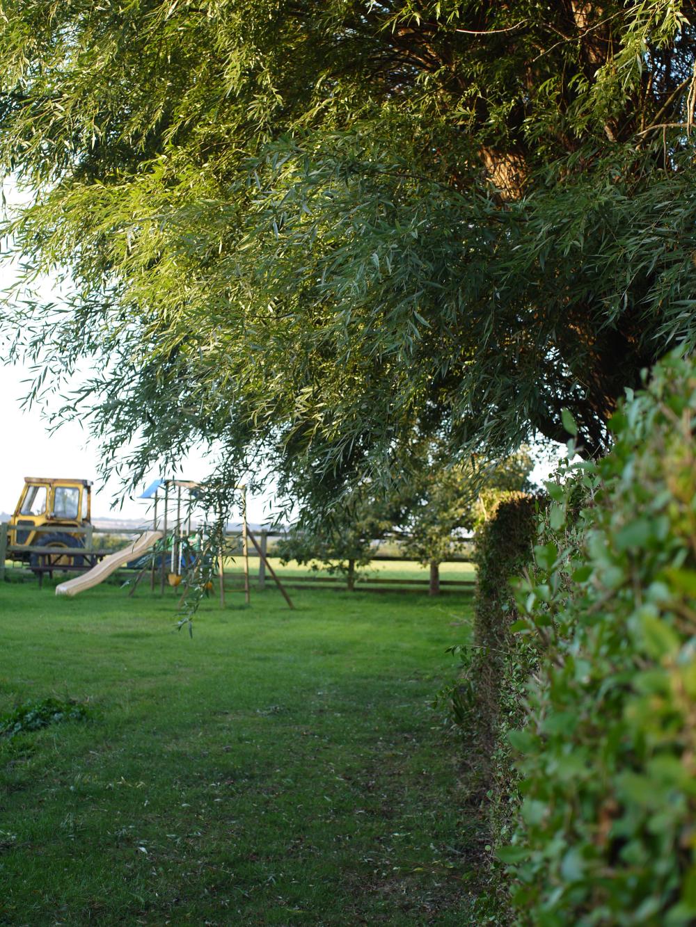

swisscheese Posted October 4, 2016 Share Posted October 4, 2016 I applied to the LAPD for consent to remove some very low (almost touching the ground) overhanging branches, predictably they have refused for the reason: "1. The description of works is non-specific and does not provide a specification for each tree and no reasons have been provided for the works." After re-reading my application and the guidance I don't see what I could have done differently so I have written to the Tree Officer for some advice. I wanted to get started on the groundworks on the build started so I wanted to take the low hanging stuff back to the boundary. Bearing in mind that these trees were properly polarded some 3 years ago, there must have been an application for that, and obviously since polarding the willows have severely bushed out and are massively now over hanging our property. So my question is simply can I just keep on applying as many times until I get permission to prune? Link to comment Share on other sites More sharing options...

PeterW Posted October 4, 2016 Share Posted October 4, 2016 8 hours ago, swisscheese said: I applied to the LAPD for consent to remove some very low (almost touching the ground) overhanging branches, predictably they have refused for the reason: "1. The description of works is non-specific and does not provide a specification for each tree and no reasons have been provided for the works." After re-reading my application and the guidance I don't see what I could have done differently so I have written to the Tree Officer for some advice. I wanted to get started on the groundworks on the build started so I wanted to take the low hanging stuff back to the boundary. Bearing in mind that these trees were properly polarded some 3 years ago, there must have been an application for that, and obviously since polarding the willows have severely bushed out and are massively now over hanging our property. So my question is simply can I just keep on applying as many times until I get permission to prune? Lets have some photos then as Ferdi seems to have got me on this one..! Questions... - Did your planning application include any tree reports or require any pruning..? - What do you need to trim the trees for..? Are they in the way..? - Who's done the foundation design as willows can be a bugger for drawing water and building near them needs serious thought ! Link to comment Share on other sites More sharing options...

swisscheese Posted October 6, 2016 Author Share Posted October 6, 2016 Yes, Frank was excellent and I couldn't recommend him highly enough, his list of qualifications and connections is incredible. The Site and Trees have a (failing application) planning history so Franks instruction was clear, do not talk to or get into a conversation with the Tree Officer or Council, he dealt with it all. It was worth it, but will get costly if I have to ask him to write a report every time I need to apply for works. The owner of the Trees was vehemently opposed to our Planning Application. She is unlikely to voluntarily apply for re-pollarding despite the recommendation from the LA Tree Officer. Prune back, ideally to the boundary to about 6m height - at this stage the reality is I just need to Prune back for clearance for plant and machinery. Thanks for your input. Link to comment Share on other sites More sharing options...
PeterW Posted October 6, 2016 Share Posted October 6, 2016 Have you got to do any RPA fencing before you start..?? If not, drive the rig onto site and if it "catches" the trees the they are damaged and you have a duty of care to prune the damaged branches back, remembering to give next door back the trimmings ... You could also give Frank a quick call for advice too - may advise over the phone Link to comment Share on other sites More sharing options...
