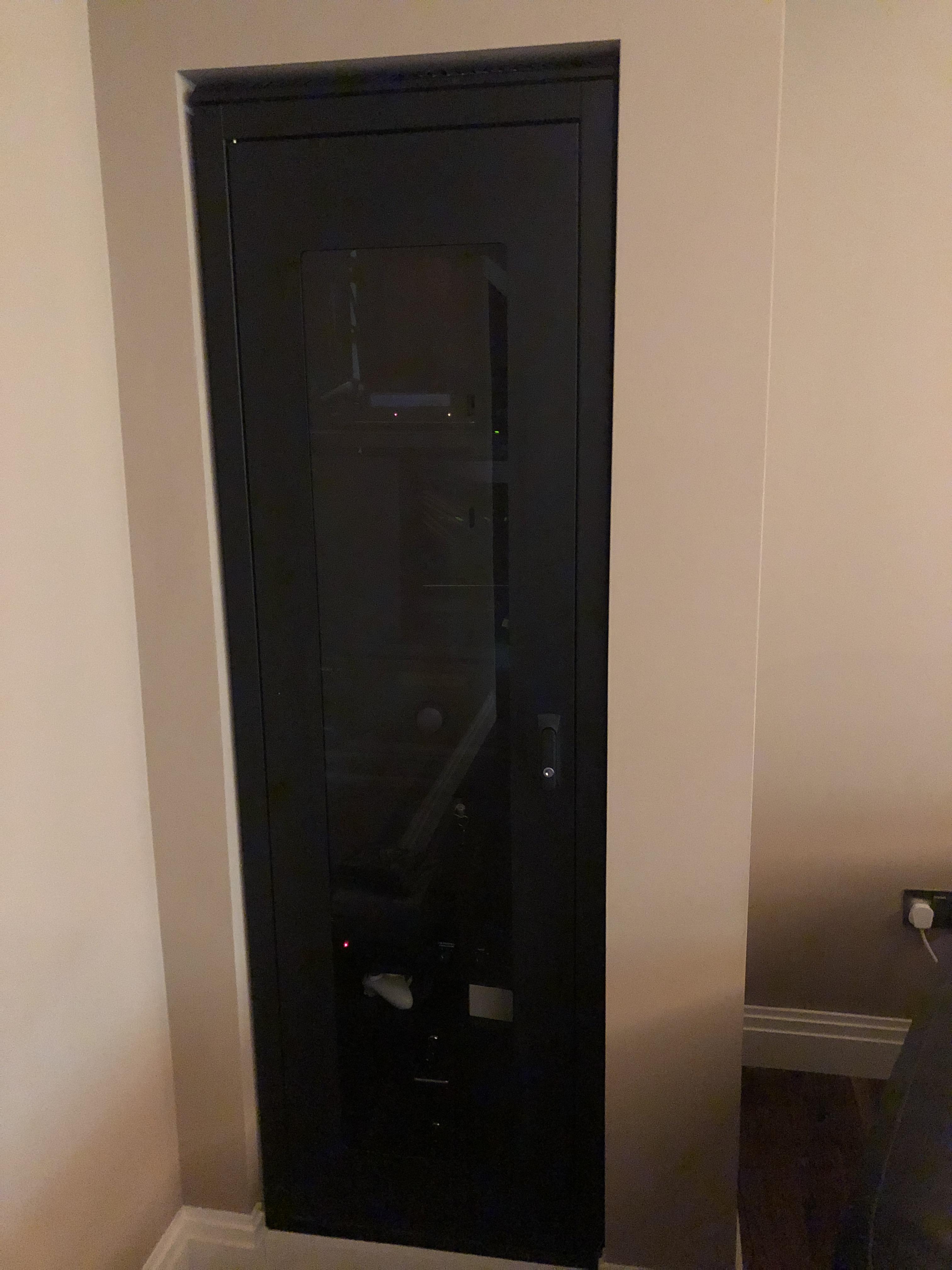

AliG Posted May 25, 2021 Share Posted May 25, 2021 @puntloos I have a very similar set up to you there. I have a Mid Atlantic 39u rack that is 600mm wide by 800mm deep. The media people wanted the extra depth. We built the front of the cupboard to the size of the rack. The rack has a perspex door n the front. We didn't put the back door on the cabinet and just put a normal house door on the back of the cupboard. The rack was just pushed through until it was in place and hasn't been moved since. The rear access makes moving the wires around a dream. The switches face the back and the AV gear faces the front. Link to comment Share on other sites More sharing options...

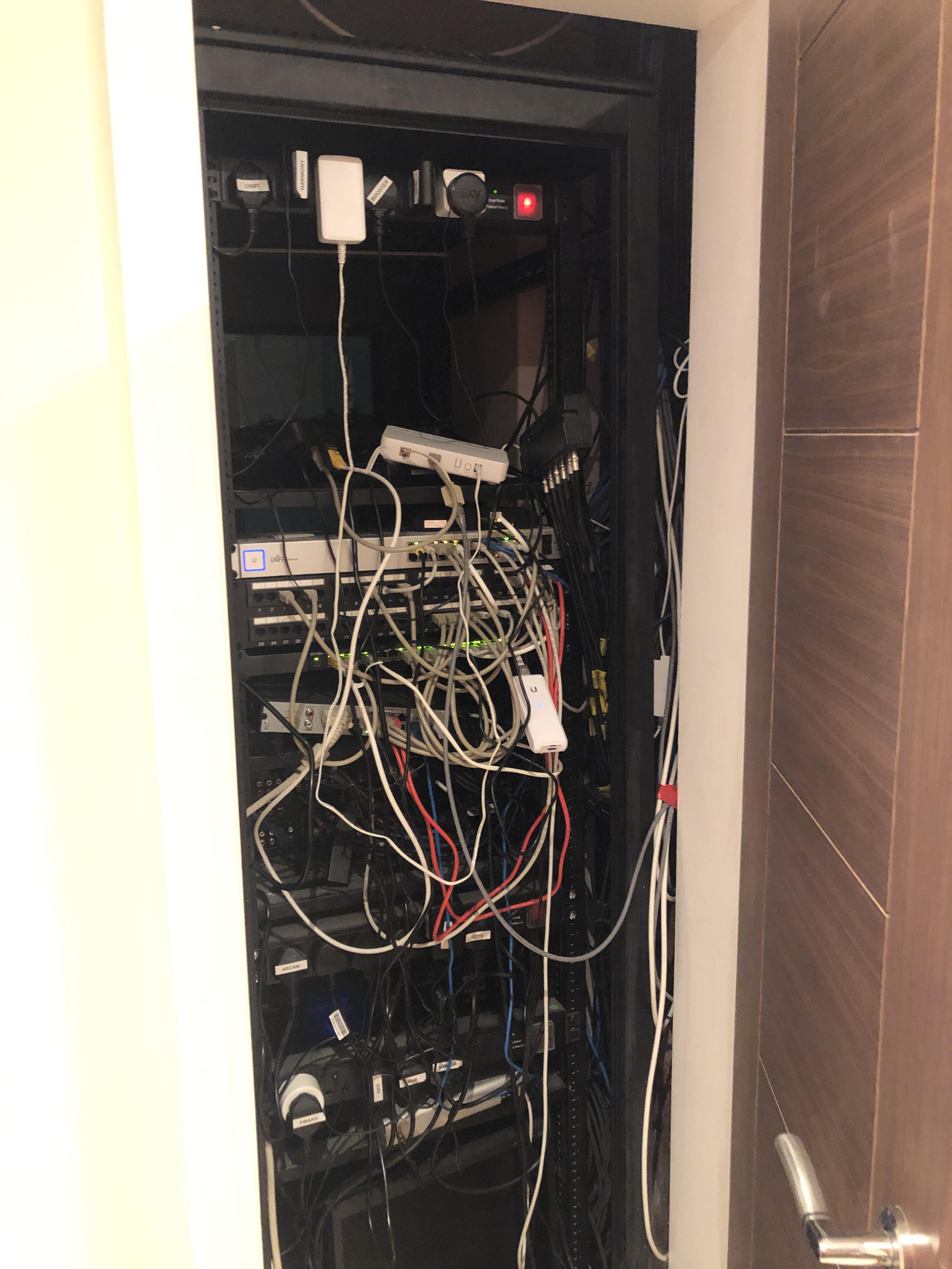

AliG Posted May 26, 2021 Share Posted May 26, 2021 Picture of the front and rear of the cupboard. Note the tidy cabling! 1 Link to comment Share on other sites More sharing options...
IanR Posted May 26, 2021 Share Posted May 26, 2021 I don't recognise the first picture, but the second is exactly what I expect of a coms cabinet! 1 Link to comment Share on other sites More sharing options...
AliG Posted May 26, 2021 Share Posted May 26, 2021 The first picture is the front of the cabinet, we framed out the wall to the size of the cabinet and got a cabinet with a perspex door on front. So you can access the Xbox etc from the front and the cables from the back. The cabinet does not seem to need any cooling, but puts an enormous amount of heat into the room where the UFH has never been switched on. In the summer I leave the back door of the cabinet open into the utility room which helps dissipate the heat. You can hear the fans of various items in the cabinet, but I don't find it annoying, once the projector is on it is louder still. The loudest fan was the PoE switch which I replaced which a fanless one when it broke. But you still have the Sky Q box and the CCTV NVR which is particularly noisy. Once you are watching something it all fades into the background. Link to comment Share on other sites More sharing options...
