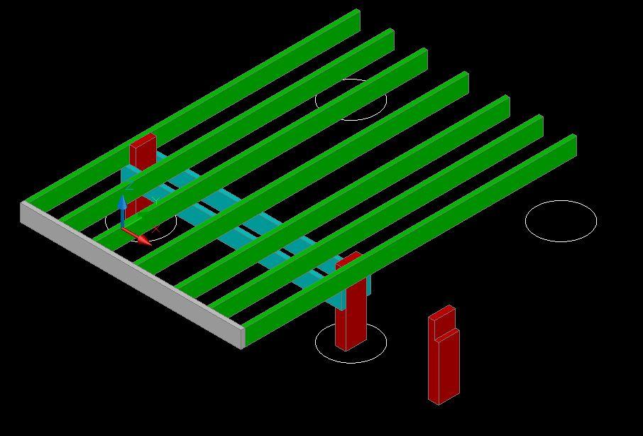

zoothorn Posted September 12, 2019 Author Share Posted September 12, 2019 @Onoff just seen your Q under your photo of kids area thing- looks terrific that btw. " So are you planning sleeper uprights, then two sleepers across and your deck sits on that? " I can see you have gone this way in your sketch with coloured-in bits-for-dim-zoot (fab btw.. wish I had this drawing ability).. but tbh I'm not sure what to do.. I cant decide bc I dont have the knowledge to tell. I was hoping for some advice on this bit. At the mo my plan is Ive got my 6x6 uprights, notches in sides, into plinth brackets. That's it. More than this Ive only a vague idea of a 4-side frame of 6x2's doubled up (or 6x3's, or 8x2's). How these go relative to the uprights I'm not sure on. Let alone how to fix the 4 sides frame together/ or into the plinths upper side/ or how the frame attatches to whatver its to sit upon pillar-side. Alot of procrastination still to do. Link to comment Share on other sites More sharing options...
Onoff Posted September 12, 2019 Share Posted September 12, 2019 12 minutes ago, zoothorn said: @Onoff just seen your Q under your photo of kids area thing- looks terrific that btw. " So are you planning sleeper uprights, then two sleepers across and your deck sits on that? " I can see you have gone this way in your sketch with coloured-in bits-for-dim-zoot (fab btw.. wish I had this drawing ability).. but tbh I'm not sure what to do.. I cant decide bc I dont have the knowledge to tell. I was hoping for some advice on this bit. At the mo my plan is Ive got my 6x6 uprights, notches in sides, into plinth brackets. That's it. More than this Ive only a vague idea of a 4-side frame of 6x2's doubled up (or 6x3's, or 8x2's). How these go relative to the uprights I'm not sure on. Let alone how to fix the 4 sides frame together/ or into the plinths upper side/ or how the frame attatches to whatver its to sit upon pillar-side. Alot of procrastination still to do. Give me half hour and I'll fire up the CAD machine. Link to comment Share on other sites More sharing options...

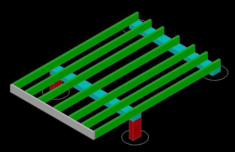

Onoff Posted September 12, 2019 Share Posted September 12, 2019 Just playing around with things here...you call it I can draw it! 4 circular plinths at 2.5m x 2.5m centres. Reds are 10"x5' notched to take the green 8'x2's. Blues are 8'x2's screwed to reds: MY preferred solution: red and blue are 10'x5', greens 8'x2', grey just an 8'x2' to cap the front off. Really well supported front end. Noggins not shown again (roughly shown at 400 ctrs). I can easily double up on the edge beams. Shout how you see it and I'll mod the sketch and even dimension. Link to comment Share on other sites More sharing options...

zoothorn Posted September 12, 2019 Author Share Posted September 12, 2019 @Onoff very cool indeed! I will be telling people its computer designed. Am I allowed to go your 2nd plan, but a different upper side: no BLUE sleeper under here, the outer beams lying on the plinths instead? If I go 8x2's then adding a "GREY cap" on this top end, would be one of my 4 cabin wall-loads-onto it. If so, the whole shebang drops down 5". As PeterW mentions water sitting on plinths & in contact with beams in this idea tho.. is there anything I could put between? If I go as per your 2nd plan, with big 8x2's I'm a full 7" higher than I'd anticipated: already it'll be fairly high off the ground (floor approx 60cm off the ground in front of the door). I think another 7" height & it'll look weird & perched up, & be tricky to hide its underneath area. Ideally I should have put the upper plinths set down 5".. but I was nervous to with the back plinth, in case steep earth bank above it misbehaved. Thanks- zoot Link to comment Share on other sites More sharing options...
Onoff Posted September 12, 2019 Share Posted September 12, 2019 Totally forgot about the 6"x6" suggestion mentioned earlier! ? I'm only one beer in as well. @PeterW mentioning getting the arse end of it up above the damp is very, very valid. I'd go as far as to say what you don't want to rot should be 150mm up from the plinths. That figure is how high house damp courses are nominally. Stems from how high the average rain drop will bounce I was told as an apprentice. I was figuring a reclaimed "proper" sleeper that was steeped in proper creosote back in the day would have been OK in direct contact with the plinth. @PeterW, how about a line of engineering bricks on those top plinths with a bit of dpc between them and any timber? Give me half hour (again). Link to comment Share on other sites More sharing options...
