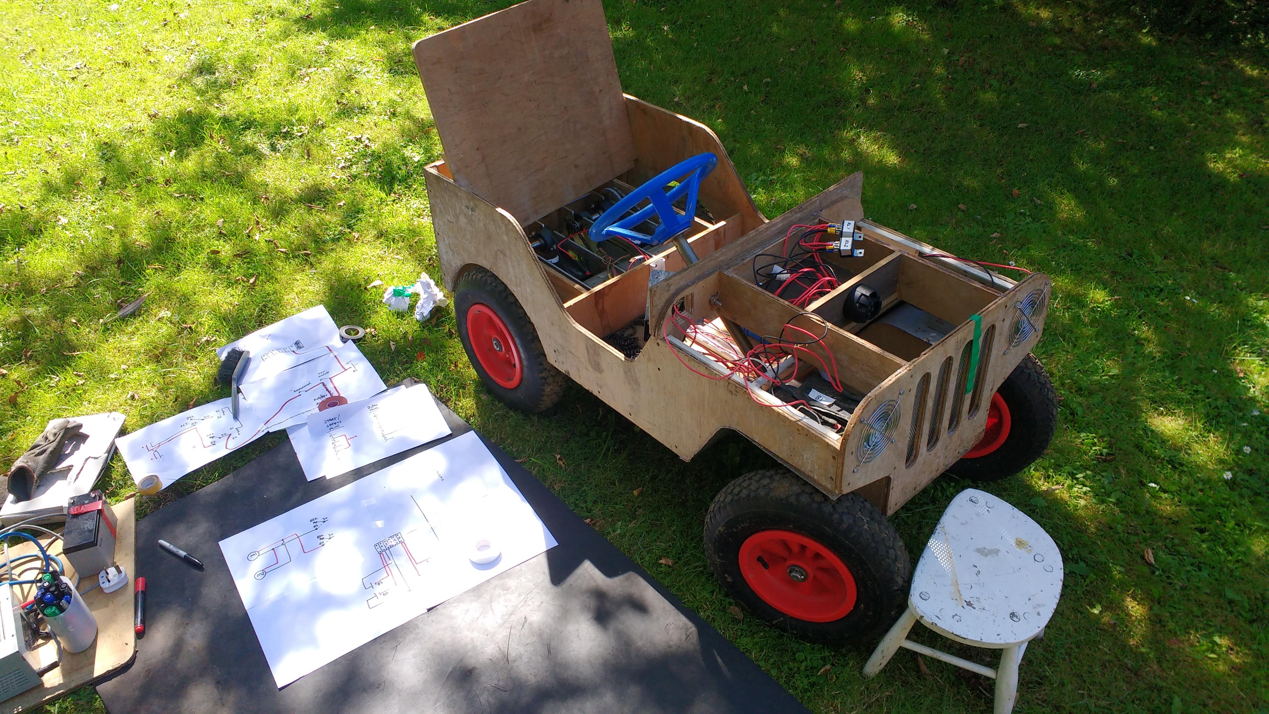

Done in a rush about 15+ years ago when work took precedence over children. Probably on the fly/back of a fag packet. (At work I'm totally anal about wiring diagrams being left in panels). Also I didn't number anything!
From memory the motors run on 24vdc (4 batteries) and the headlights on 12vdc (1 battery). The trailer plug allows charging of all 5 batteries at 12vdc via a golf cart charger. A link plug makes makes everything 24vdc again.
Can't find the wiring diagram if I even did one one for love nor money! :)

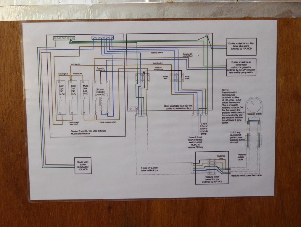

Inside the door of our water treatment shed:
I've also put together a folder with diagrams and explanatory notes for pretty much everything in the house.  Taken a fair bit of time to do, but I suspect it would take longer to try and work things out by reverse engineering them at a later date.

I'm impressed by @JSHarris's wiring diagram - did you do it on a dedicated application? Is there anything accessible available to make this easier?

I just drew it in AutoCad, not because that was the best application for this sort of stuff, really because it's on this PC and I've been using it for years, so it was the easiest option.  Pretty much any vector drawing application would do the job OK, preferably one that has a "grid snap" drawing option, as that makes it easier to get a reasonably tidy layout.

It seems to me that for moderately complicated household wiring and plumbing you need lots of diagrams of three sorts:
Logical: nice layout to understand the logic of the system with high voltage/pressure at the top, current flowing downhill, cause and effect going from left to right as is often used for electronic circuits.
Mechanical: showing the actual wiring with some indication of the layout, e.g., if there's a row of MCBs in a box then they're shown in a row on the diagram, as in @JSHarris's diagram in his water-treatment shed.
Geographical: showing where the wires actually run throughout the house.
At the same time software will need to know configuration information about the system. E.g., 1-wire sensor 28E3F2C7010000 measures the study radiator flow temperature. A key tenet of software engineering is the DRY principle [¹]  = don't repeat yourself. If there's one file to update when a change is made it might actually happen; if there are three or four then it's likely some will be missed some times and the whole lot will degenerate into a mess. So, what I'm envisaging is a single text file (maybe actually split into multiple files but processed as one) which sets up the software configuration and also produces various diagrams which could be printed or viewed online. The online views could be “live” in that they'd show actual states of temperature sensors, valves, pumps, batteries, etc, at least as far as the main computer knows them.

Left my lad to figure my wiring out, which he did. Slapped in a couple of 12V mower batteries in series. Must be 15 years since he's driven it. Can't find one of the drive chains at the mo so it's a bit slow.
