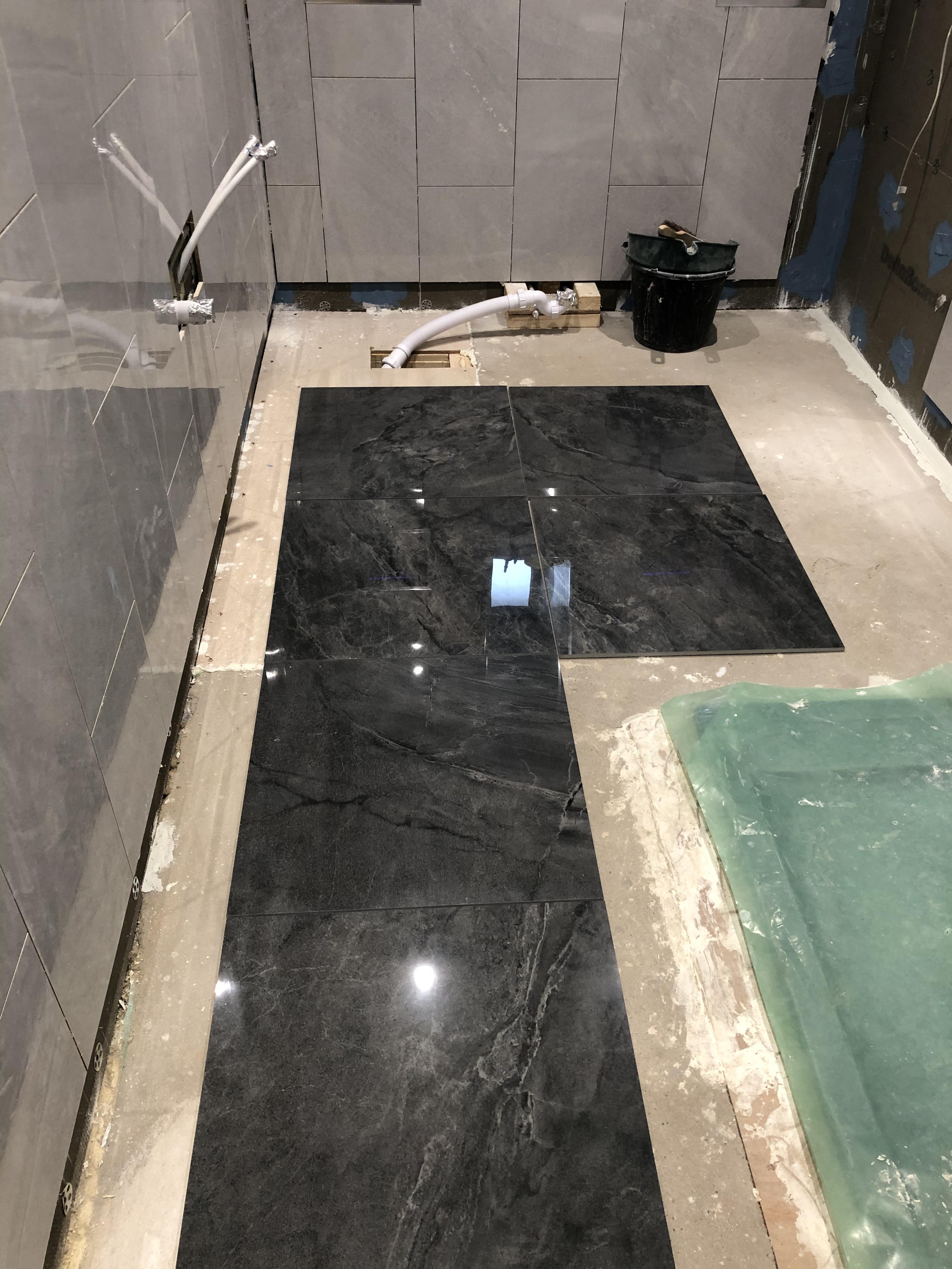

JFDIY Posted December 15, 2020 Posted December 15, 2020 Think I'd match the long side, won't the karzi and bath obscure a good chunk of the opposite side?
Pocster Posted December 15, 2020 Author Posted December 15, 2020 14 minutes ago, JFDIY said: Think I'd match the long side, won't the karzi and bath obscure a good chunk of the opposite side? Yeah they will . I did think that at first .....
Pocster Posted December 15, 2020 Author Posted December 15, 2020 Just now, pocster said: Yeah they will . I did think that at first ..... Hmmmm or the upstands could match the wall tile grout lines , but not the floor tiles ... Aaaarrrggghhhh ! ?
Pocster Posted December 15, 2020 Author Posted December 15, 2020 (edited) Right ! I’m going with @JFDIY ? So floor tiles and upstands Will line up on longest left wall . Right side floor tiles will end where ever . I’ll have to play with the upstands to see whether lining with wall or floor grout line looks best . Far wall all hidden by the bath . In reality 90% of all this isn’t visible but it feels SO important..... ? Edited December 15, 2020 by pocster
JFDIY Posted December 15, 2020 Posted December 15, 2020 2 hours ago, pocster said: In reality 90% of all this isn’t visible but it feels SO important..... ? But you'll forget all about it one done. The only time you'll consider the grout line is when sat on the toilet, and you won't be looking under your arm pit to see what's behind you, the one straight ahead will bug you the most. That said where does the lines fall around the shower tray. You may choose to be deliberately half a tile out if it fall better for the tray/bath and door into the room etc. 1
Pocster Posted December 15, 2020 Author Posted December 15, 2020 12 minutes ago, JFDIY said: But you'll forget all about it one done. The only time you'll consider the grout line is when sat on the toilet, and you won't be looking under your arm pit to see what's behind you, the one straight ahead will bug you the most. That said where does the lines fall around the shower tray. You may choose to be deliberately half a tile out if it fall better for the tray/bath and door into the room etc. Nothing good under my armpit ? Yeah I considered any upstands in the shower tray region get ‘ special treatment’ - so they will most probably be made to line up with wall grout ! I never had ocd - but since tiling I do ?
joe90 Posted December 15, 2020 Posted December 15, 2020 My vote is line up grout lines on the long wall which you will see when sat on the karzey. Trust me no one else will ever notice whatever you do (but you will?). 1

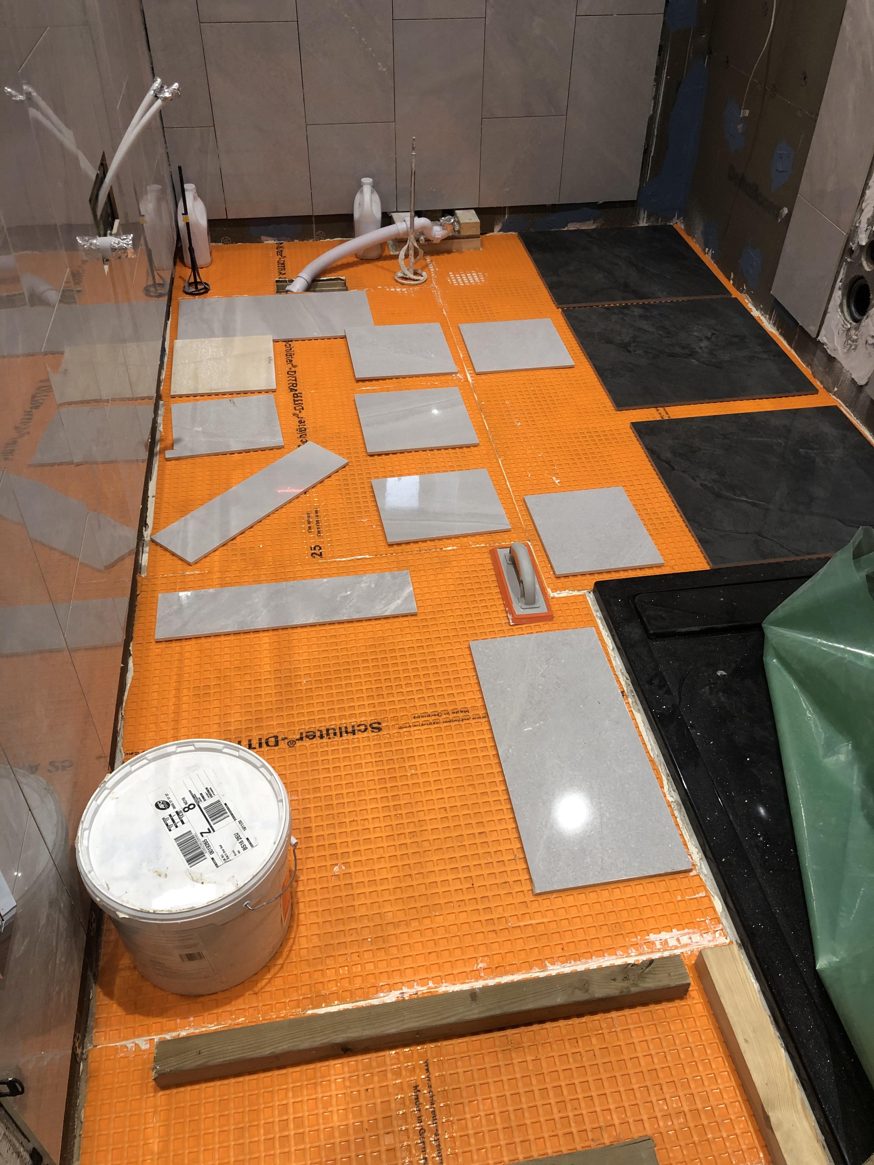

Pocster Posted December 16, 2020 Author Posted December 16, 2020 Decoupling mat down . I used Ardex 200 to glue it down . Wasn’t too sure on it at first . But as soon as the Mat underside touches it - it sticks !!! I notched it as it says - but tbh it doesn’t notch too well even after mixing it’s too loose . The matts certainly not coming up though ... 1

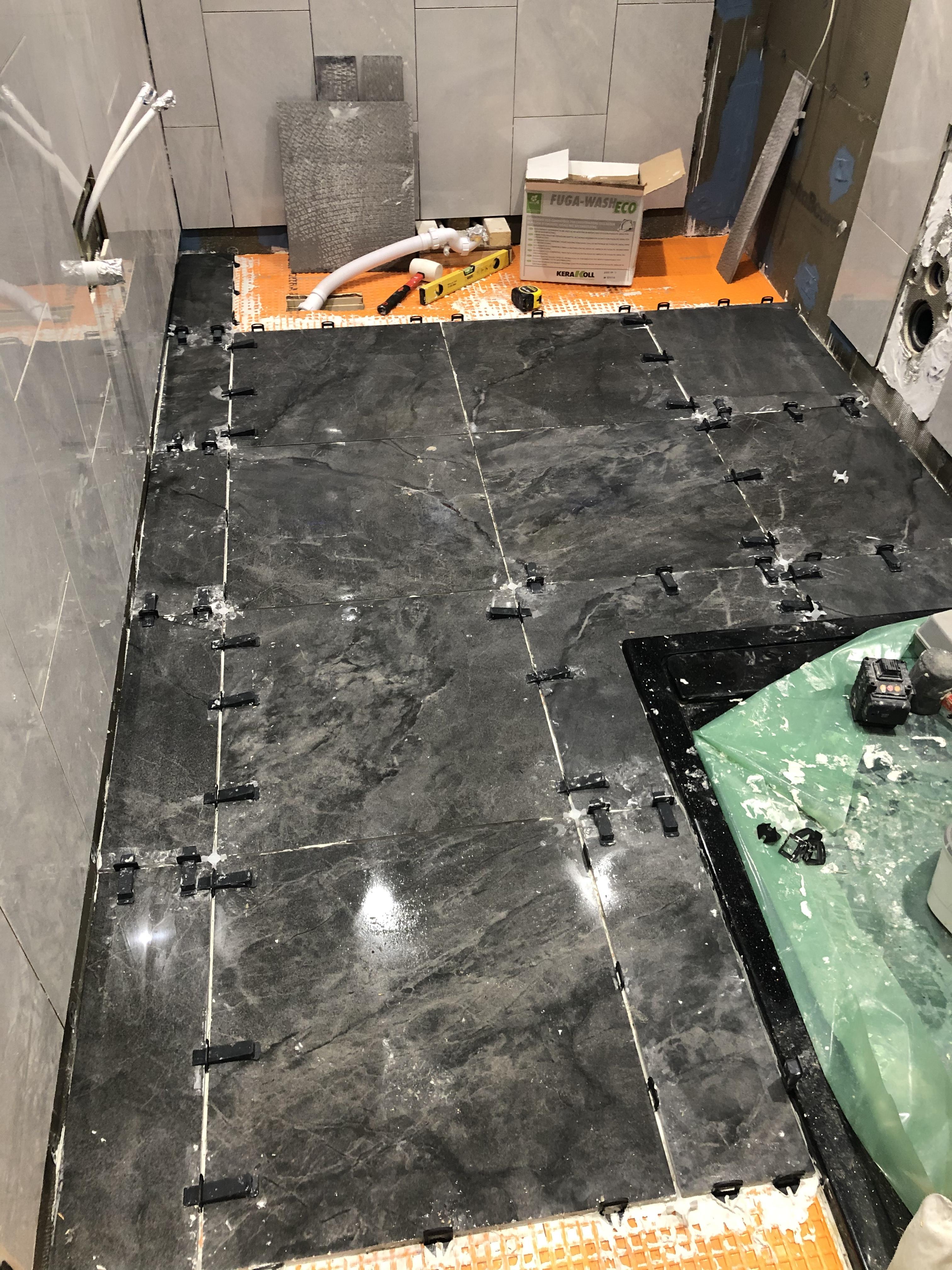

Pocster Posted December 21, 2020 Author Posted December 21, 2020 Surprisingly hard work ! First tile I faffed with . Forgot to back butter it . Didn’t come up easily and I would say 90% coverage . All back buttered now - they ain’t coming up . Slightly drift in the level a mm here or there . But I largely ignore and make sure no lippage 1
joe90 Posted December 21, 2020 Posted December 21, 2020 Looking good, now you have done the easy ones crack on with all the cut ones ? 1
Onoff Posted December 21, 2020 Posted December 21, 2020 1 hour ago, pocster said: lippage I dream of no lippage! 1 hour ago, pocster said: Slightly drift in the level a mm here or there . Get the LVT down and you won't notice it!

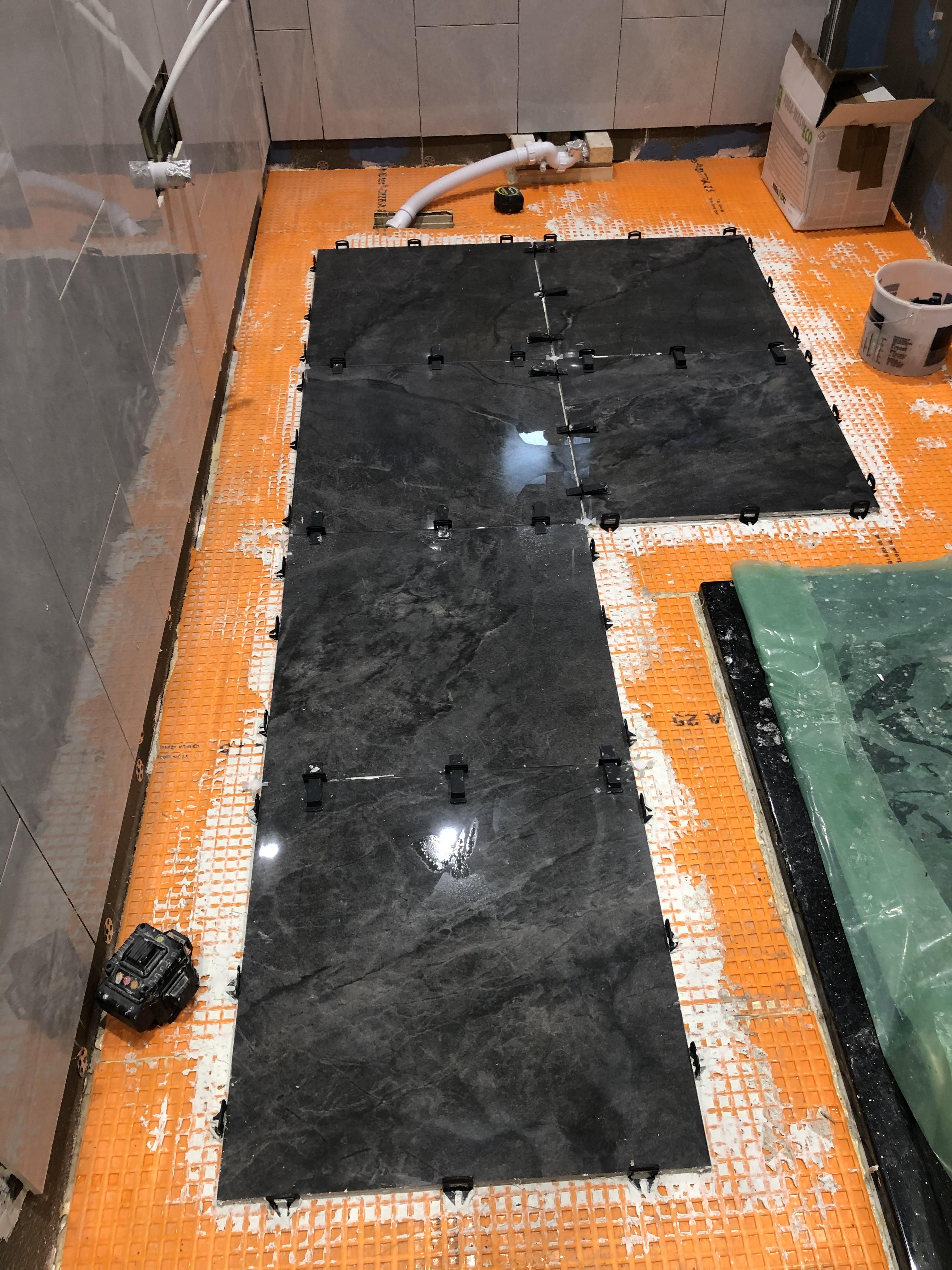

Pocster Posted December 22, 2020 Author Posted December 22, 2020 That was hard work ! My backs telling me to stop ( as is the thought of a glass of wine )
Gav_P Posted December 22, 2020 Posted December 22, 2020 Looking good. However, again with adhesive everywhere! Your porn film bathroom already looks like it’s had a day of heavy filming! 1 1
Pocster Posted December 22, 2020 Author Posted December 22, 2020 1 hour ago, Gav_P said: Looking good. However, again with adhesive everywhere! Your porn film bathroom already looks like it’s had a day of heavy filming! What you on about ! I wiped it down ! Must be the light ?
Gav_P Posted December 22, 2020 Posted December 22, 2020 3 minutes ago, pocster said: What you on about ! I wiped it down ! Must be the light ? Hope so because even that show tray looks like it’s had a visit from the bukaki train.
Gav_P Posted December 22, 2020 Posted December 22, 2020 Are you tiling under the bath? Has that been left clear for any particular reason? (Like being able to reach it without standing on recently laid tiles?)
Pocster Posted December 22, 2020 Author Posted December 22, 2020 18 minutes ago, Gav_P said: Hope so because even that show tray looks like it’s had a visit from the bukaki train. Dirty (expletive deleted)er
Pocster Posted December 22, 2020 Author Posted December 22, 2020 16 minutes ago, Gav_P said: Are you tiling under the bath? Has that been left clear for any particular reason? (Like being able to reach it without standing on recently laid tiles?) I am sorry . My back aches so I stopped for today . On it tomorrow- you my (expletive deleted)ing SWMBO or something??
