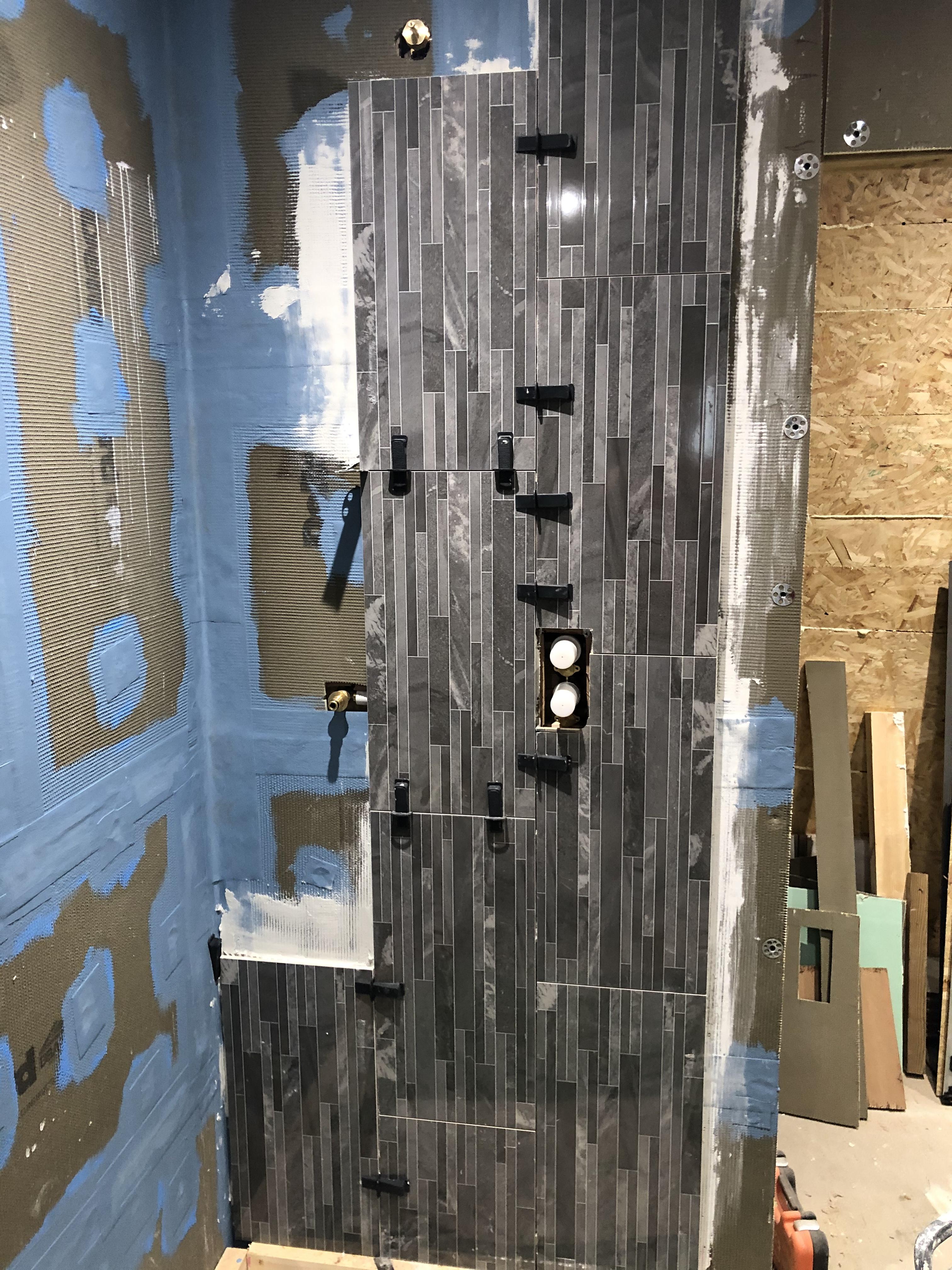

Pocster Posted October 27, 2020 Author Posted October 27, 2020 (edited) No advice from uncle Nick ? ? Edited October 27, 2020 by pocster
Nickfromwales Posted October 27, 2020 Posted October 27, 2020 8 minutes ago, pocster said: No advice from uncle Nick ? ? Not much you can say about those, other than put up and shut up or yank them off and change direction ( tile )? It would drive me nuts, but once it’s on you’ll just adjust and move on with your life. I have stuff in my bathroom that I did a less-than-perfect way, but I did do it over Xmas, and I was pissed most of the time I was tiling. 1
Pocster Posted October 27, 2020 Author Posted October 27, 2020 Just now, Nickfromwales said: Not much you can say about those, other than put up and shut up or yank them off and change direction ( tile )? It would drive me nuts, but once it’s on you’ll just adjust and move on with your life. I have stuff in my bathroom that I did a less-than-perfect way, but I did do it over Xmas, and I was pissed most of the time I was tiling. But I’m sober Uncle Nick ! Tbh Mummy says your best work is when you’re pissed . Back to Texas chainsaw then I guess - some lite relief ...

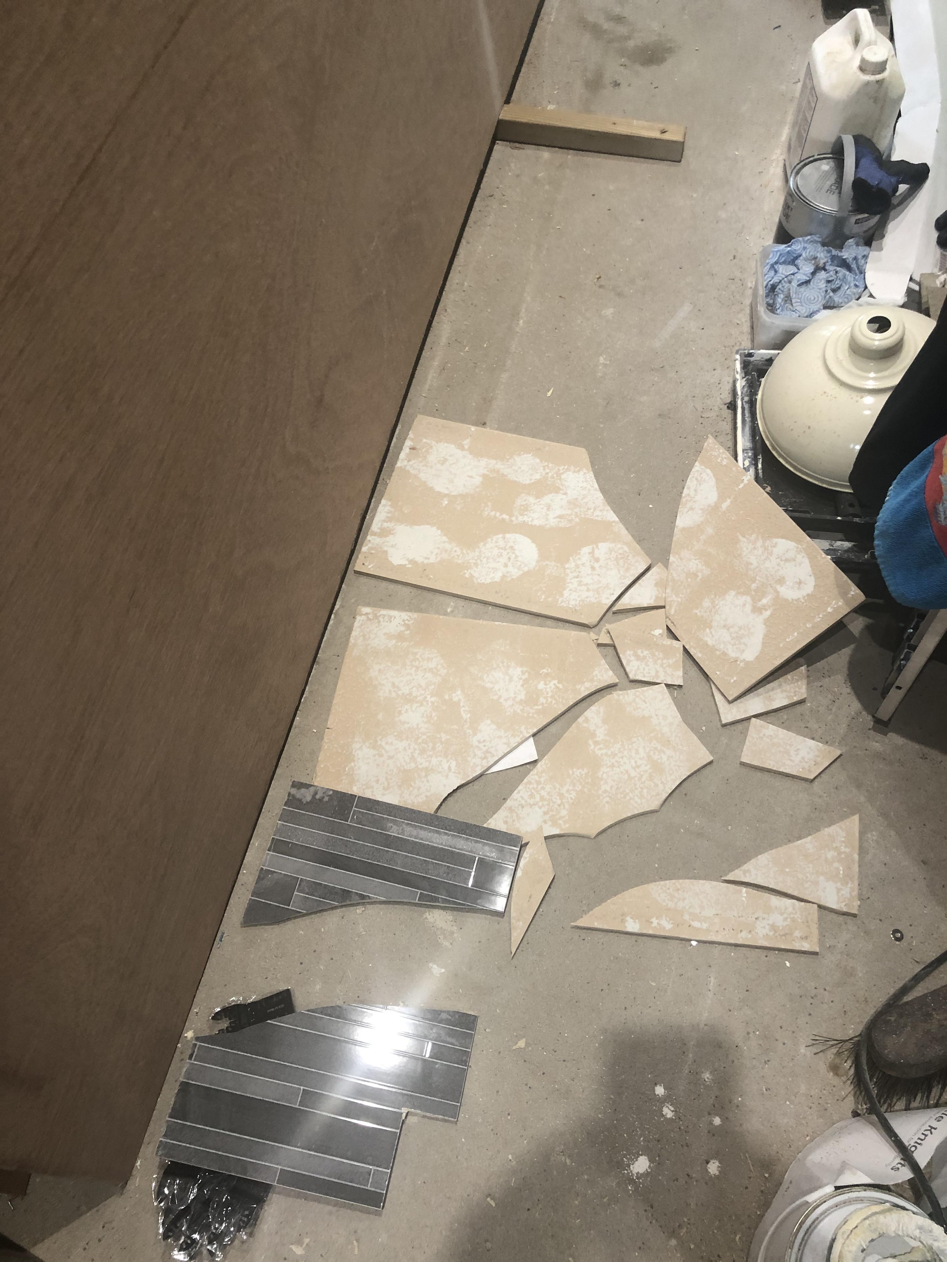

joe90 Posted October 28, 2020 Posted October 28, 2020 2 hours ago, pocster said: B*llocks ! Well, they didn’t line up anyway ? 1 1 1
Nickfromwales Posted October 28, 2020 Posted October 28, 2020 2 hours ago, pocster said: B*llocks ! You know that if you hadn’t done that, one of us would have come there and done it for you. See, a night off, and now some clarity. Buy some new tiles and make peace with your inner grouting line self. And breathe....... 1
Pocster Posted October 28, 2020 Author Posted October 28, 2020 (edited) 33 minutes ago, Nickfromwales said: You know that if you hadn’t done that, one of us would have come there and done it for you. See, a night off, and now some clarity. Buy some new tiles and make peace with your inner grouting line self. And breathe....... F rocking protagonistic vandals ! I hope all your showers piss water through your ceiling tonight ! Edited October 28, 2020 by pocster 1
Nickfromwales Posted October 28, 2020 Posted October 28, 2020 5 hours ago, pocster said: F rocking protagonistic vandals ! I hope all your showers piss water through your ceiling tonight ! Not going to happen. My pissed tiling is better than your sober ones ✌️?? 1

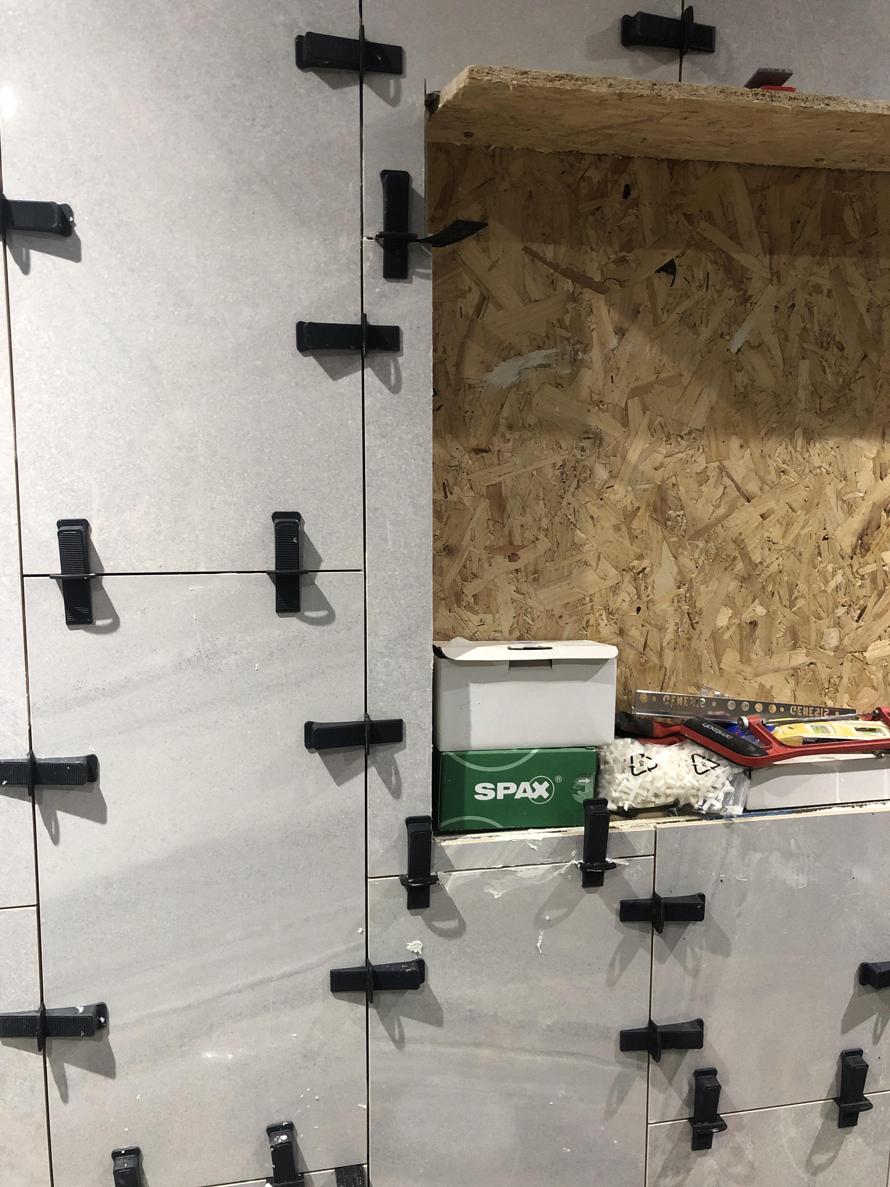

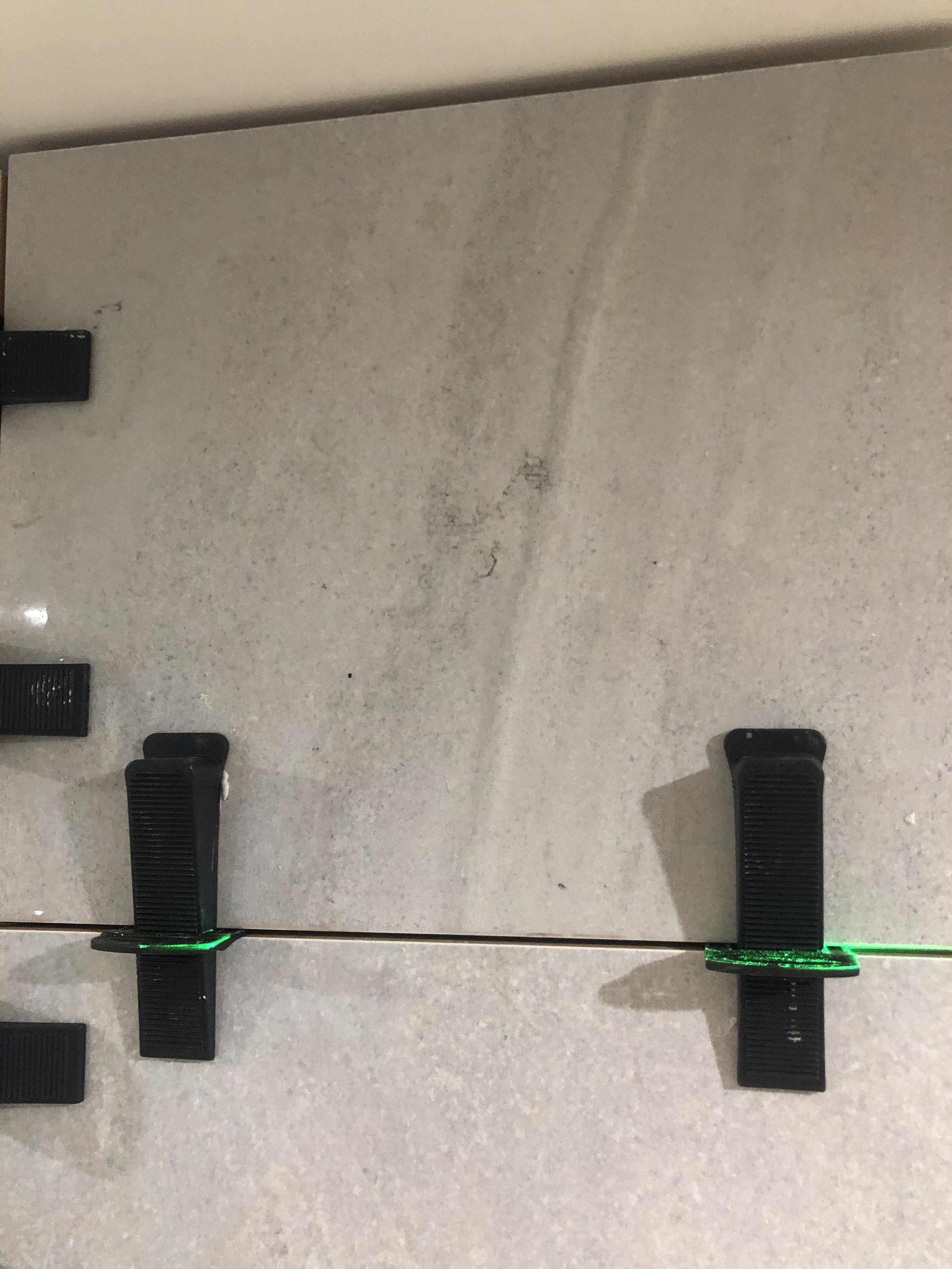

Pocster Posted November 2, 2020 Author Posted November 2, 2020 Doing ok today . Don’t like the gap between tile and ceiling . Sometimes just on the width of the tile ( 30cm ) the ceiling can be a good 5mm out - bloody plasterer ! . Assume there’s no shame in some simple white beading along the top to hide all this ...
Pocster Posted November 2, 2020 Author Posted November 2, 2020 3 minutes ago, Onoff said: Have you changed tile levelling system? Yes . These are MUCH better 1 1
Gav_P Posted November 2, 2020 Posted November 2, 2020 On 30/10/2020 at 11:54, pocster said: Feel almost like a pro today ! Those non-grout grout lines look loads better than before. ? 1
Mr Punter Posted November 2, 2020 Posted November 2, 2020 That looks a fair bit neater than the first one you did. Less adhesive in the grout gap. Can you promise not to use piss yellow grout this time? It that a very big l-shape to the left of the mirror or did you cheat? 1
Pocster Posted November 2, 2020 Author Posted November 2, 2020 2 minutes ago, Mr Punter said: That looks a fair bit neater than the first one you did. Less adhesive in the grout gap. Can you promise not to use piss yellow grout this time? It that a very big l-shape to the left of the mirror or did you cheat? Lol ! Grey grout already here ! How dare you sir ! How dare you suggest a cheat ! Not on my watch !!! 1

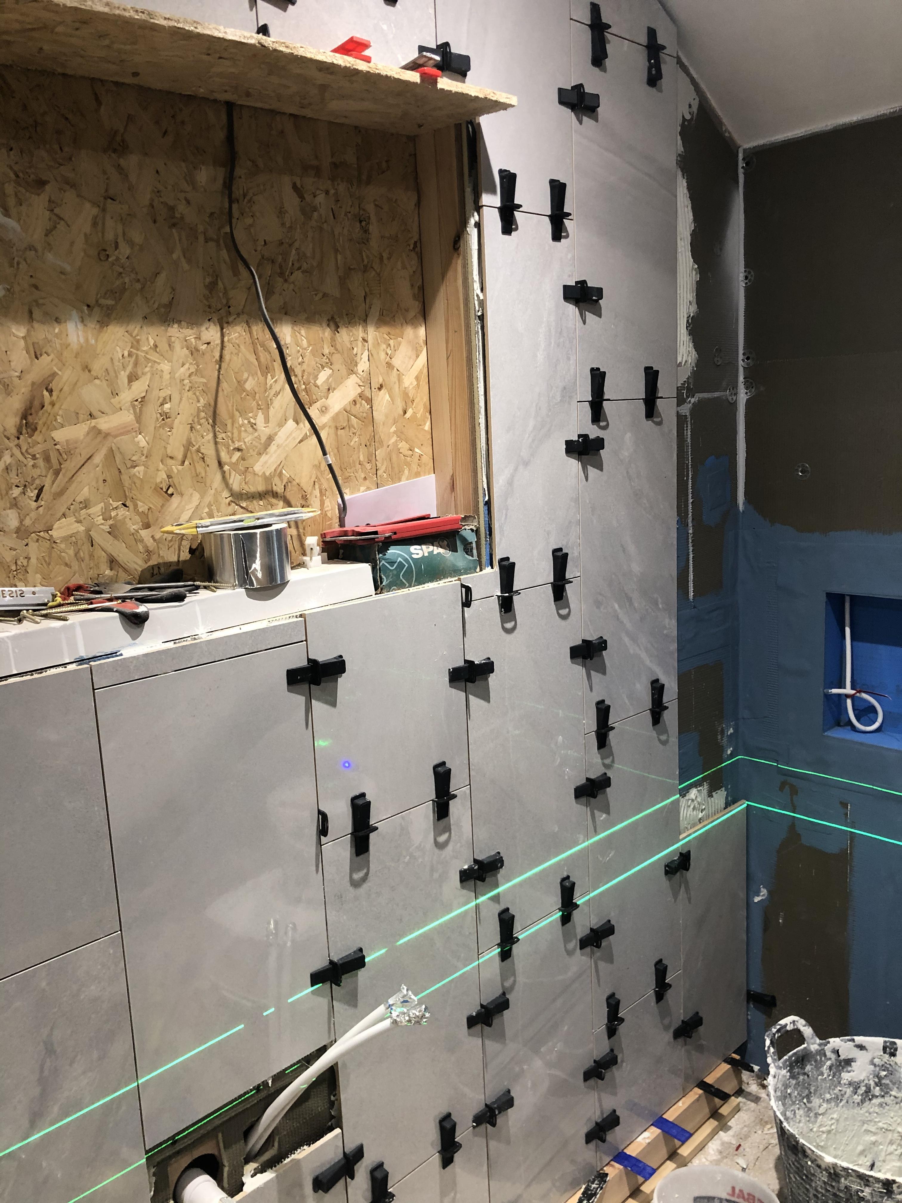

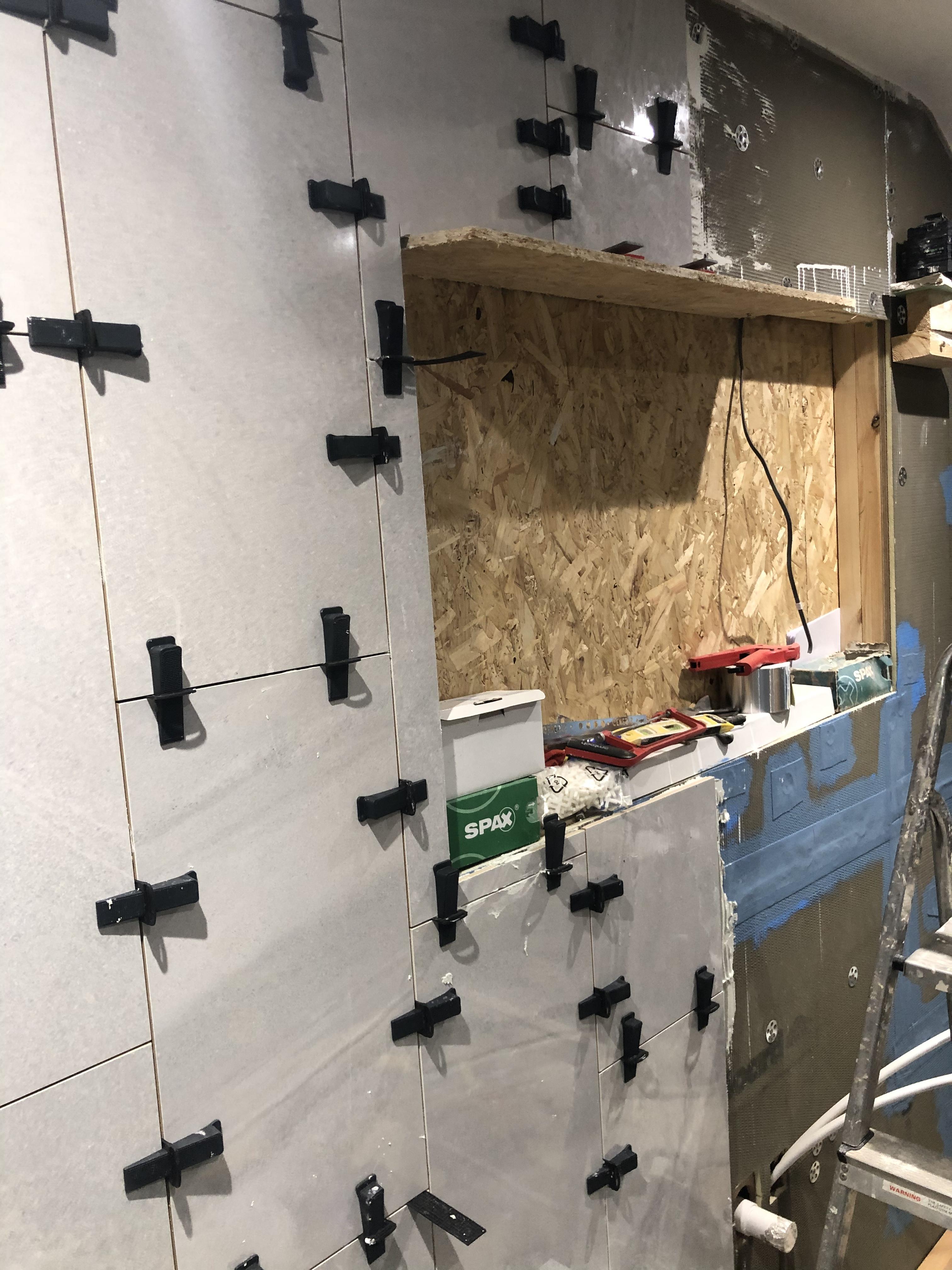

Pocster Posted November 3, 2020 Author Posted November 3, 2020 More and more .... Notice that though my wall was spirit level straight it is a bit out . So to keep tiles flat I simply beef up the adhesive behind them . Was worried about following a bendy wall ( max deviation about 5mm ) . , so don’t ?

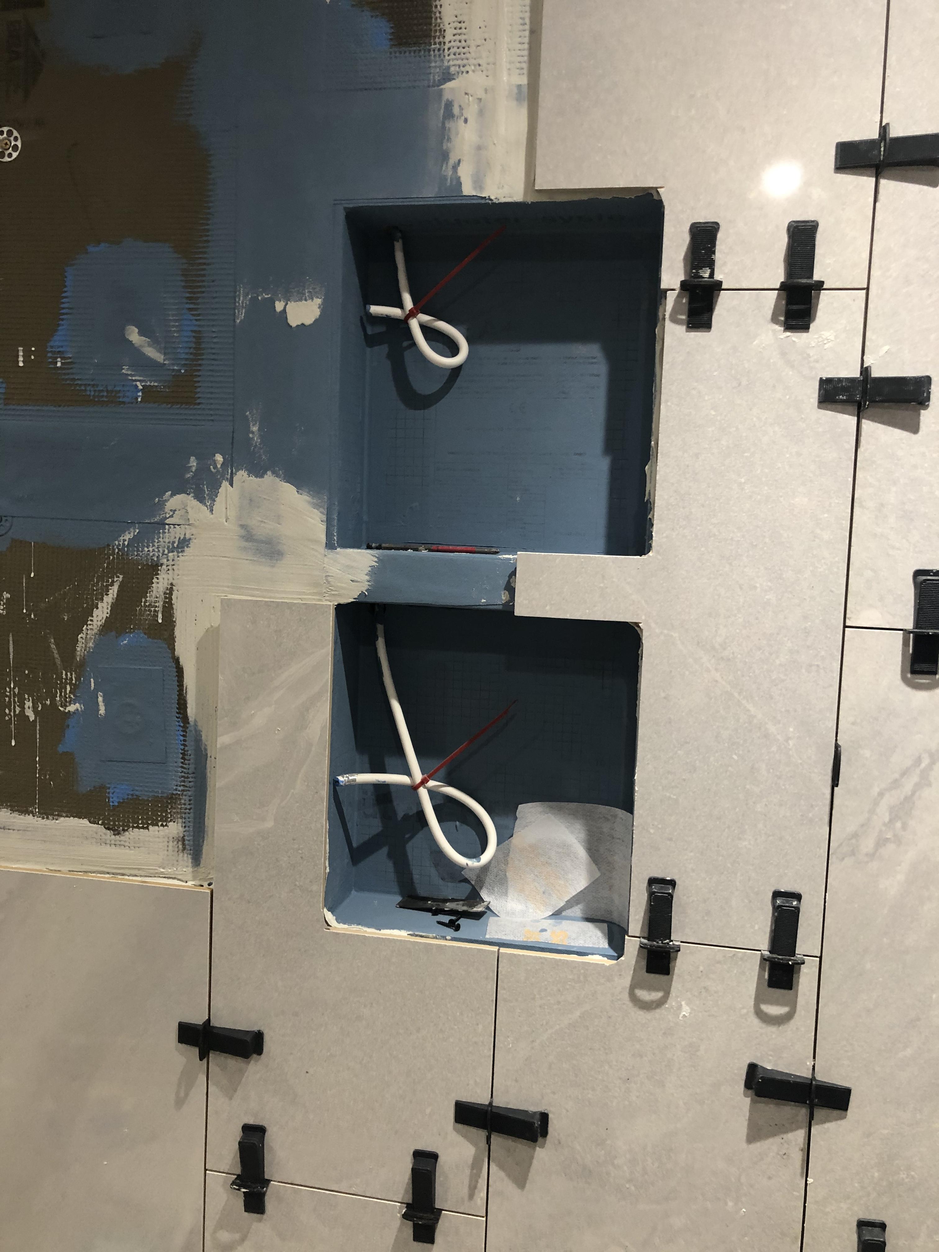

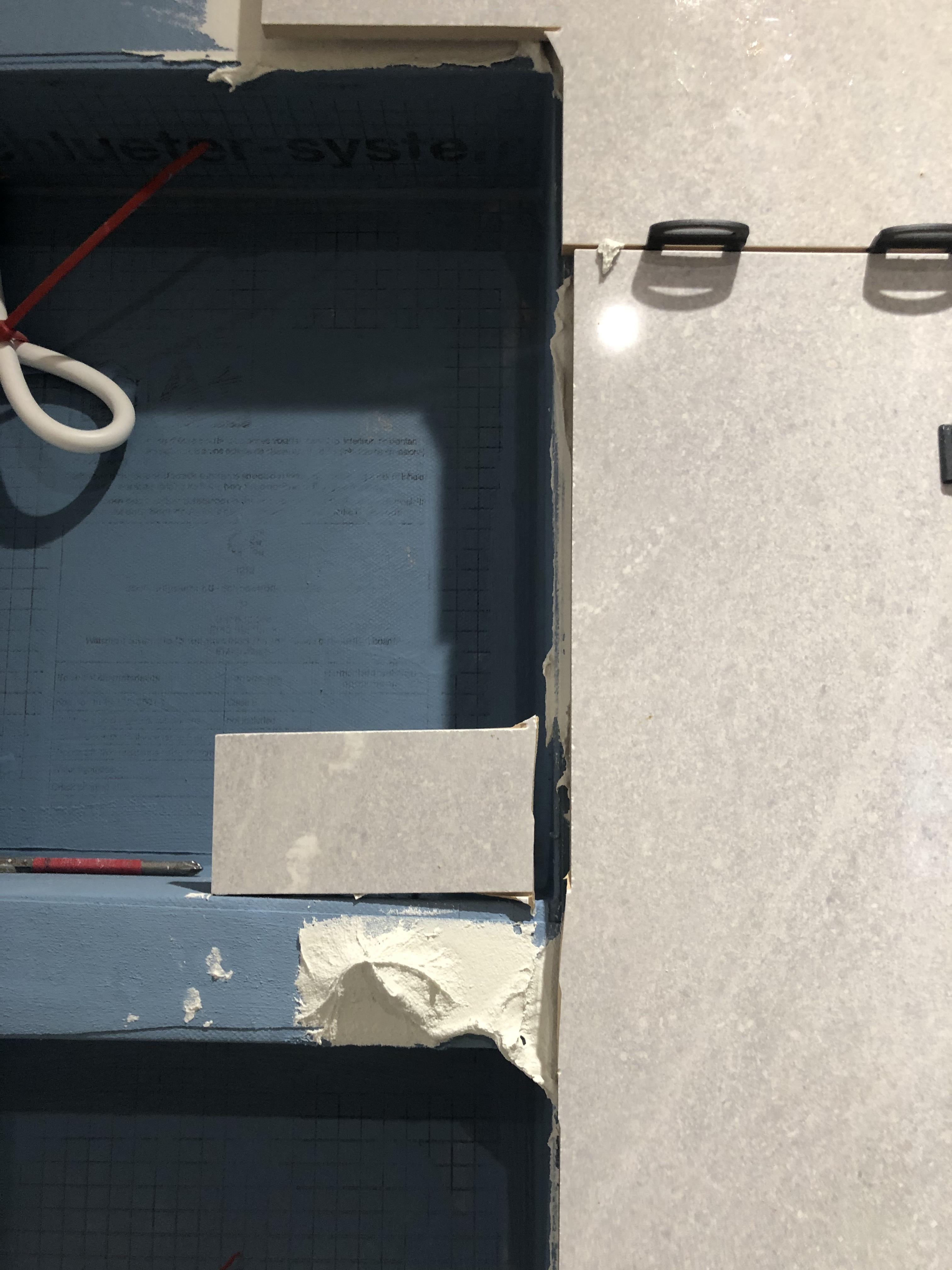

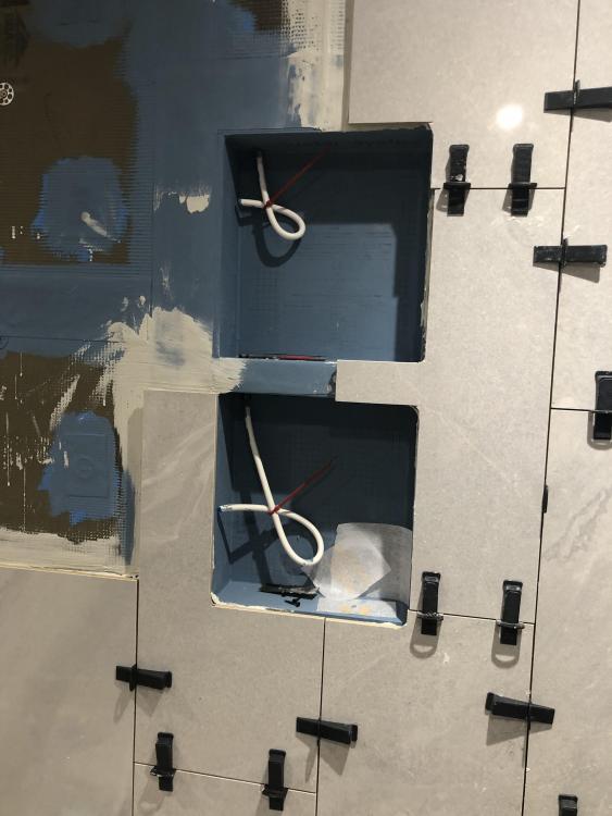

Pocster Posted November 4, 2020 Author Posted November 4, 2020 Struggling today ! First a snapped tile . ?? These recesses are a real pain ! I’ve done the tile cuts around them rough - so either spend hours dremelling them straight or much easier would be to find tile profile with a lip - so it ‘over hangs’ the tile edges - would make life much simpler !!
Pocster Posted November 4, 2020 Author Posted November 4, 2020 Maybe this type of thing ? https://www.protilertools.co.uk/product/genesis-aluminium-formable-tile-in-stair-nosing-nfa-2-6m-length--multiple-choice-of-colour--?gclid=CjwKCAiAv4n9BRA9EiwA30WND4KYlQXFyk8NXyLr6ic8G0Kw-LFlSSO_UP5gJbYElYs-pj1OwbD7thoCJQUQAvD_BwE Need nice pre made corners so no mitre cuts ...
Onoff Posted November 4, 2020 Posted November 4, 2020 19 minutes ago, pocster said: Struggling today ! First a snapped tile . ?? These recesses are a real pain ! I’ve done the tile cuts around them rough - so either spend hours dremelling them straight or much easier would be to find tile profile with a lip - so it ‘over hangs’ the tile edges - would make life much simpler !! FFS, the poshest tile cutter money can buy....are you not marking those tiles and cutting free hand to a marked line? Thank you, I feel so much better about my bathroom now. ?

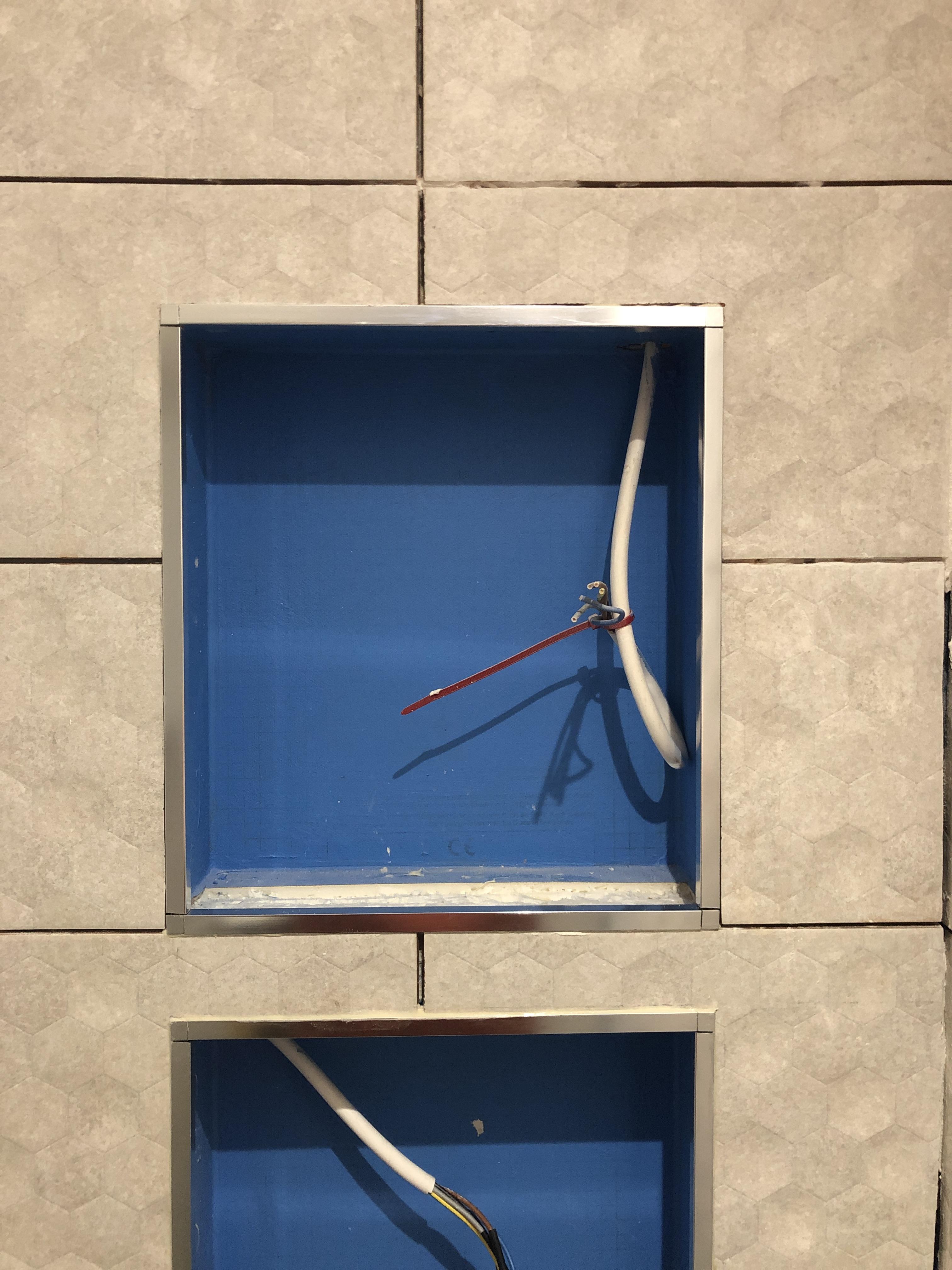

Pocster Posted November 4, 2020 Author Posted November 4, 2020 Just now, Onoff said: FFS, the poshest tile cutter money can buy....are you not marking those tiles and cutting free hand to a marked line? Thank you, I feel so much better about my bathroom now. ? Some of those cuts are dogs . So getting everything to line up just not going to happen . Also the recess boxes appear not to be as accurate as perhaps I would hope . Hence why a tile bead profile that covers the edges solves all the problems . This one in the ensuite took ages to get right with a dremel !!!
