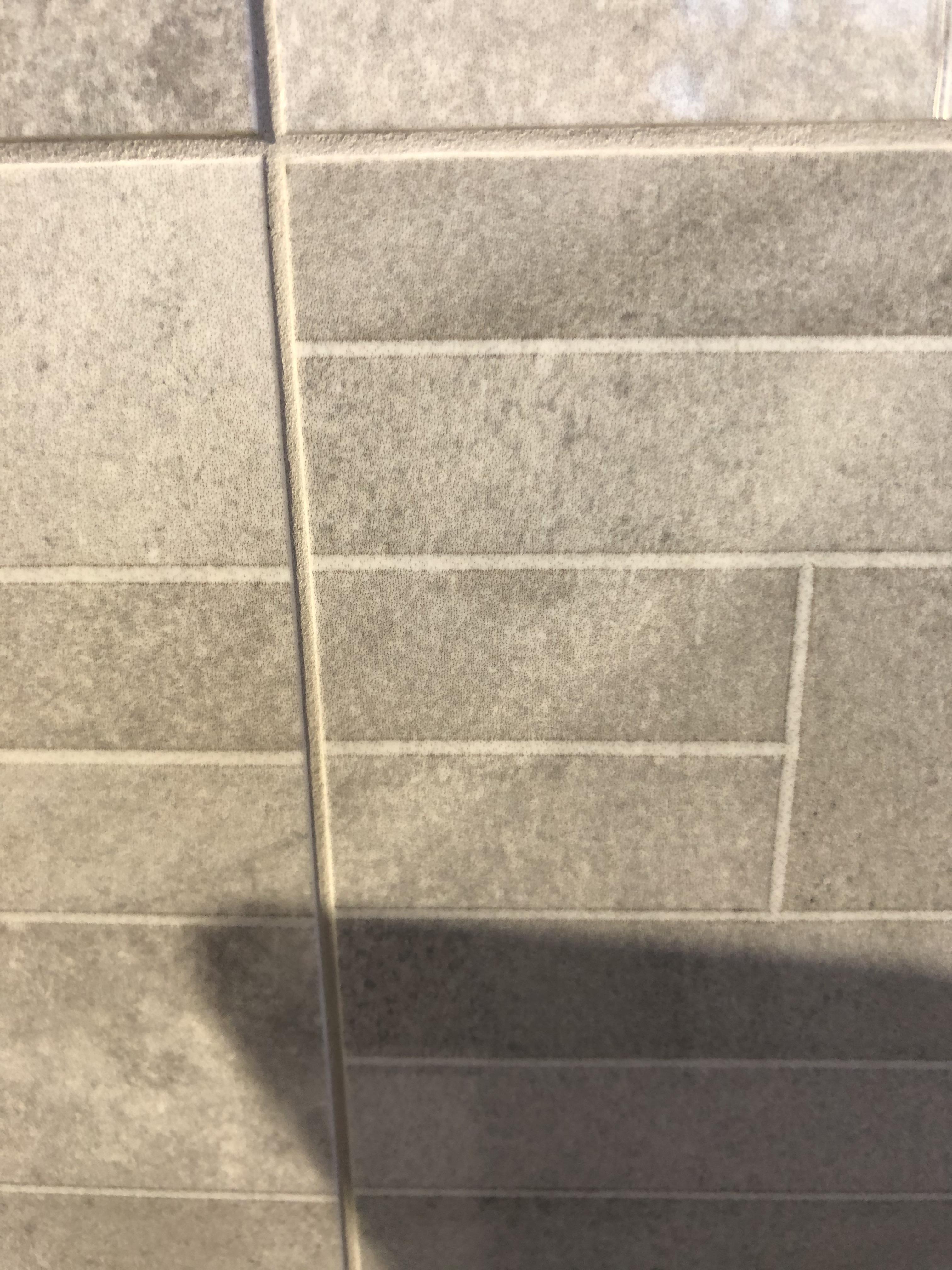

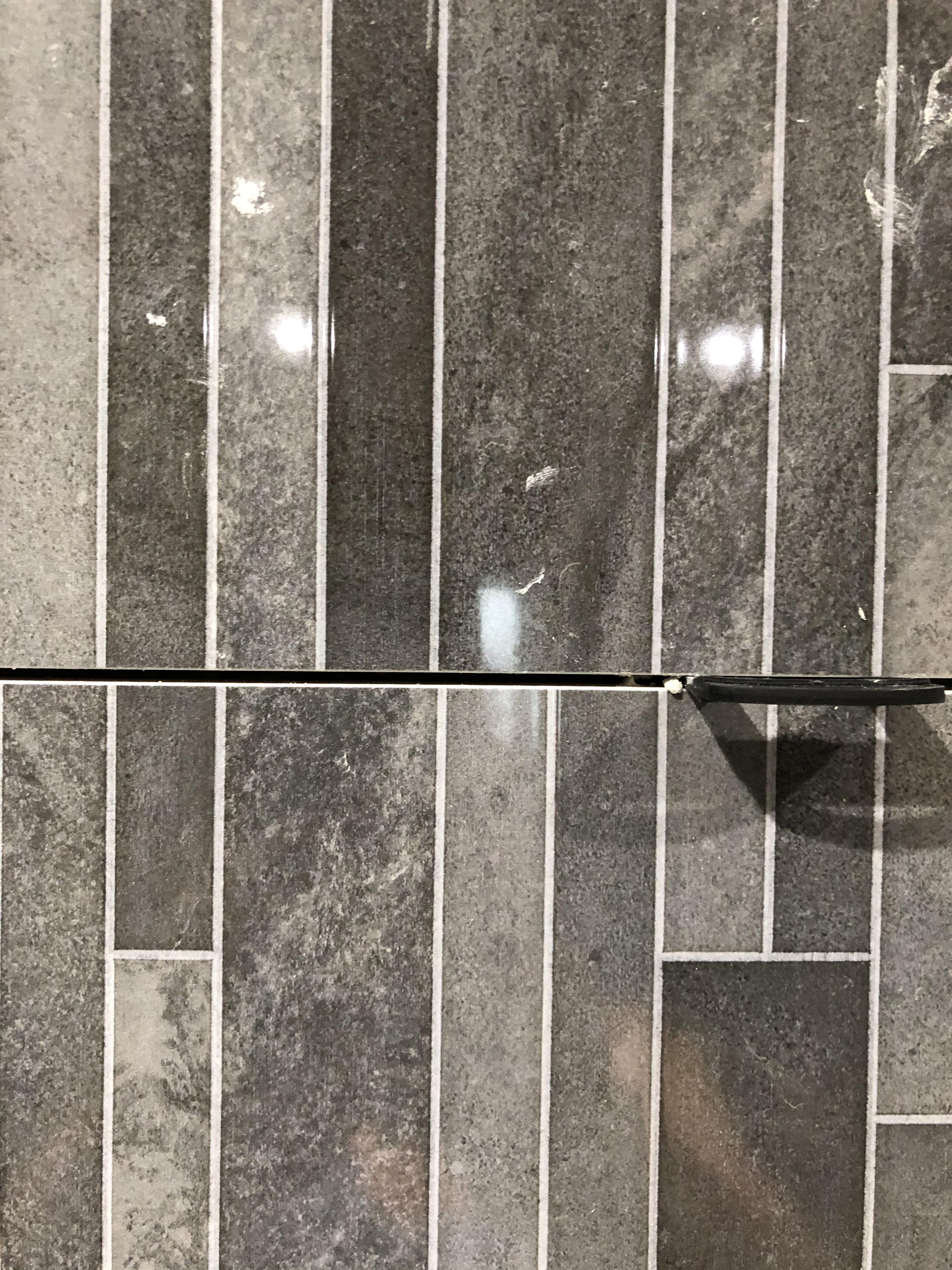

Pocster Posted October 27, 2020 Author Posted October 27, 2020 This is the same tile . It’s aligned I.e edge is straight - but to line pattern would push it out
joe90 Posted October 27, 2020 Posted October 27, 2020 (edited) No, sorry, could not live with that. That’s a bit like wallpaper with the pattern not lining up. ? Edited October 27, 2020 by joe90 1

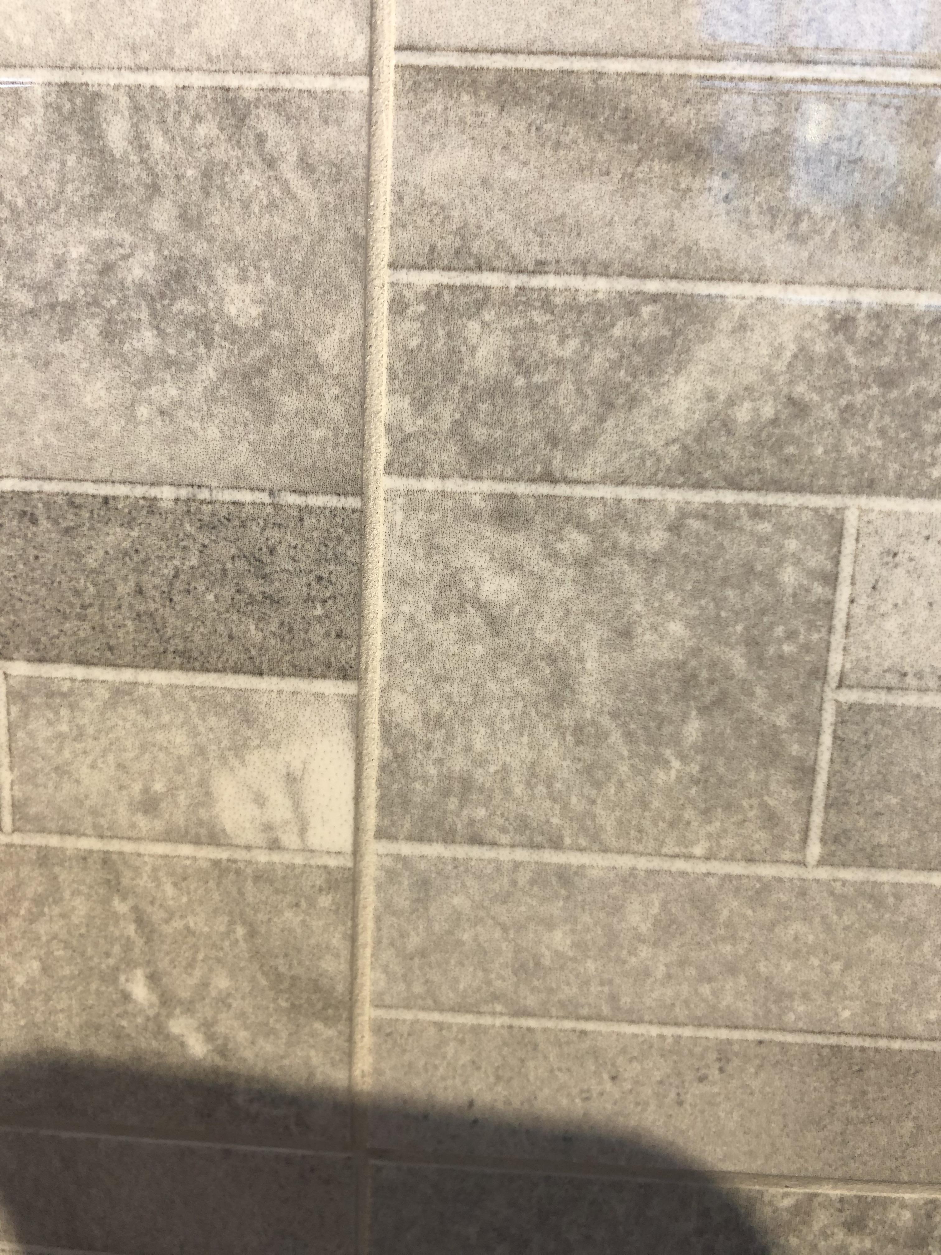

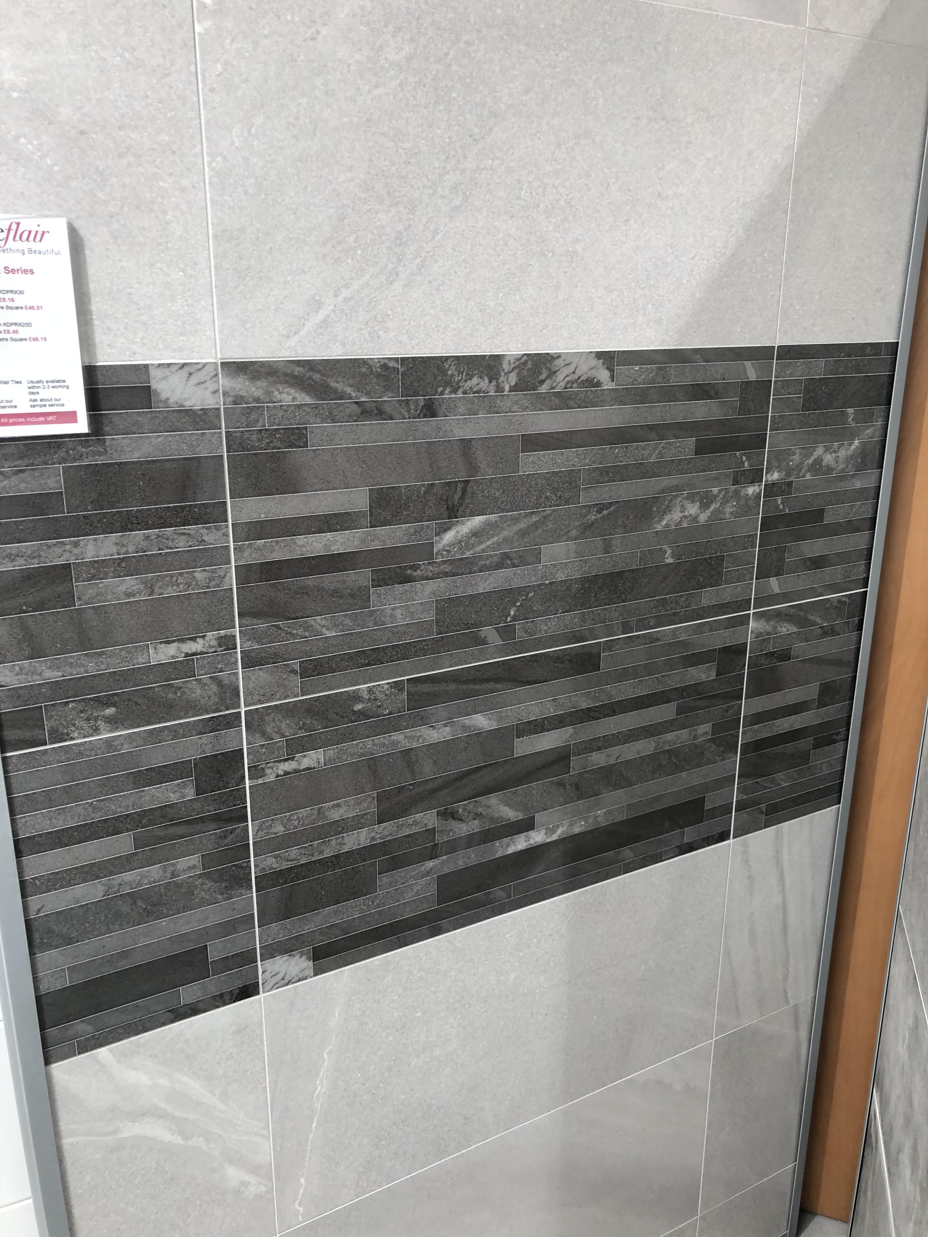

Pocster Posted October 27, 2020 Author Posted October 27, 2020 Right! Found a photo of them from the showroom . They run them horizontally. It’s hard to tell but I bet they add a mm or take a mm out to line them up .
Pocster Posted October 27, 2020 Author Posted October 27, 2020 I’ll have to live it . My grout lines being inline more important. ?
joe90 Posted October 27, 2020 Posted October 27, 2020 (edited) They line up ok, are yours from the same batch number? Edited October 27, 2020 by joe90
Pocster Posted October 27, 2020 Author Posted October 27, 2020 2 minutes ago, joe90 said: No, sorry, could not live with that.? Nothing I can do ! There is no right orientation or pattern that tessellated
Pocster Posted October 27, 2020 Author Posted October 27, 2020 Just now, joe90 said: They line up ok, are they from the same batch number? Yep . Same box !!
joe90 Posted October 27, 2020 Posted October 27, 2020 Perhaps it’s me but that’s not acceptable in my book, sorry, don’t mean to rain on your parade but I would be getting in touch with Tile Flair about that (before the glue goes off!!!,!).

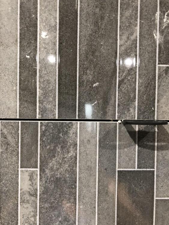

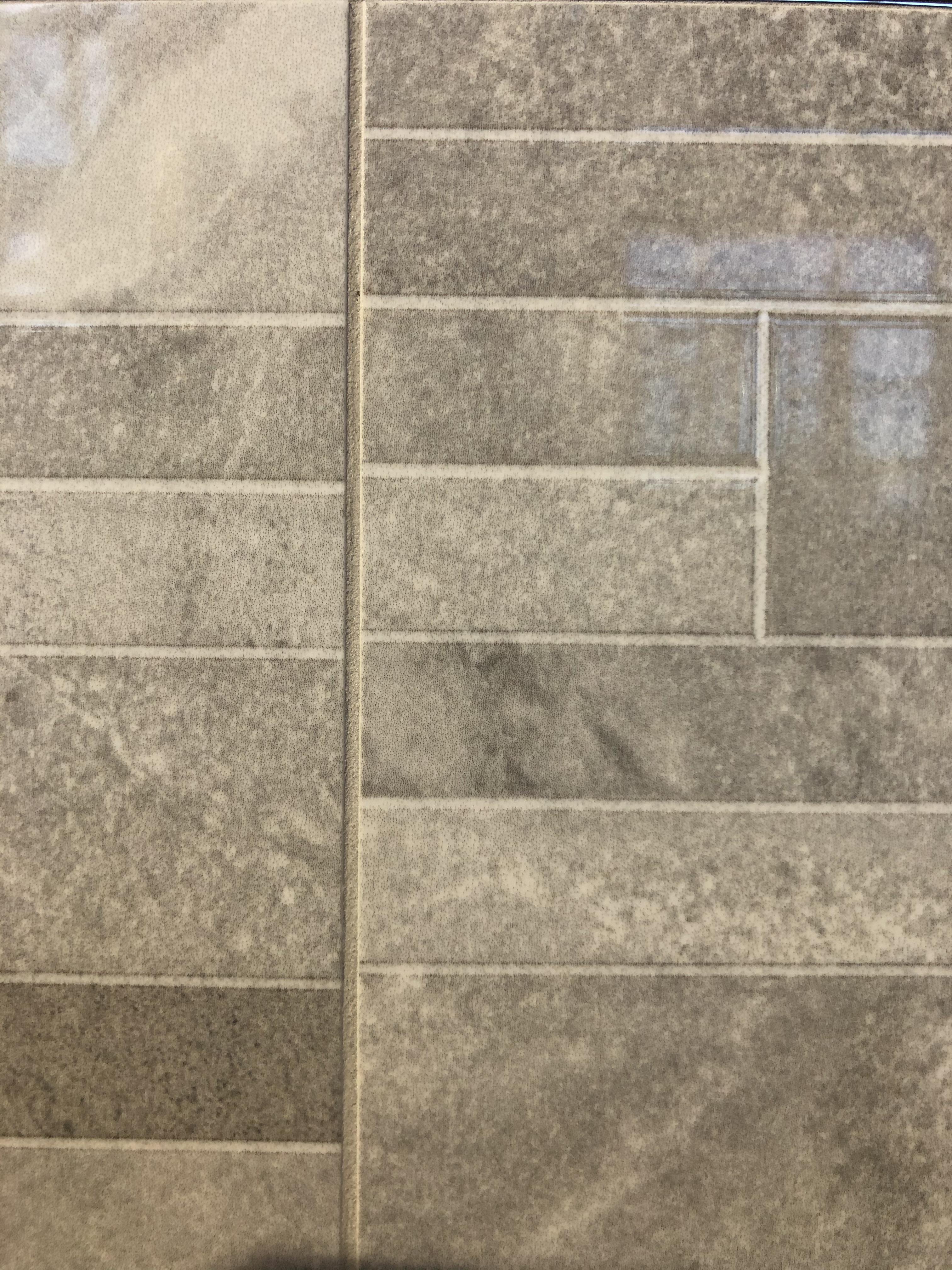

Mr Punter Posted October 27, 2020 Posted October 27, 2020 OK the showroom has laid the tiles correctly. You have not. Your top tile need rotating 180 deg. So does the bottom one.
Mr Punter Posted October 27, 2020 Posted October 27, 2020 The tiles have double and single width stripes. They need to butt up to the same width stripes, then you know it is the correct way round. 1
Pocster Posted October 27, 2020 Author Posted October 27, 2020 2 minutes ago, Mr Punter said: OK the showroom has laid the tiles correctly. You have not. Your top tile need rotating 180 deg. So does the bottom one. ???? The show room ones appear to have no order
Mr Punter Posted October 27, 2020 Posted October 27, 2020 Just now, pocster said: ???? The show room ones appear to have no order Yes they do. The correct order.
Pocster Posted October 27, 2020 Author Posted October 27, 2020 14 minutes ago, Mr Punter said: The tiles have double and single width stripes. They need to butt up to the same width stripes, then you know it is the correct way round. Thought you had it then ... but !!!

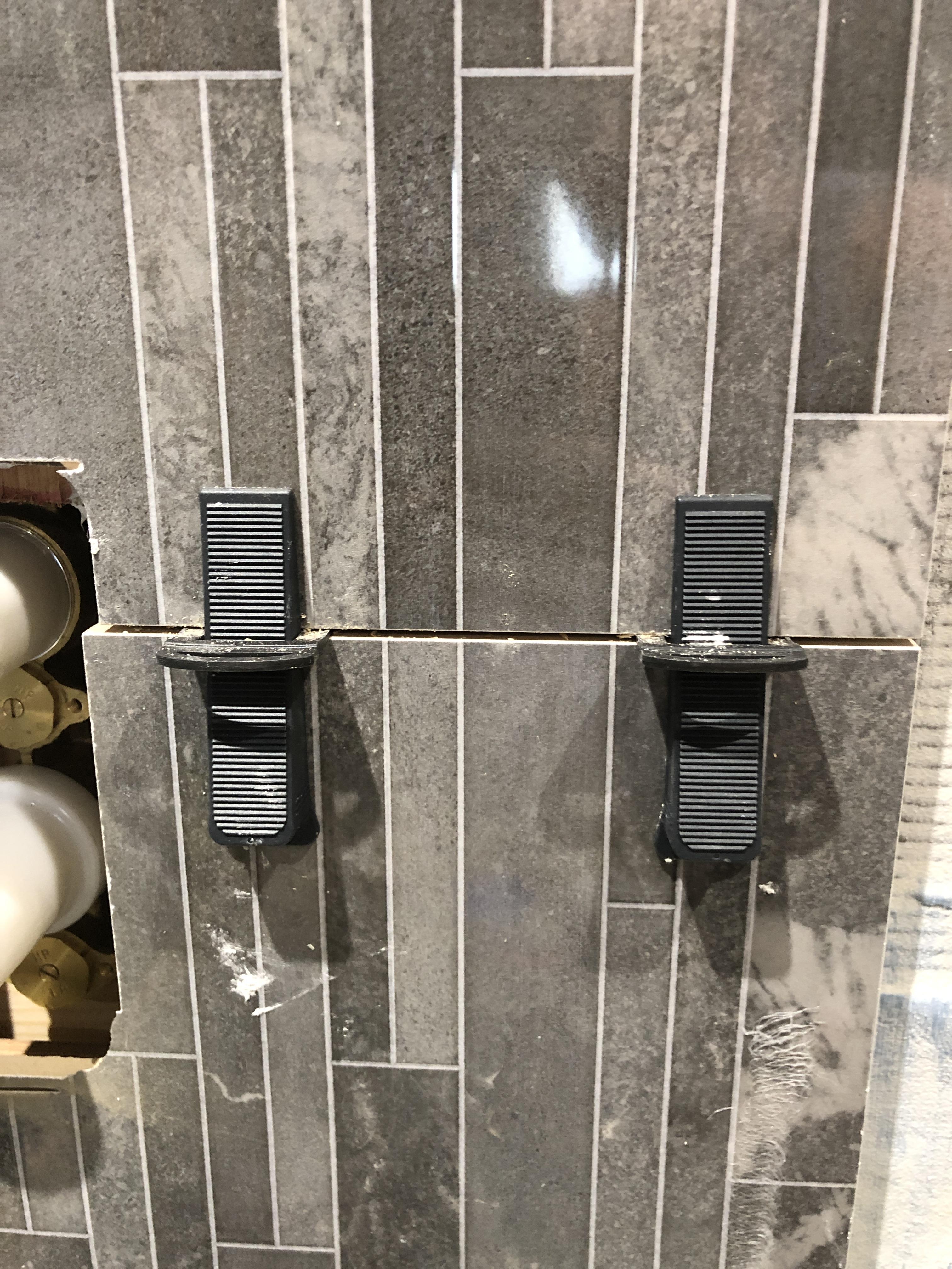

wozza Posted October 27, 2020 Posted October 27, 2020 I have to agree with the majority, something just aint right and it would annoy my OCD. Take them all off and clean off the adhesive, then play around to see if they can be made to line up. 1
joe90 Posted October 27, 2020 Posted October 27, 2020 (edited) 4 minutes ago, wozza said: see if they can be made to line up. And if not return them as not fit fir purpose. (Not far to cribbs from you) ? Edited October 27, 2020 by joe90

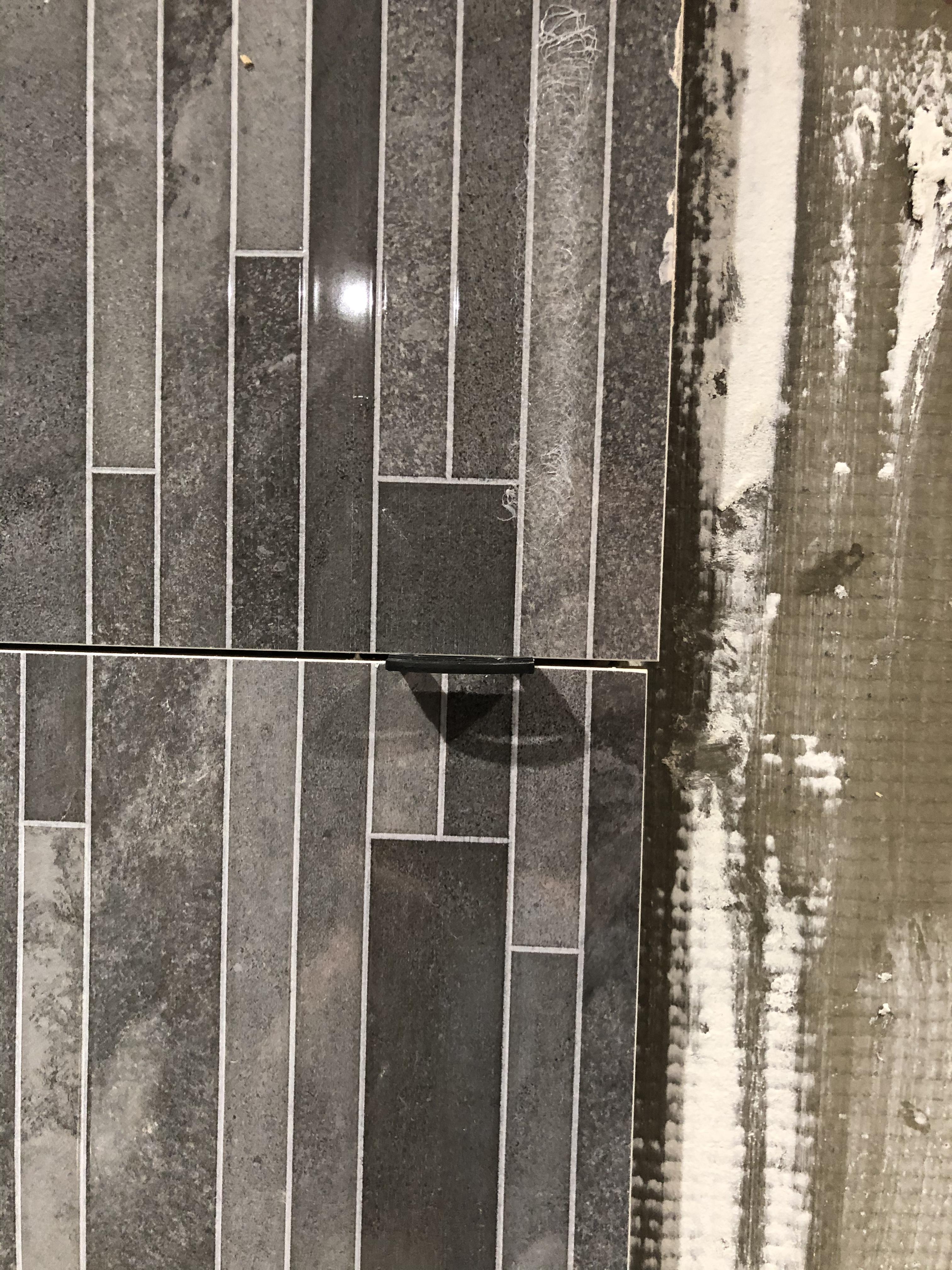

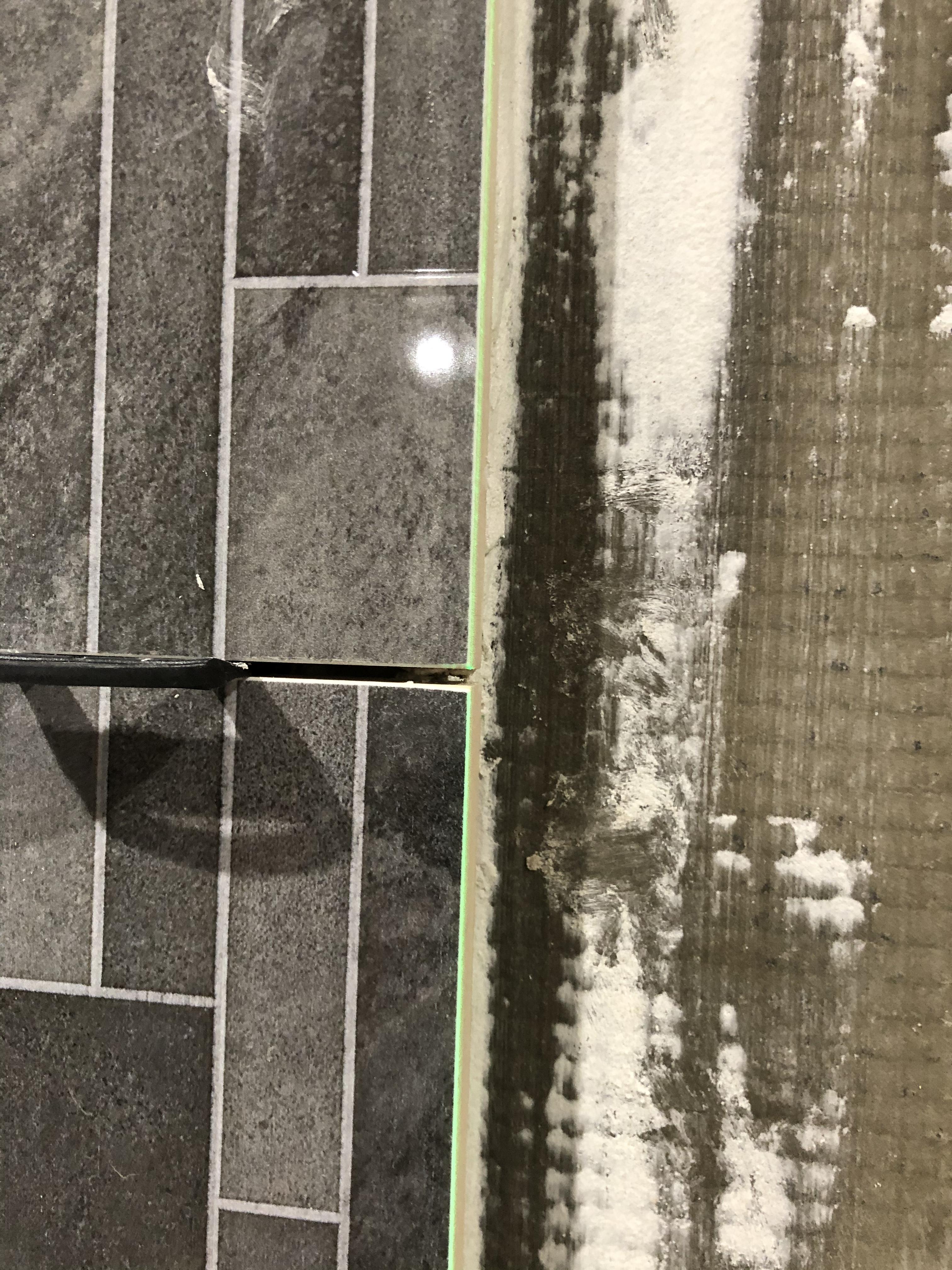

Pocster Posted October 27, 2020 Author Posted October 27, 2020 21 minutes ago, Mr Punter said: Yes they do. The correct order. Can’t see any order Took the highest tile off and cut it they other way round ( only 2 possibilities ) neither line up - but one is ‘better’ than the other . Tried other boxes aswell - same issue
Mr Punter Posted October 27, 2020 Posted October 27, 2020 Maybe Uncle Nick tiled the showroom? If they don't work either way, take them back and get something else. 1
Pocster Posted October 27, 2020 Author Posted October 27, 2020 Just now, Mr Punter said: Maybe Uncle Nick tiled the showroom? If they don't work either way, take them back and get something else. Yeah but some are stuck on the fing wall ? Have emailed the showroom . Going to clear a space and try and do a vertical line on the floor - ffs !!! Strangely I do get the ‘random’ line up ! I bet their horizontal grout lines vary in width to solve this in the fing showroom ....

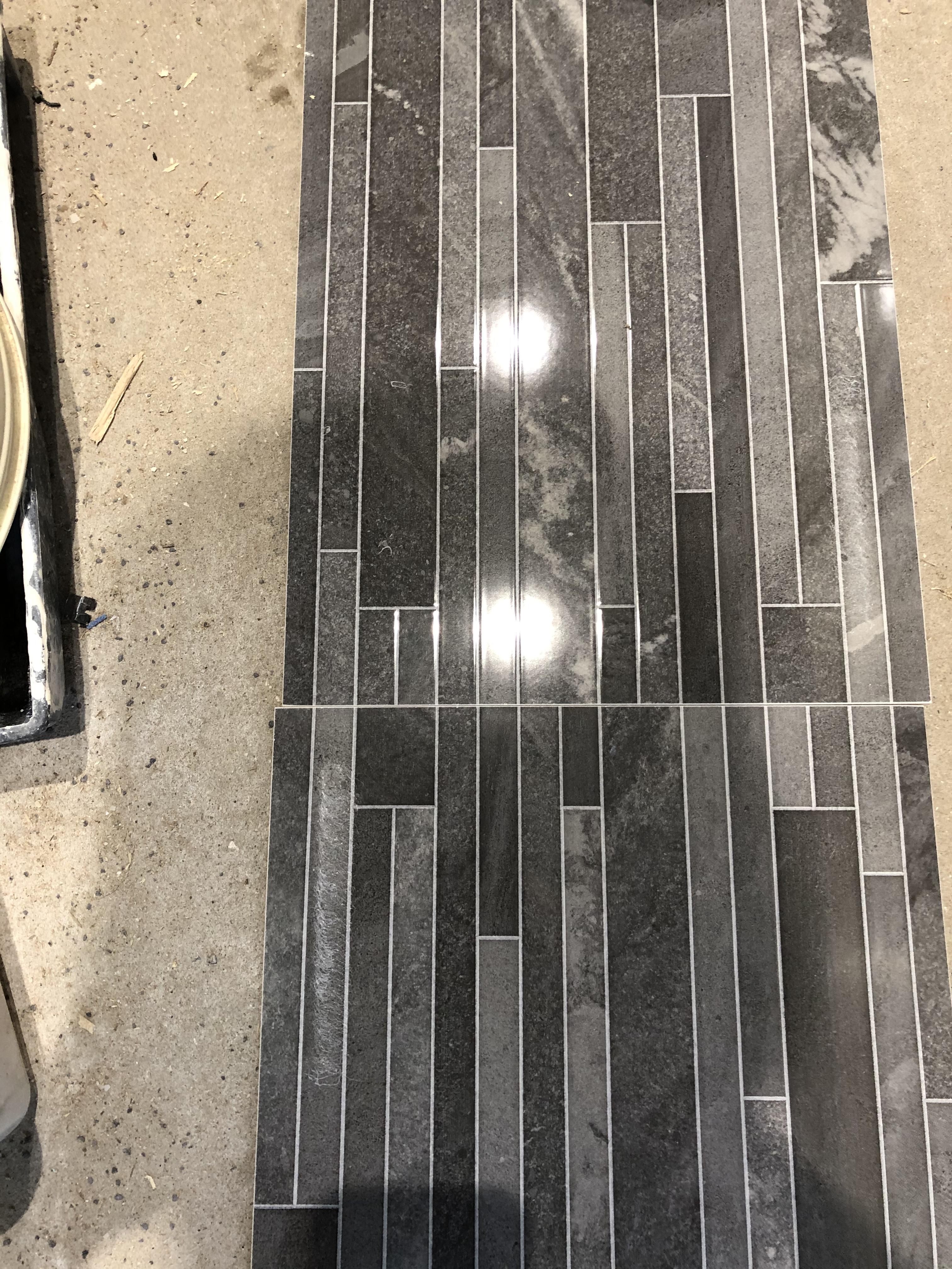

Pocster Posted October 27, 2020 Author Posted October 27, 2020 Right ! Tiles on the floor . Just rotating the last one - wrong both ways !!! Ffs !

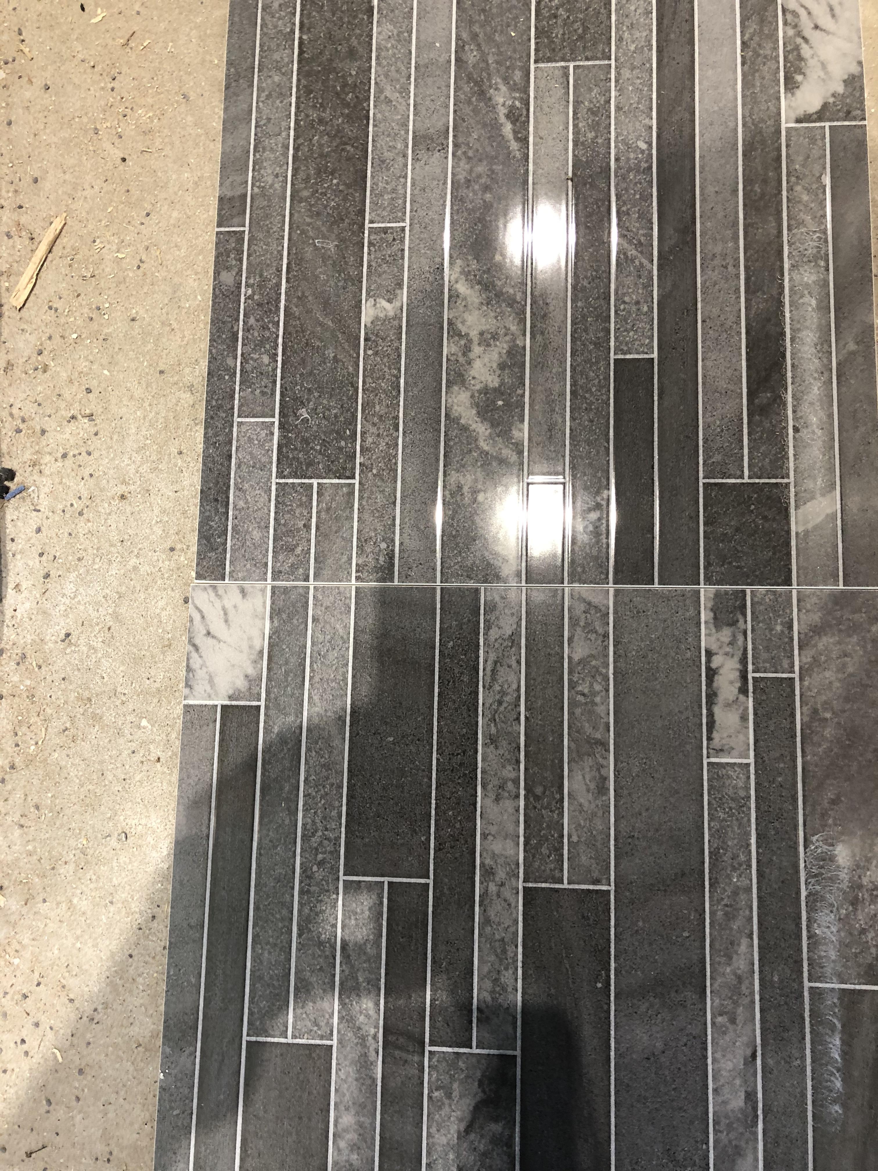

Pocster Posted October 27, 2020 Author Posted October 27, 2020 16 minutes ago, Mr Punter said: Second one looked a lot better. On my floor ones ? I agree - but it’s still out . If I grouted it - would look sh*t Managed to get through to tileflair - boss is going to call me ! 2
Pocster Posted October 27, 2020 Author Posted October 27, 2020 Right TileFlair manager called me. She was very good actually. This title simply does not line up. Manufacturers are allowed a 3mm +/-. She was happy for me to change tiles for something single coloured or the same design but paler i.e. so it would be less obvious. She did confess that no-one does it vertically - so I am truly DA MAN! Even so, she opened whilst I was on the phone; a different batch number and laid them out on the floor - exactly the same issue. Can I live with it???. Her only suggestion to get the effect I want was to use mosaics ( on that yucky mesh stuff - where you've got to be spot on when you bed it! ) Kindly she sent me photo's of their in store displays - also stating no one has ever mentioned it - ( I've got fecking OCD now haven't I - caught it from you twats !)
