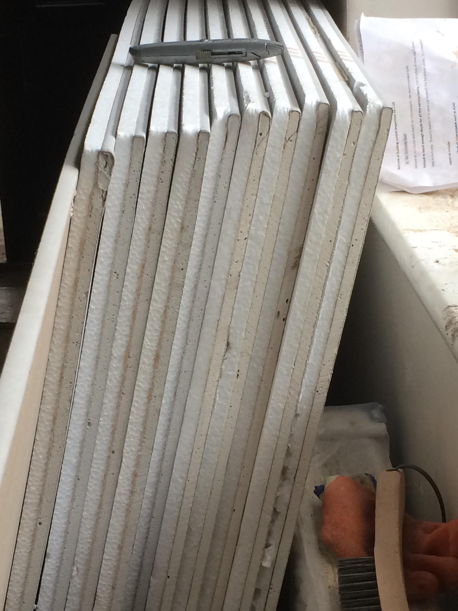

Photo attached of plasterboard builder suggests 22ml siniat PUR board
https://www.siniat.co.uk/en/products-and-systems/products/internal-boards/gtec-eps-thermal-board
this is product. Is it right one???

I have just done one of my rooms and put 50mm of kingspan / calotex up below the ceiling and I filled above with 300mm of rock wool.
The 50mm insulated calotex / kingspan  plasterboard (62mm  including plasterboard face aprox... ) would be my preference as a minimal amount as it’s easy to work with, easy to cut etc. And then as much rock wool above as is feasible.   I think you really need to think about wall insulation, yes you will loose a bit of space but your heating bills will be so much cheaper ! I am putting in 75mm insulated plasterboardon on my walls. I am sure others will be along with advise but your not I over thinking  it, if anything your under thinking it....... you need to insulate the hell out of it unless you want to live in a cold damp house or pay the electric company a shed loads of your hard earned cash every year for the rest of the time your living there.......

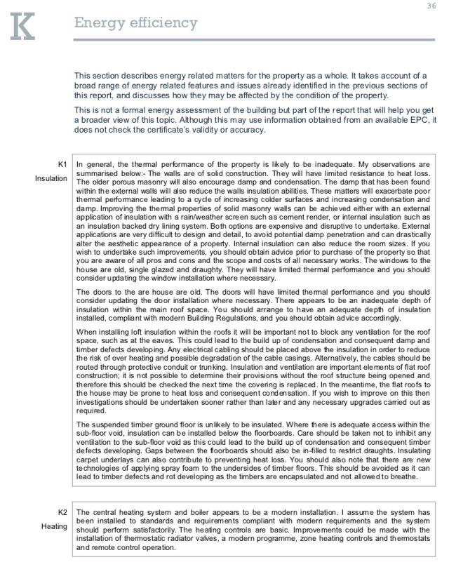

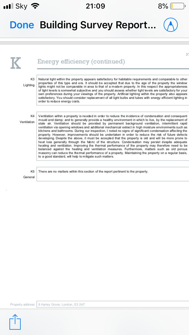

Oh thanks for clarifying. I don’t have EPC to hand, but attached is structural surveyors extract
thanks
