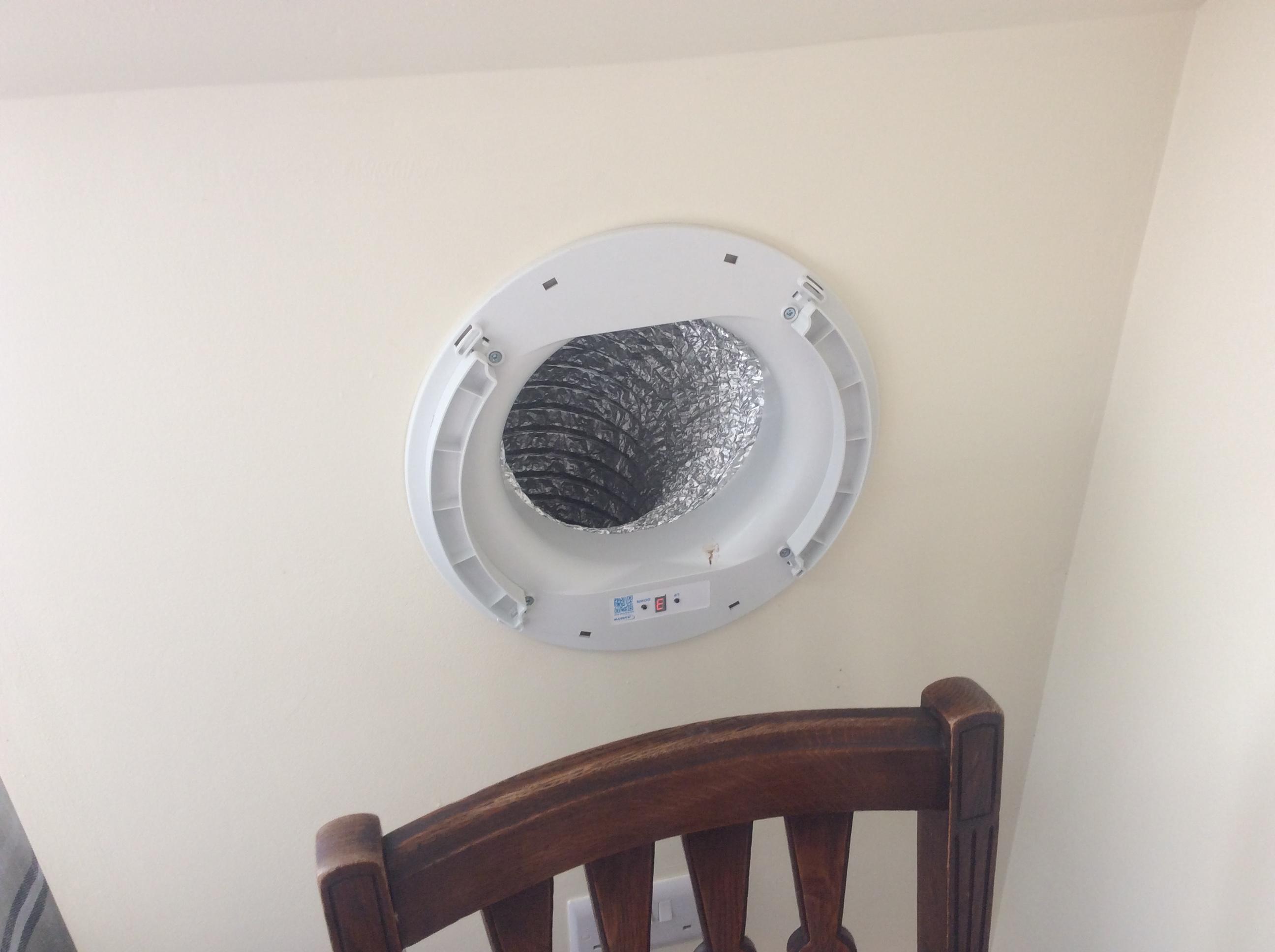

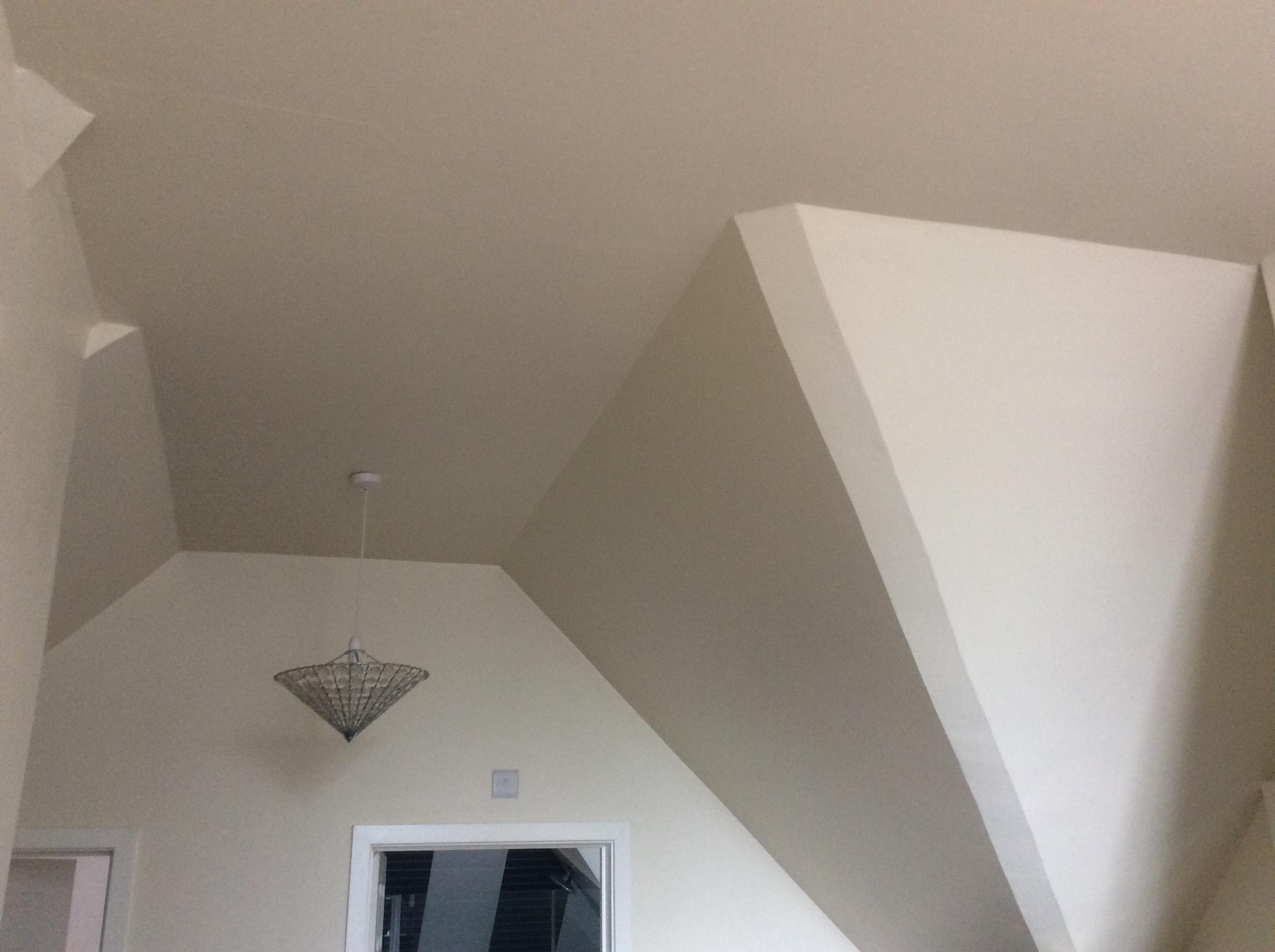

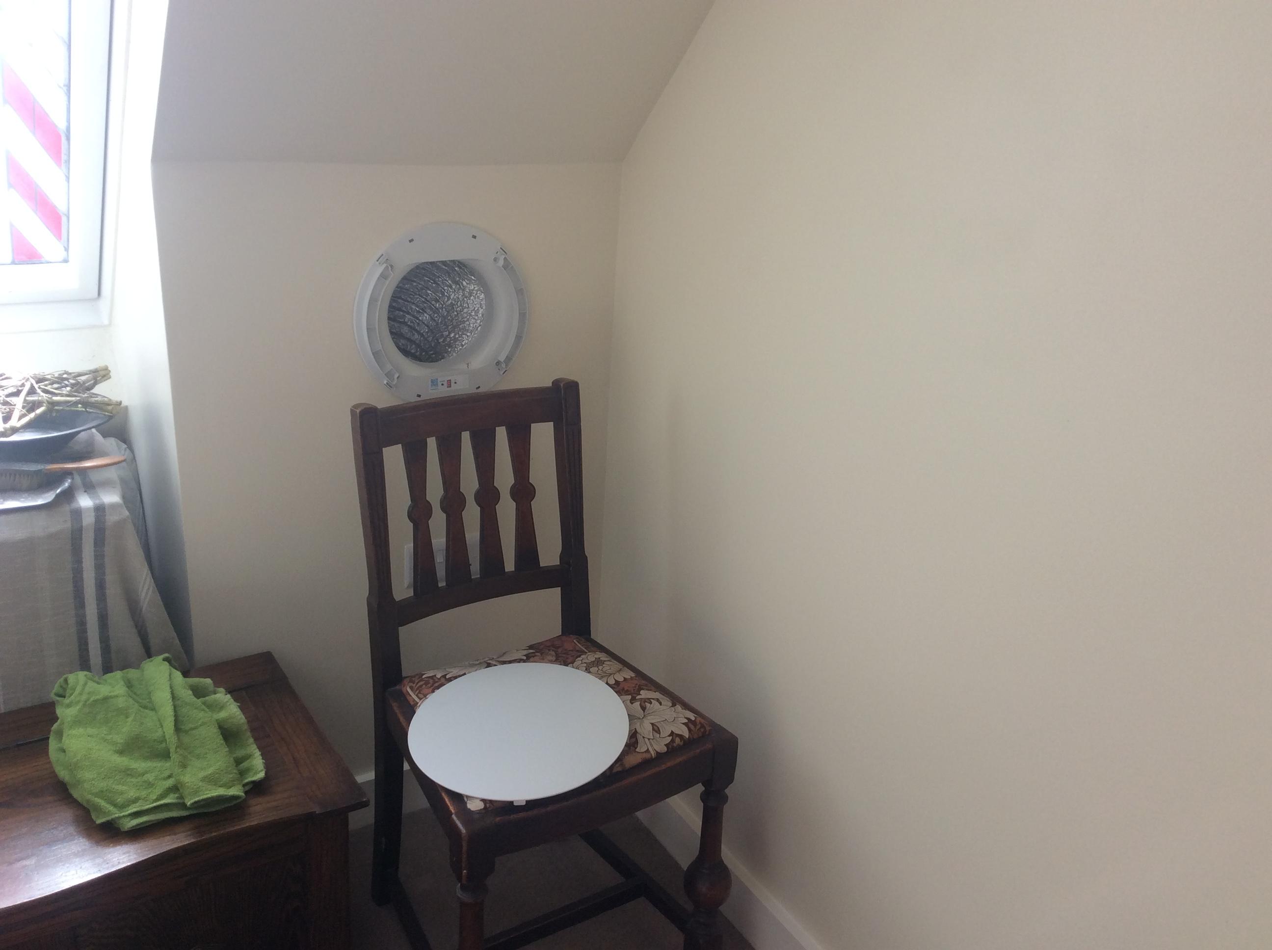

Ferdinand Posted August 12, 2019 Posted August 12, 2019 Quote m really keen to make the air quality as good as possible as I have a tendency for allergies. PIV has been on my list, it’s a big house (250sqm) so think we may need two but unfortunately no loft so will have to try and use something like the Nuaire FlatMaster and box it in. A pain as well have to drill some big holes in the external wall. I have a horribly complex room in roof setup, and my Nuaire Drimaster something something is installed in the toblerone space, entering the landing through the wall. Through the wall is iirc in a FAQ somewhere as OK. It is in a sealed in compartment inside the space made out of Celotex, and is supposed to draw its air through the roof. I suspect that to finish this off it will require a ventilation tile connecting from the outside due to the membranes as much of the air may be recycled from room leakage etc .. a little similarly to the way flues can go out through the roof. I think the bits are all available. I do not see why similar will not work for you. But access for filters etc will matter for you. I have the hall control version .. buttons under the cover ... but the remote and perhaps monitored version may be worthwhile. F

Benjseb Posted August 12, 2019 Author Posted August 12, 2019 Love the way you’ve done that Ferdinand. We literally have no voids though. It’s wall then roof so the only way to make that work would be to add a false ceiling and go out of the roof, but if doing that we may as well just go out the wall and box it in somewhere discreet.
