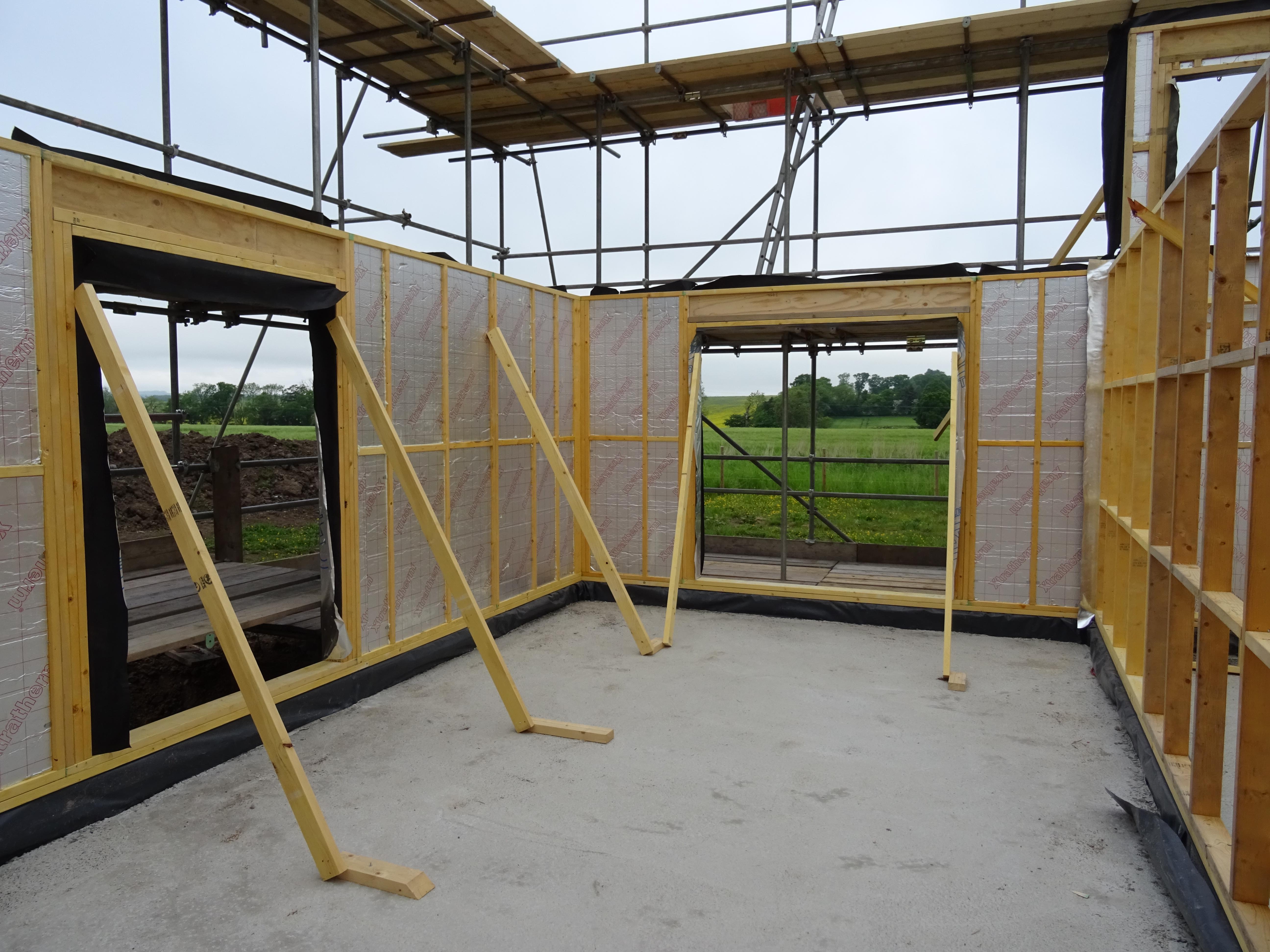

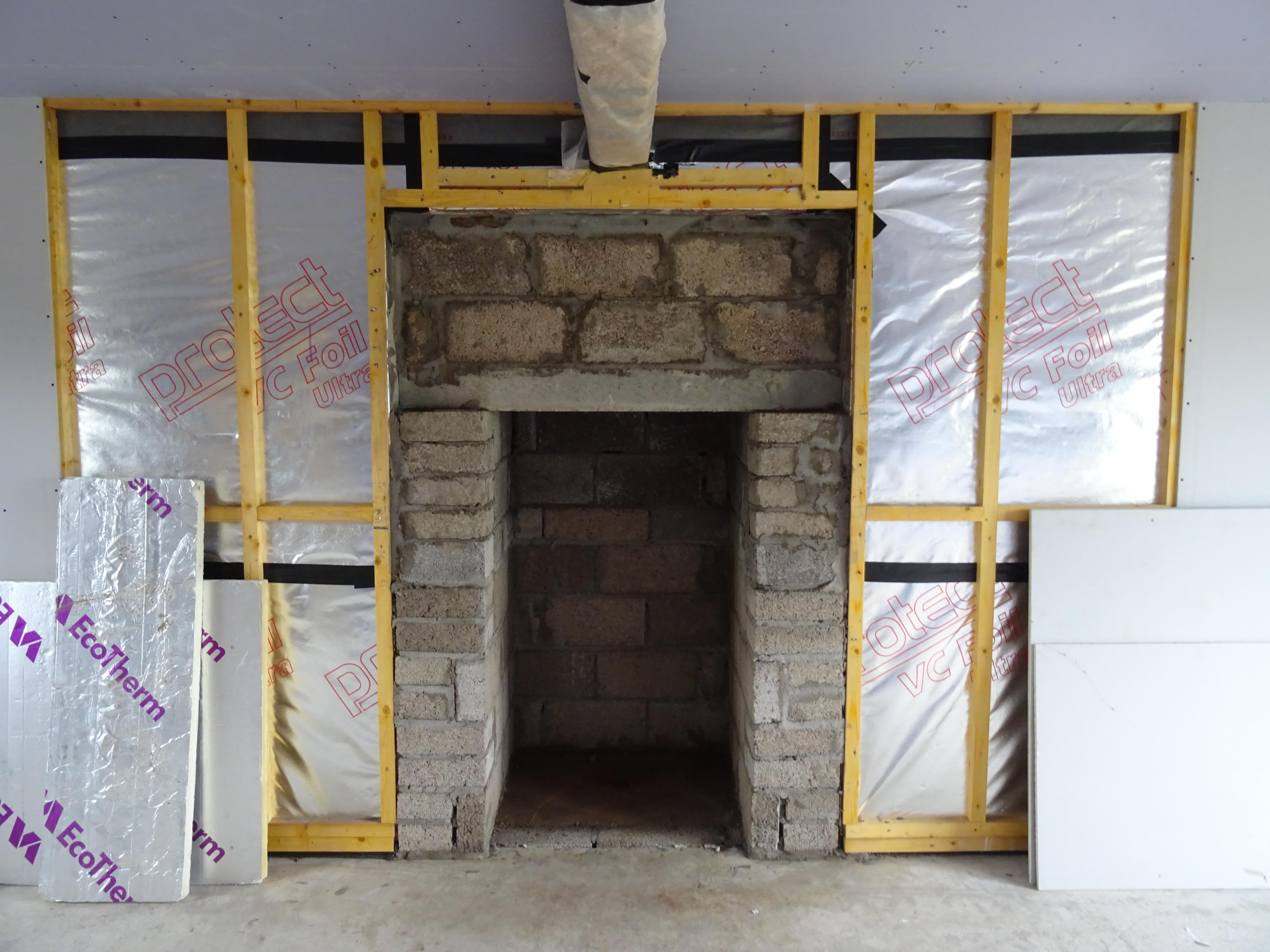

Redoctober Posted August 8, 2019 Posted August 8, 2019 Yes I agree with @Crofter - we had additional insulation to install once the TF had been erected. This went on prior to the vapour barrier being fitted and then the service batons went on thereafter - hopefully these images attached will assist - the first shows the TF having been erected and the second one will show the additional insulation having been fitted, then the vapour barrier fitted and sealed. The service batons are then fitted followed by the plasterboard.
