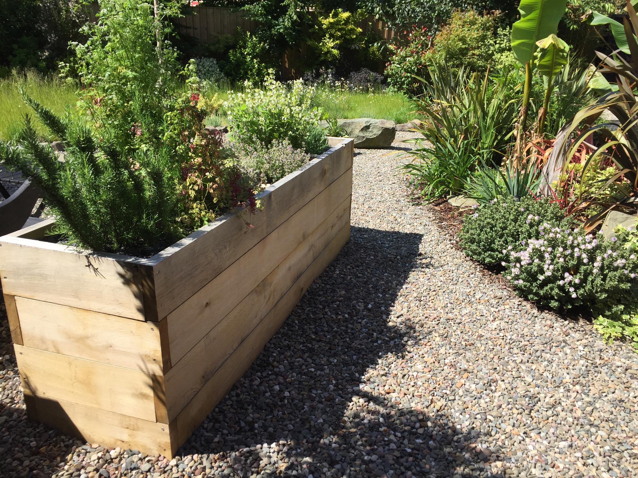

H F Posted August 6, 2019 Share Posted August 6, 2019 What is the name given to wood that is not edge-to-edge but where a design is formed by not being edge-to-edge - as in the picture? Link to comment Share on other sites More sharing options...
Cpd Posted August 6, 2019 Share Posted August 6, 2019 Not sure what your getting at, but “off set” joints ? Anyone ....... Link to comment Share on other sites More sharing options...
daiking Posted August 6, 2019 Share Posted August 6, 2019 The good old “Swastika butt joint”. sorry, just made that up. Some confusion here though. Do you mean how the joints alternate vertically or how the butt joints go round each level in a pattern? Rather than showing the same on each side of each end? Link to comment Share on other sites More sharing options...

H F Posted August 7, 2019 Author Share Posted August 7, 2019 22 hours ago, daiking said: The good old “Swastika butt joint”. sorry, just made that up. Some confusion here though. Do you mean how the joints alternate vertically or how the butt joints go round each level in a pattern? Rather than showing the same on each side of each end? Yeah, I was refering to the way the joins alternate at the edges, down the planter to form a pattern. Link to comment Share on other sites More sharing options...
Ferdinand Posted August 7, 2019 Share Posted August 7, 2019 (edited) 9 minutes ago, Home Farm said: Yeah, I was refering to the way the joins alternate at the edges, down the planter to form a pattern. Perhaps you need to quoin a name for it? ("Tony Tray" made it into the lingo in a small way). Edited August 7, 2019 by Ferdinand Link to comment Share on other sites More sharing options...
redtop Posted August 7, 2019 Share Posted August 7, 2019 (edited) i thought that was the way you always did it lol, so 'normal'. Only thing i would also do with raised beds like that is put some vertical wood (preserved 2 by 2 or similar, could be smaller) on the inside of each corner to hold the horizontal boards in line, stopping them a few inches below the top of the soil so cant be seen ? Edited August 7, 2019 by redtop Link to comment Share on other sites More sharing options...
joe90 Posted August 7, 2019 Share Posted August 7, 2019 1 hour ago, redtop said: i thought that was the way you always did it lol, so 'normal'. Only thing i would also do with raised beds like that is put some vertical wood (preserved 2 by 2 or similar, could be smaller) on the inside of each corner to hold the horizontal boards in line, stopping them a few inches below the top of the soil so cant be seen ? Or a long screw or rod down through the joints (need a long drill bit). 1 Link to comment Share on other sites More sharing options...
Jeremy Harris Posted August 7, 2019 Share Posted August 7, 2019 11 minutes ago, joe90 said: Or a long screw or rod down through the joints (need a long drill bit). That's how we did it. You can buy very long screws that are made for the job, often from the same places that supply sleepers for raised beds. Link to comment Share on other sites More sharing options...
Temp Posted August 7, 2019 Share Posted August 7, 2019 (edited) 7 hours ago, Home Farm said: Yeah, I was refering to the way the joins alternate at the edges, down the planter to form a pattern. I think all "layers" are made the same. They just turned alternate layers over when it was assembled. I'd call it "Butt jointed, clockwise/anticlockwise on alternate layers" Edited August 7, 2019 by Temp Link to comment Share on other sites More sharing options...
