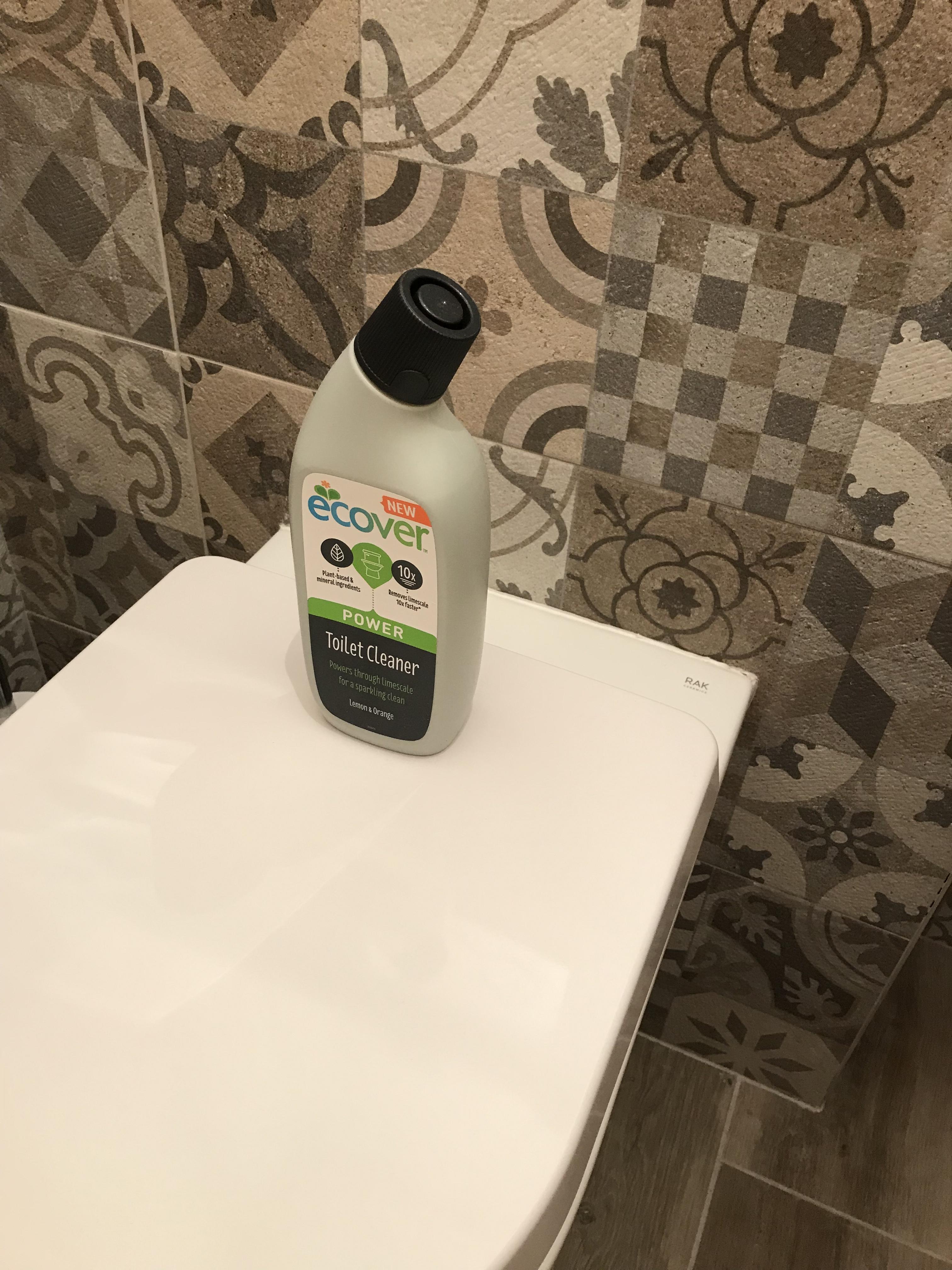

SWMBO loves a bit of bleach in water to do the working surfaces, tiles etc. Also after cleansing by the loos they get a squirt of bleach around the rim/pan.
What do you use instead?
It's all about moderation - we are on a treatment plant and have conditioned ourselves to read the labels in more detail in relation to various products. We only use those that state they are "septic tank" friendly and bleach IS one of those products.
