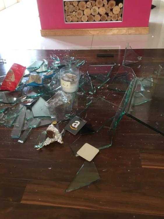

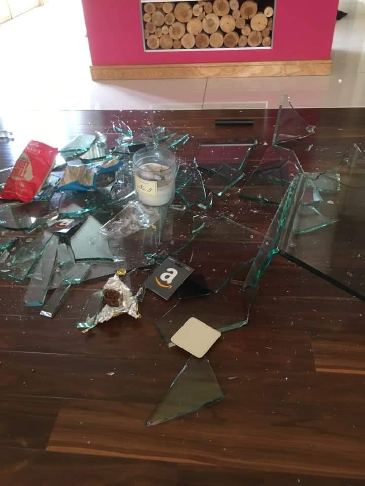

jamiehamy Posted July 26, 2019 Share Posted July 26, 2019 Friend had a glass coffee table shatter into a squillion pieces recently Link to comment Share on other sites More sharing options...

Mr Punter Posted July 26, 2019 Share Posted July 26, 2019 50 minutes ago, jamiehamy said: Friend had a glass coffee table shatter into a squillion pieces recently That does not look like toughened glass as it would shatter into far smaller pieces with very few sharp edges. 1 Link to comment Share on other sites More sharing options...
