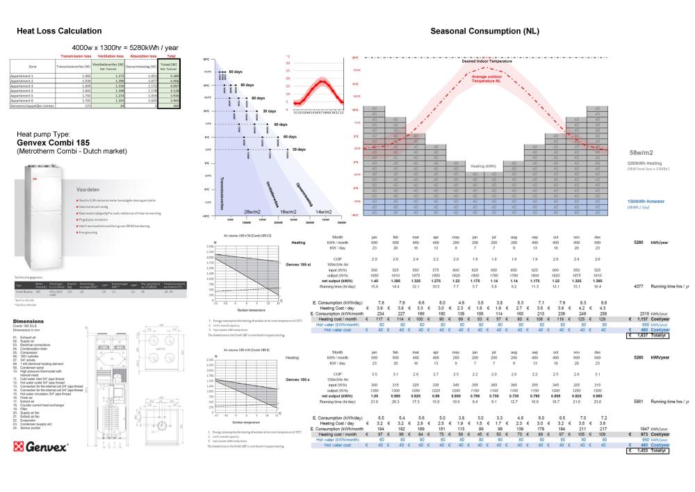

T M Posted July 21, 2023 Share Posted July 21, 2023 (edited) 21 hours ago, markocosic said: Nice one @T M It's not obvious what one ought to do in a modest home. Thanks for the info @markocosic. Yes indeed it is not very obvious which one to choose, which is why I wanted to post some of my findings about the ventilation heat pump to help inform others what I found. To respond to your comment above: each house has a unique set of parameters that needs careful consideration. 1) Small, Medium or large house 2) DHW demand High or Low 3) Climate cold, mild or hot 4) Existing build or new build 5) Well insulated or not 6) existing radiators (high temp) or floor heating (low temp) or ducted system (air) 7) Local installers preference, parts, maintencane & service (the more common the cheaper it will be to maintain) 8) Budget and operating cost targets. 9) Ground source option, Split outdoor units possible, or no outdoor unit possible. 10) Personal comfort: floor heating, airconditioning, radiators, In my case we are building a new, small, highly insulated house in a mild climate with a low DHW demand, good Vaillant and Mitsubishi service and have an option to have an outdoor unit. So that narrows it down to basically three options: Air to Air (no outdoor unit) Air to Air (outdoor unit) Air to water (Split) Here is a general estimate of the cost and comfort of the three options: 1) Air to Air ventilation (Genvex Combi 185 or similar) €8000 + installation €2000 is also the balanced ventialtion system. Operating costs €1700/yr comfort 5/10 Cost after 10 years = €27000 2) Air to Air split (Mitsubishi multisplit) €2500 + installation €2000 + balanced ventilation €1500 + Water heater €1000+ Operating cost €900/yr comfort 7/10 Cost after 10 years = €16000 3) Air to Water split (Ecodan or Arotherm) €8000 + installation €2000 + floor heating €4000 + balanced ventilation €1500 + Operating cost €600/yr comfort 9/10 Cost after 10 years = €21500 So conclustion: If you are on a budget and value having airco more than floor heating go for option 2. If you want more winter comfort, DHW and quiet, with less summer cooling comfort go for option 3. Edited July 21, 2023 by T M Link to comment Share on other sites More sharing options...
T M Posted July 21, 2023 Share Posted July 21, 2023 19 hours ago, Beelbeebub said: From my reading of the specs, the r744 (CO2) unit really only comes into its own providing high temp (65+) water from cold mains, as @markocosicsays, they are different from normal heatpumps in that the COP is very dependent on the return temp being low. I.e. they work more efficiently providing a flow of 75 from a return of 20 than if the return was 55 - wierd I know. So the advantage is you can create a store of very hot water, which means you can have a smaller cylinder. I guess that's why they are popular in Japan. Thanks @Beelbeebub for you elaboration of the difference between the technology of the Ecodan and the Arotherm. Yes indeed the Ecodan is more exotic and operates at about 20degrees higher so would be ideal for a traditinal high temperature radiator retrofit or if you want a smaller indoor unit and more DHW: Ecodan 200L 1600x595x680mm Arotherm 190L 1880x599x693mm I was more trying to get a grasp on categorizing the different types of heatpumps (air-air, air-water, and water-water) categories and costs. To me I see the Ecodan and the Arotherm split heat pumps in the same family (air-water) with a specialization in high or low temperature heating output. Both are very efficient and get good reviews and depending on the heating system and installer preference could be a wise choice. Link to comment Share on other sites More sharing options...
T M Posted July 21, 2023 Share Posted July 21, 2023 21 hours ago, markocosic said: The Mitsi unit linked above looks fun. It really comes to life when producing HOT water with a LARGE temperature rise. (CO2 heat pumps best at say 60/30C) https://refrigerationcomponents.co.uk/ecodan-4kw-monobloc-air-source-heat-pump-with-thermal-stove-quhz-w40va.html Can they do cooling? Yes the Ecodan can also run in reverse and cool water to a temperature of 5°c But if you have floor heating with hardwood floors there are issues with condensation (mold) so is most safe if you have a concrete floor. The cooling function does not work that great with radiators but helps a bit. The mini-split is better at cooling and also dehumidifying, and can also heat in the winter so if cooling is important then a mini split might be a better option. Link to comment Share on other sites More sharing options...

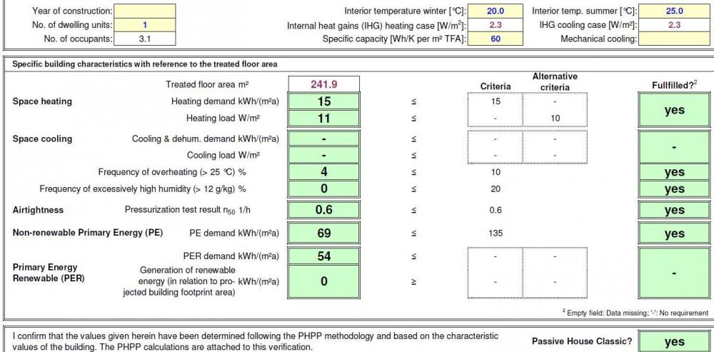

Iceverge Posted July 21, 2023 Share Posted July 21, 2023 On 20/07/2023 at 16:42, T M said: After a heat loss calculation was made by a professional it was determined the annual heat consumption would be approximately 5280kWh/year Heat transmission loss: 28W/m2 Ventilation loss: 16W/m2 Absorption loss: 14W/m2 I think your professional has wildly over estimated the heat loss. That is almost 6 times passivhaus levels and you have near passivhaus insulation. Have you tried consulting the heat loss spreadsheet on here to see if your predicted losses are that high? 1 Link to comment Share on other sites More sharing options...
Iceverge Posted July 21, 2023 Share Posted July 21, 2023 7 minutes ago, Iceverge said: I think your professional has wildly over estimated the heat loss. That is almost 6 times passivhaus levels and you have near passivhaus insulation. Have you tried consulting the heat loss spreadsheet on here to see if your predicted losses are that high? Also what is your predicted electric price for 10 years? If you have an option of cheap overnight electricity it may be better not to install any heat pump but just enjoy the low capital outlay and trouble free operation of an immersion and a few storage heaters. For info 186m2 in the south of Ireland we use about 3200kWh for space heating and 3650kWh for a family of 4. Passive insulation levels. 2 Link to comment Share on other sites More sharing options...
T M Posted July 22, 2023 Share Posted July 22, 2023 10 hours ago, Iceverge said: I think your professional has wildly over estimated the heat loss. That is almost 6 times passivhaus levels and you have near passivhaus insulation. Have you tried consulting the heat loss spreadsheet on here to see if your predicted losses are that high? Yes that is what I thought too. So I had another company also do the heat loss calculation and they came to a very similar result. There is a very specific methodology in the Netherland that all professionals follow to make an official heat loss calculation report. I asked about this and he said they need to assume all the worst case scenario of a very cold winter with extended temperatures of -10 degrees which almost never happens, but theoretically could happen. The professional I hired did the calculation for the ventilation heat pump which he said uses more energy because it has to continuously heat up large volumes of outdoor air so he added +16W/m2 for ventilation loss. The true heat loss is about 28W/m2 (in extreme conditions) the Absorption loss is a safety factor they also use here. But it is comforting to hear that your home is over double the size and uses less energy than we have modelled. If we used a split heat pump with balanced ventilation (with a heat exchanger) we can cut the ventilation loss out and if we take the safety factor out then the actual energy consumption will be more in the range of 2600kW/yr for space heating in an extreme winter and probably in a normal year the space heating demand will be more like your house using about 18-20W/m2 Link to comment Share on other sites More sharing options...
T M Posted July 22, 2023 Share Posted July 22, 2023 10 hours ago, Iceverge said: Also what is your predicted electric price for 10 years? If you have an option of cheap overnight electricity it may be better not to install any heat pump but just enjoy the low capital outlay and trouble free operation of an immersion and a few storage heaters. For info 186m2 in the south of Ireland we use about 3200kWh for space heating and 3650kWh for a family of 4. Passive insulation levels. The average price for electricity in the Netherlands is around 50cents /kWh Some electricity providers have off peak rates that are between 10-40cent/kWh That could also be an interesting solution to use an immersion heater and buffer tank (like a battery) and charge it with low tarrif electricity and solar energy. This would have a simiar operating cost as a split heat pump and much less upfront investment cost. Very interesting idea, thank you! I will investigate! Link to comment Share on other sites More sharing options...
