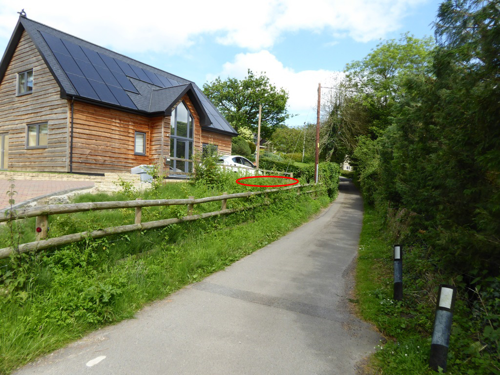

SlivenClod Posted July 22, 2019 Posted July 22, 2019 Has anyone used/got experience of thin film solar cells? I am getting resistance form HWMBO that PV panels are ugly "I'm not having those on my nice new house!" The plan, at the moment, is for raised seam metal roofing and I understand this works well with TFSP and I might get it past the design guru!! TIA
PeterW Posted July 22, 2019 Posted July 22, 2019 Aren’t the efficiencies on these only 3-5% versus 19% for standard panels..??
Jeremy Harris Posted July 23, 2019 Posted July 23, 2019 Yes, the efficiency of thin film panels is a fair bit lower. Worth looking at ordinary black panels, as these are almost indistinguishable from thin film when viewed from ground level. We have black panels set into our roof:
