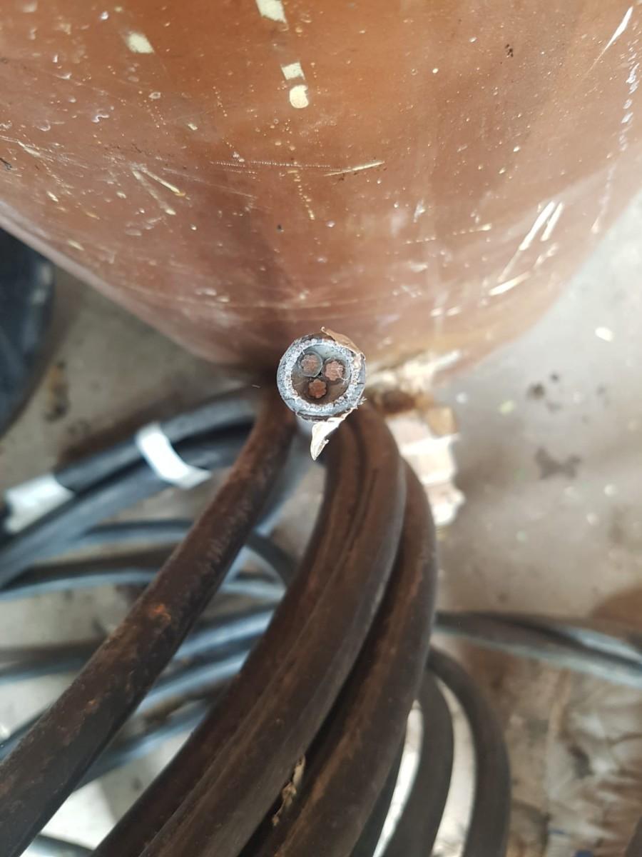

Gone West Posted July 19, 2019 Posted July 19, 2019 I have a 6mm2 three core SWA cable that I am running to my shed from the CU in the house. The supply to the house is TN-C-S. I was planning to use one of the cores as the earth and also the steel wire as the earth. I watched a video where it states that it is ok in most instances to use a two core and use the steel wire as the earth. In my case it is more complicated as my shed is metal. In the video it states for TN-C-S the earth should be 10mm2 for a metal shed but doesn’t explicitly say that it can be made up of 6mm2 copper core and the steel wire. I could use an earth rod for the shed but as he says on the video why bother when the DNO provides a perfectly good earth. What is the view of my plan? https://www.youtube.com/watch?v=NvENsVUhDUs

Oz07 Posted July 20, 2019 Posted July 20, 2019 Slightly hijacking here but what is the pros/cons of having electric meter installed near garage then taking a feed from garage to house. I know Dave and Jeremy have similar arrangements and I have oppertunity to do this on next house. I would want power to garage anyway so need a cable regardless. I won some pretty thick cable off a job the other year. Offcuts on a warehouse. One advantage I can think is no need for consumer unit to be in a position 3m from meter in house.
