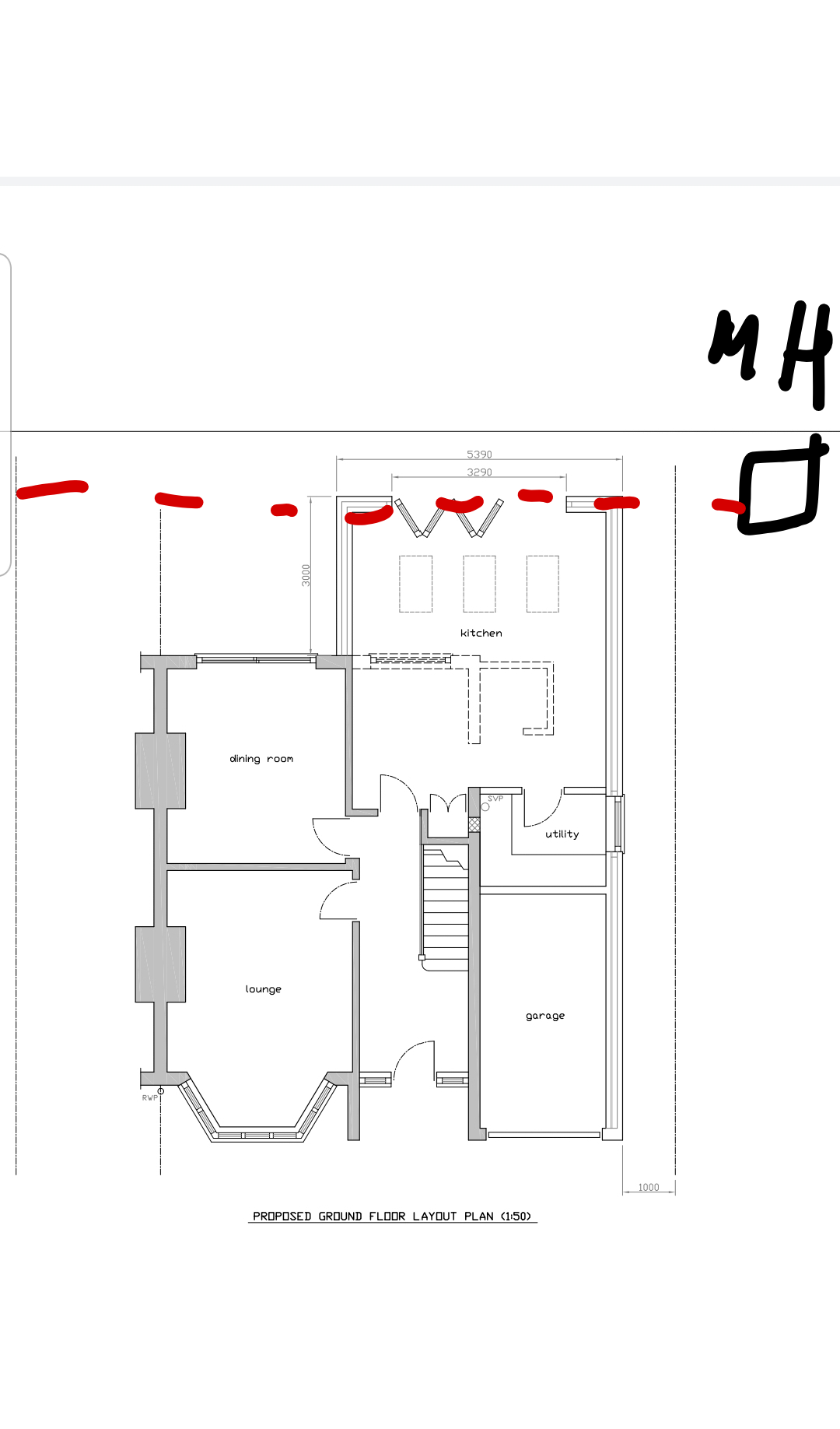

Johnjames32 Posted July 16, 2019 Posted July 16, 2019 Good evening all. Having recently started our 2 storey side extension and single rear, weve hit a bit of a snag..... sewer drains. Having spoken with Seven Trent before work commenced our utilities provider as well as the local council (neighbours had an extension fairly recently), neither had any records of any existing drain/sewer runs across the back of the houses. We has dug our footings to just over 1m below ground level as advised by the architect. Building inspector visited the property yesterday and advised to dig about 150mm lower at the rear to achieve sandier ground conditions (similar to that of the side). In doing so, we've discovered what looks like an existing sewer main.... What would people advise? Currently the single story (where the trench and subsequent sewer run is located) is only half the width of the house..... could we divert and put x4 90° angles and redirect the sewer (2 at the start and 2 at the end of the run)... I understand we would need permission from Severn trent but this seems the most logical approach? It would mean digging a new trench running parallel to the existing?! Would welcome advice please..... https://ibb.co/ZdwPs23
Russell griffiths Posted July 16, 2019 Posted July 16, 2019 Oh bugger, that just got expensive. I wouldn’t use 90 bends they are to sharp, but it’s hard to say what you are proposing from that picture.
Jeremy Harris Posted July 16, 2019 Posted July 16, 2019 As @Russell griffiths says, I think we need a bit more info. Can you try and see where the inspection chambers are, relative to that pipe you've uncovered? There should be inspection chambers wherever a drain connects to that one, so in line with that run. Tracing back where these are will give you a better idea of what you're dealing with. It's debatable as to whether this has anything to do with the water company, it could be just one of your own drains, or it may even not be a foul drain at all, but a rainwater drain leading to a soakaway. 2
scottishjohn Posted July 16, 2019 Posted July 16, 2019 37 minutes ago, JSHarris said: As @Russell griffiths says, I think we need a bit more info. Can you try and see where the inspection chambers are, relative to that pipe you've uncovered? There should be inspection chambers wherever a drain connects to that one, so in line with that run. Tracing back where these are will give you a better idea of what you're dealing with. It's debatable as to whether this has anything to do with the water company, it could be just one of your own drains, or it may even not be a foul drain at all, but a rainwater drain leading to a soakaway. yep a a bit of Archaeology required on your part

Johnjames32 Posted July 16, 2019 Author Posted July 16, 2019 Thanks all. You'll have to forgive the terrible drawings as I've just done it on my phone on paint, but you can see the manhole (neighbours property) and where the existing drainage runs through out footings
joe90 Posted July 16, 2019 Posted July 16, 2019 No manholes on your property?, where are your drains?. My sister had drains for the street running through her backyard which caused problems with extensions.
scottishjohn Posted July 16, 2019 Posted July 16, 2019 (edited) replace full length that goes under house with modern plastic -encase in concrete and another manhole at other side ? no doubt someone will comment if this is allowable Edited July 16, 2019 by scottishjohn
Mr Punter Posted July 16, 2019 Posted July 16, 2019 I would replace the run and divert the whole length with 4 no 15 deg bends. It seems odd that it does not serve your property. Anything on your deeds, such as rights for others to run services over the land?
ProDave Posted July 16, 2019 Posted July 16, 2019 It might serve your property. In a previous semi detached house we had a pipe like that, with the manhole next door almost on the boundary, and indeed out waste connection went into that chamber in next doors garden.
