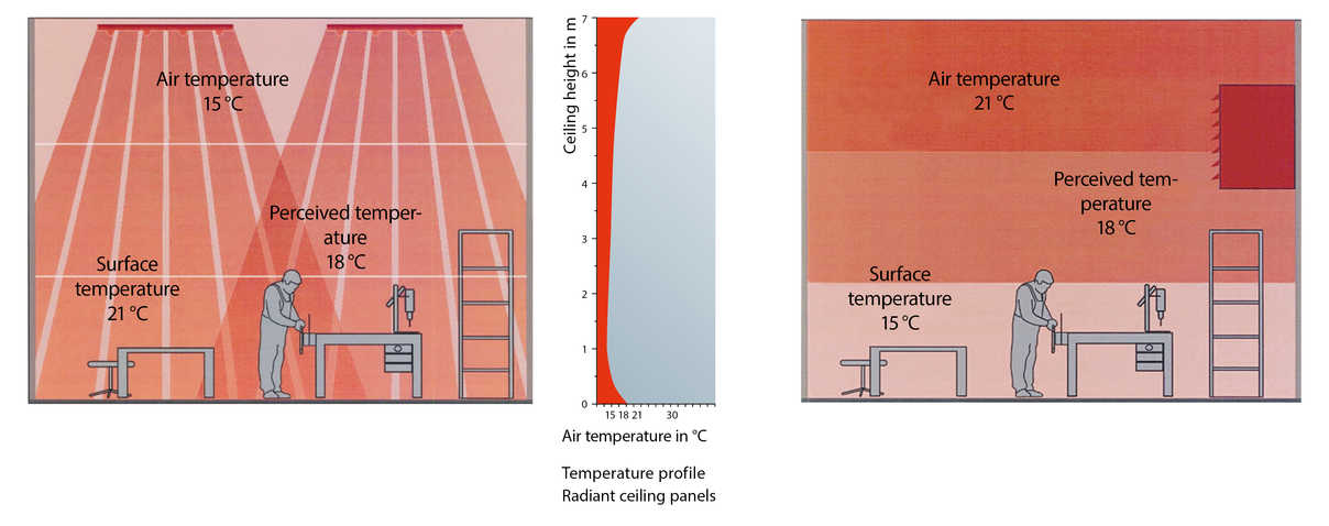

Dan F Posted August 12, 2019 Share Posted August 12, 2019 This is the Zehnder explanation. https://www.zehnder.co.uk/products-and-systems/heating-and-cooling-ceiling-systems/benefits/system-comparison Link to comment Share on other sites More sharing options...
Jeremy Harris Posted August 13, 2019 Share Posted August 13, 2019 8 hours ago, Dan Feist said: This is the Zehnder explanation. https://www.zehnder.co.uk/products-and-systems/heating-and-cooling-ceiling-systems/benefits/system-comparison This really needs thinking through carefully, to unravel the inherently flawed logic in their explanation. If you take the case of a room with a very high heat loss rate, then what they say sort of makes sense a bit. However, if looking at a reasonably well insulated house, then the explanation only makes sense for a few minutes after the heating has been turned on in a cold house. After that, the radiant heaters will have warmed up the floor, walls and all internal stuff and they in turn will have warmed up the air, so in reality all that's happened is that the air has reached a warm temperature, such that when the heating has been on long enough for the thermostat to cut off the whole room will be warm. In essence this is identical to UFH, but with the disadvantage that a warm floor is generally perceived as being more comfortable than a cold floor and a warm ceiling. I've spent lots of time working in hangars that have radiant ceiling heaters that work just like these, and the combination of cold feet and a warm upper body isn't a pleasant one (it is probably the only way to make an inherently cold space workable, though). UFH delivers most of its heat by radiating it into the room, exactly like these panels. The radiated heat warms the other surfaces in the room in the same way (but from the opposite direction), plus there is some direct air heating, as well as the indirect air heating from the warmed surfaces. The same thing applies after the heating has been on for a time, the air gets up to an equilibrium temperature. Link to comment Share on other sites More sharing options...

Wil Posted July 27, 2021 Share Posted July 27, 2021 (edited) Well, that would do it. So the surface temperature of my roof would need to be 100degC to achieve 800W/m2 if my room surfaces were at freezing? This somewhat belies the fact that my 1800W electric radiant heater used to heat me in my shed pretty happily. Does this mean those units outside pubs are at 200degC on the surface or something? Edited July 27, 2021 by Wil Link to comment Share on other sites More sharing options...
SteamyTea Posted July 27, 2021 Share Posted July 27, 2021 9 minutes ago, Wil said: Does this mean those units outside pubs are at 200degC on the surface or something? Yes, or hotter. If ceiling mounted radiant heating worked, we would all be doing it. There is also the distance from the radiant source to take into account, though at a couple if metres, this is not generally significant, and the object you are trying to heat, which may have an exposed surface area many times smaller than the emitter. Also, humans breath, so regardless of the person's surface temperature, if they are breathing in cold air, they will be cooling. Link to comment Share on other sites More sharing options...
