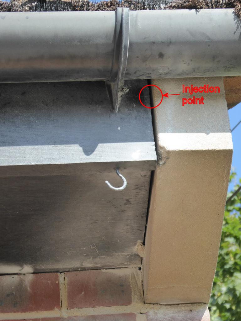

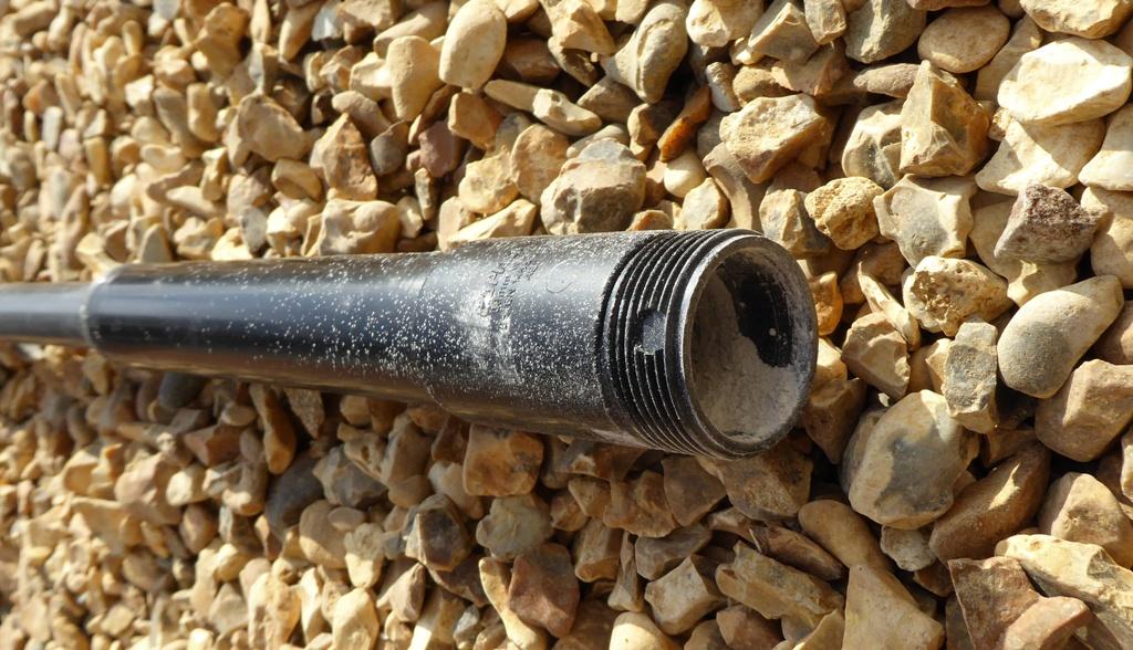

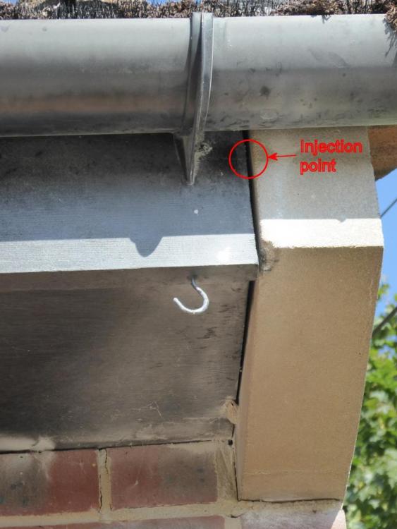

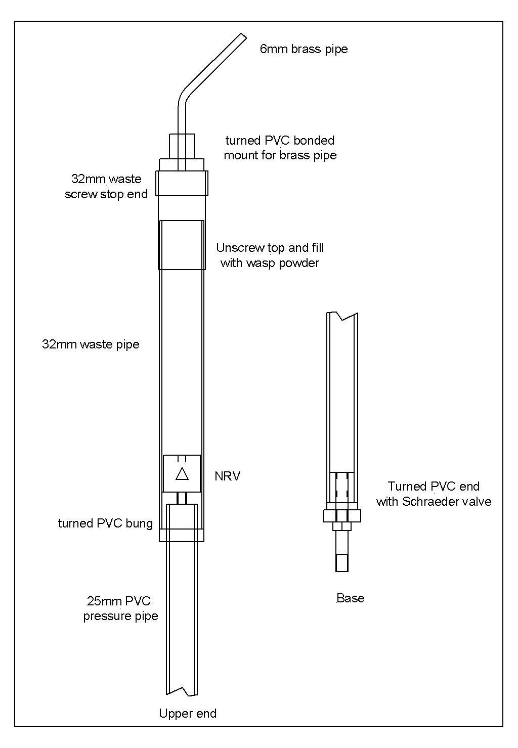

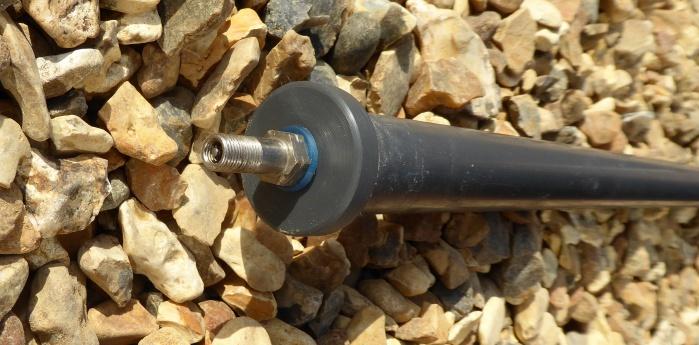

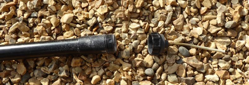

Jeremy Harris Posted July 5, 2019 Posted July 5, 2019 I made a gadget to blow powder into a wasp nest entry hole, whilst standing a safe distance away. Works really well: 2

nod Posted July 5, 2019 Author Posted July 5, 2019 18 minutes ago, Temp said: Google says do it at night as they are less aggressive then. Use a red cloth over your torch to stop them heading for your light. 16 minutes ago, JSHarris said: I made a gadget to blow powder into a wasp nest entry hole, whilst standing a safe distance away. Works really well: Ingenious JS Ive seen worse on the dragons den
Jeremy Harris Posted July 5, 2019 Posted July 5, 2019 Pity you're the other end of the country, as you'd be welcome to borrow it. I just used a compressor with the tyre inflater hose to blow air into the base, which blows the powder deep into the nest. Takes a couple of seconds, and if done in the late evening is pretty safe. Still a good idea to run away as quickly as possible, though, as the little buggers get mighty angry, very quickly.
