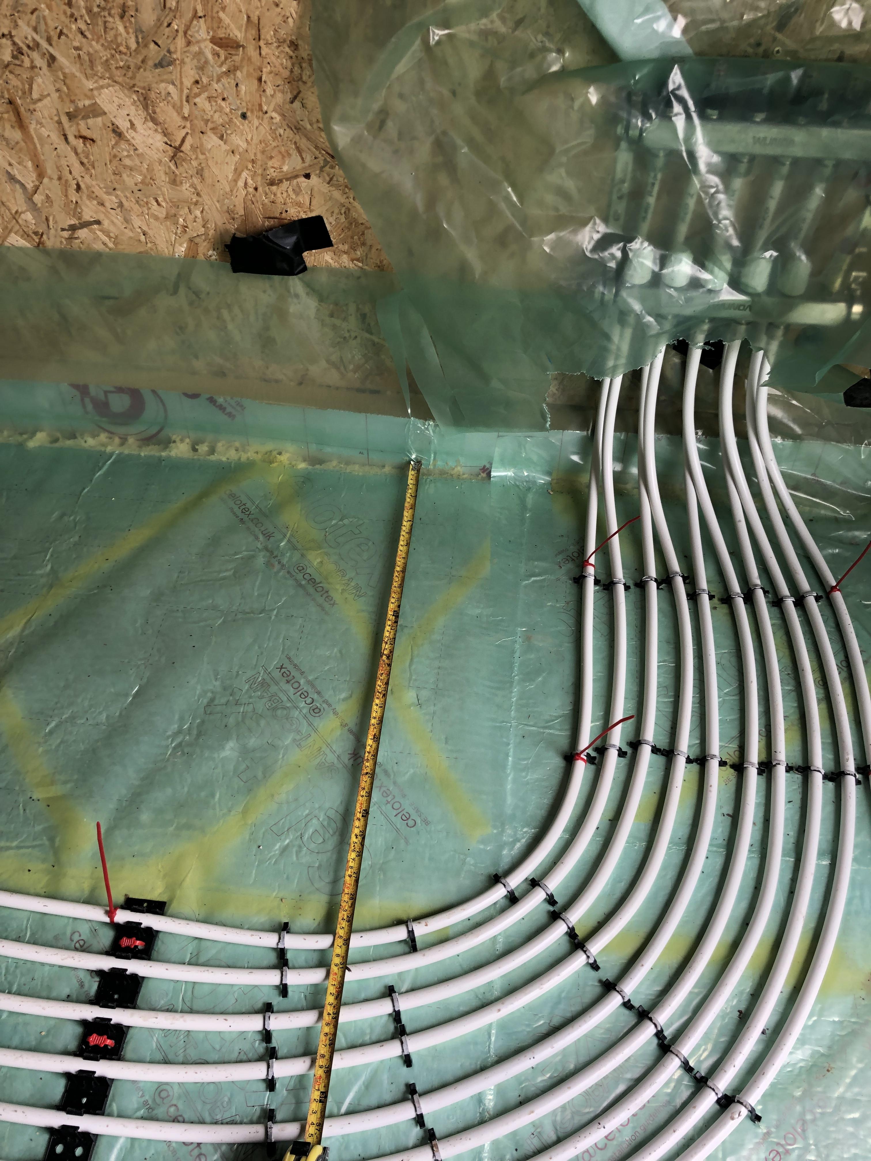

joe90 Posted June 14, 2019 Posted June 14, 2019 2 hours ago, pocster said: i did take loads of photos with a tape measure in the floor This is what I did in case I needed to fix anything to the floor, luckily I have not had to. 1
Pocster Posted June 14, 2019 Author Posted June 14, 2019 Tape measure and zip ties . All bases covered ( he says now ... )
