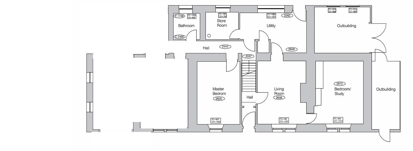

I think this is roughly what we have once the doors and leantos have gone, and walls as per the plan upthread, leaving the pillar and a pier of garage wall at the bottom. I have left off the wraparound proposal at the back replacing the conservatory (ie windows and doors in that wall can be played with), since it is not built yet. North is to the right.
Front to back is about 32'. internal Width of garage + kitchen along front wall is about 22'.
Wow @Ferdinand,  thanks for that! Just in response to the warren. the architect wanted the Master Bedroom for my parents and I wanted to use the 'dining room' which is the workshop  as their second bedroom. It is better with the door into the back hall blocked up and if it means I can save 21k not converting the workshop and I can use the money upstairs or on a nice kitchen diner I think it is money better spent... (she says).

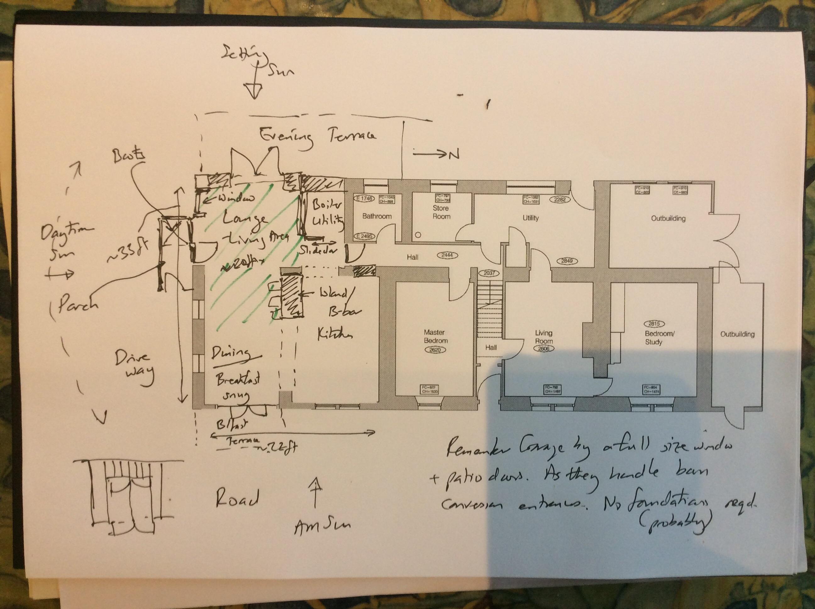

All fair comment, though taking out a wall like that should only be 2-3k .. others here will have better guestimates.
As for the other end, this is a few ideas which are different to what has been posted so may be useful.
I started with replacing the garage door with a big window (again not that much money) including patio doors, and putting the boiler and utility room (as small as is practical) next to the bathroom (close to waste pipes etc), and working off where sunlight would be, and leaving to all more open (new  walls cost money).The perambulation around the internal window from the hall to your space seems to me to be a bit crippling on the kitchen ... just put a door there and make it glass.
I would also also look very seriously at ASHP and carefully consider the specification of the fabric, most of which you have to do now.
I agree with you on the porch .. far more coherent an entrance than that placement of the boiler room, oil boiler apart.

Hi @Powerjen
I have just read your original post.
It sounds like you really want to do something for your parents which is great, but I just don't know if your timescales are realistic.
Have you confirmed that the work is PD? Checking the rules, dormers on the road frontage of a house are not PD, not is work less than 0.3M from the edge of the roof. I really like what the architect wants to do upstairs but I don't see how all those changes to the roof would be PD. It could be worth checking with the council whilst you are thinking about things.
Assuming not PD and considering the amount of work to the roof, I think you'd be lucky to be finished by next summer. Looking at your QS estimates, I do not think that they are as excessive as suggested. If you are employing a man contractor to do things then it is not cheap. A lot depends on the spec of the ensuite, kitchen, windows etc. I would also be worried that in an old building with stone walls, extra costs could easily come up once you start digging around.
If you want things done quickly and cheaply, would you consider just doing the downstairs work at the moment? This is probably faster, cheaper and PD.
I know you have a tight budget, but what is your view on your return on investment. I had a quick look and would guess that house values in Dumfrieshire are £150-200 a square foot, so for example converting the outbuilding to a dining room may not actually pay for itself. You said that you want the second bedroom if one of your parents gets sick, this is quite a personal decision, but I suspect that if they are that sick they won't be in the house for long and the second bedroom may not be necessary. Admittedly it is not that difficult to do, it is just costly.
I would consider an ASHP and doing away with oil fired CH. It may make things easier. Do you intend your parents' space/future let hot have a separate boiler and heating system?
Is there space to add a carport at the north side of the house? It seems a shame to shade the south side. Could it replace the outbuilding there? The downside at this end is that access into the house is not easy unless you have the dining room and go through there.
In terms of the ground floor, I think your parents' area works, and the one or two bed option is down to you. I would make sure that the en suite layout works for old people.
I think @Ferdinand's layout is the cheapest way of getting an open plan room that works well. If you move the carport to the other side then you could combine the two windows on the south side to get more light in. You could also make the porch area larger and put the utility room there getting a larger lounge area. If you want a carport there you could make the porch/utility room the back of the carport.

Hi @AliG Thank you for your detailed reply. The architects plans were a variety of options for us to cost out and then see what was worth doing and what we could afford. The first floor extension which went about the original ridge height would need planning, as would the front former windows and extending the roof out above the garage knew kitchen diner). Since this is taking far longer than we had ever hoped I am determined to only do things allowed under PD and it seems we can afford to do these things that need planning anyway. I can't see anywhere that there is a limit to the amount of PD you can do to your house in one go as long as you stick to the guidelines for each element.
I think all we can afford to do upstairs is to try put a dormer on where the first floor extension was imagined (above my parents kitchen). I need to fit a superkingsize in there. I hope I can. It would cost too much to move the current upstairs bathroom into the Hip roof so it will just get a makeover. Hoping to be able to remove the wall to the left of the stairs as you go up and have an open plan bedroom with maybe a door for privacy at the bottom of the staircase.
I think we just have to bite the bullet on the fact we might not get the money back we are spending. My parents are helping cost wise. We don't envisage moving and have always planned to do an equity release scheme later on as we have no kids to leave it to. We couldn't live here if we had to share it long term so would never separate the two parts of the house. Even having it as a possible holiday let makes me sweaty. We are moving the boiler and HW cylinder out of my parents side of the house so it's away from there if we did let it. It just seemed easier to keep all the heating and electrics as one big house (and on our side). But we need to future proof it so if we need to let it out we can.
As the house is down hill of the garden around it and quite shaded at the southern end I am not too worried about the carport being there. The kitchen diner will be brighter than it is now by opening out into the outside wall and with a roof light or two but appreciate your comments.
