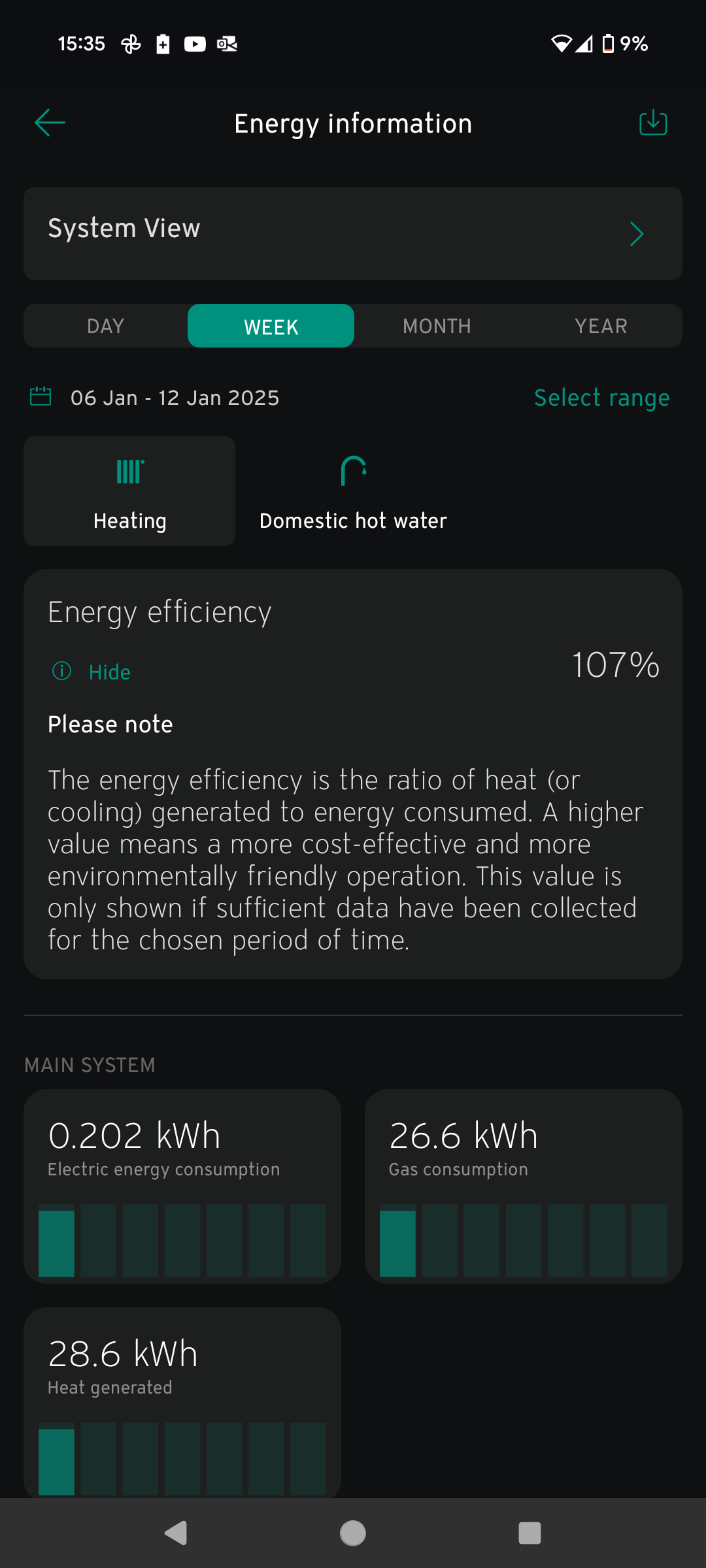

Vaillant Ecotec plus 630 system boiler efficiency on controller
j_s replied to j_s's topic in Boilers & Hot Water Tanks
@burgessl It's in the My Vaillant mobile app under energy info , you select it in the bottom right once the app is opened. Looking at it again I should have clicked on the big obvious info button on the energy efficiency box 🙄 -
I will try and get it done but no promises as need to get a load of diy stuff done, not so fun with these cold temps currently. I'm not sure how to change the settings or see the return temps, modulation, pump speed etc.
JohnMo, yes aware of condensing mode thanks. I had read that this is what makes boilers run in the 90 to 95% efficiency range and also why so many households are not getting the most out of their boilers as not setup correctly. I run mine between high 20s and high 30s flow temps using weather compensation but will take internal temperature into consideration and switch off. It is range rated but modulates down to minimum it will go most of the time anyway. John Carroll, yes it is the latest Vaillant Ecotec 630, not looked into the hydraulic modes but will see what I can find. So the efficiency is Vaillant's interpretation and a certain point of view rather than the true efficiency. -
Does anyone know why my Vaillant would be reporting the efficiency as 107% ? This is for central heating and perhaps less so for the Newark heatgeeks cylinder but hot water shows as around 103 or 104 most of the time. This is surely impossible as I'd be lucky hitting the max efficiency of above 90% although would like to think it's up there. Heat curve is 0.6. Ultimately it's not an issue just interested how it could come up with that. All controls are Vaillant and installed in late September with the latest wireless Sensocomfort that I believe is a very recent release. Thanks.

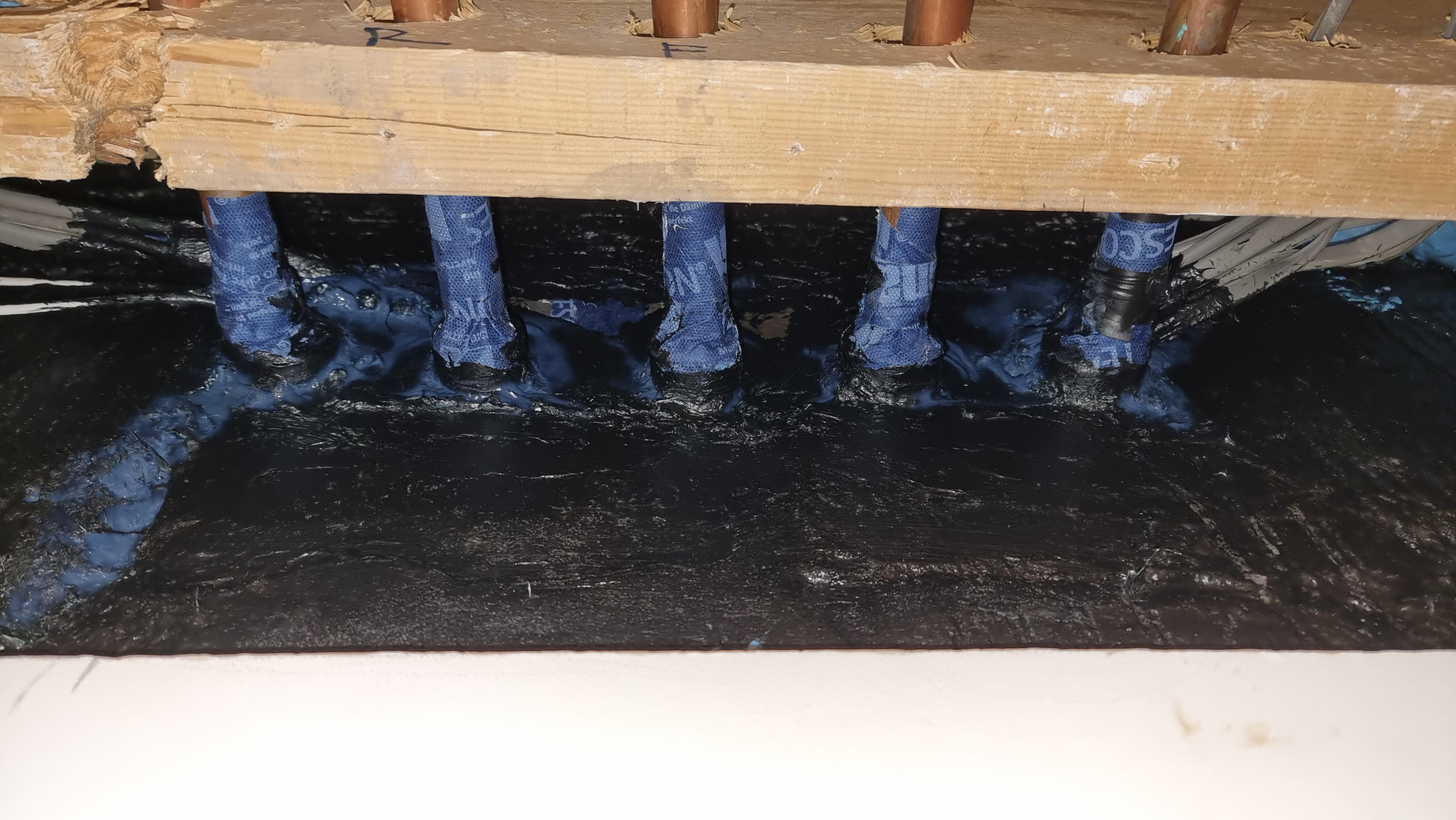

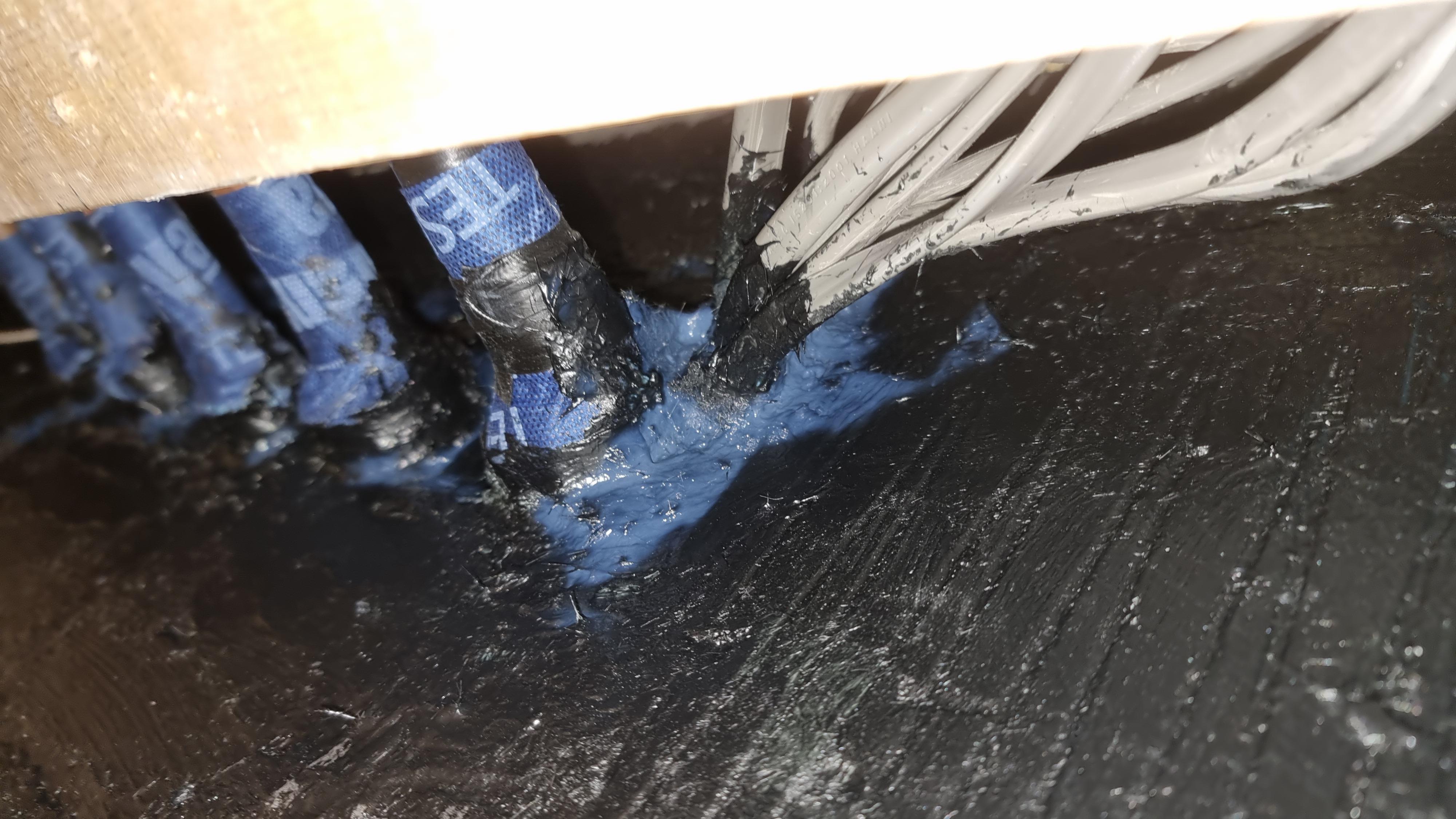

Update. Yes it's taken me this long to get round to it. Removed excess Dritherm insulation. Cut back plastic pipe very carefully with a dremel. Tescon airtight tape around all incoming pipes sealed to plastic protection pipe (stop copper from touching mortar), first used rubber amalgamating tape over cold water feed as the close proximity of me was causing it to get wet from condensation, not much, just enough to stop tape from adhering well. I cut 25mm pir board as best as I could around the pipes and cables. Cut it in 2 to make it easier to fit. Using loads of airtight foam to then fix them in place, including the boards to each other. Let it harden and then foam up all gaps. Trimmed excess foam. Tape pir board joins. Used sticks like **** to fill more likely hairline gaps. Finally, blowerproof airtight paint over everything. Result, draughts gone. I hesitate to say but I reckon it isn't far off airtight there now. Sitting on the dining room we always had a draught feeling as it's open to the hallway where this hole was before. Now, we don't even with the windy weather recently. True test will be when it gets colder of course.
