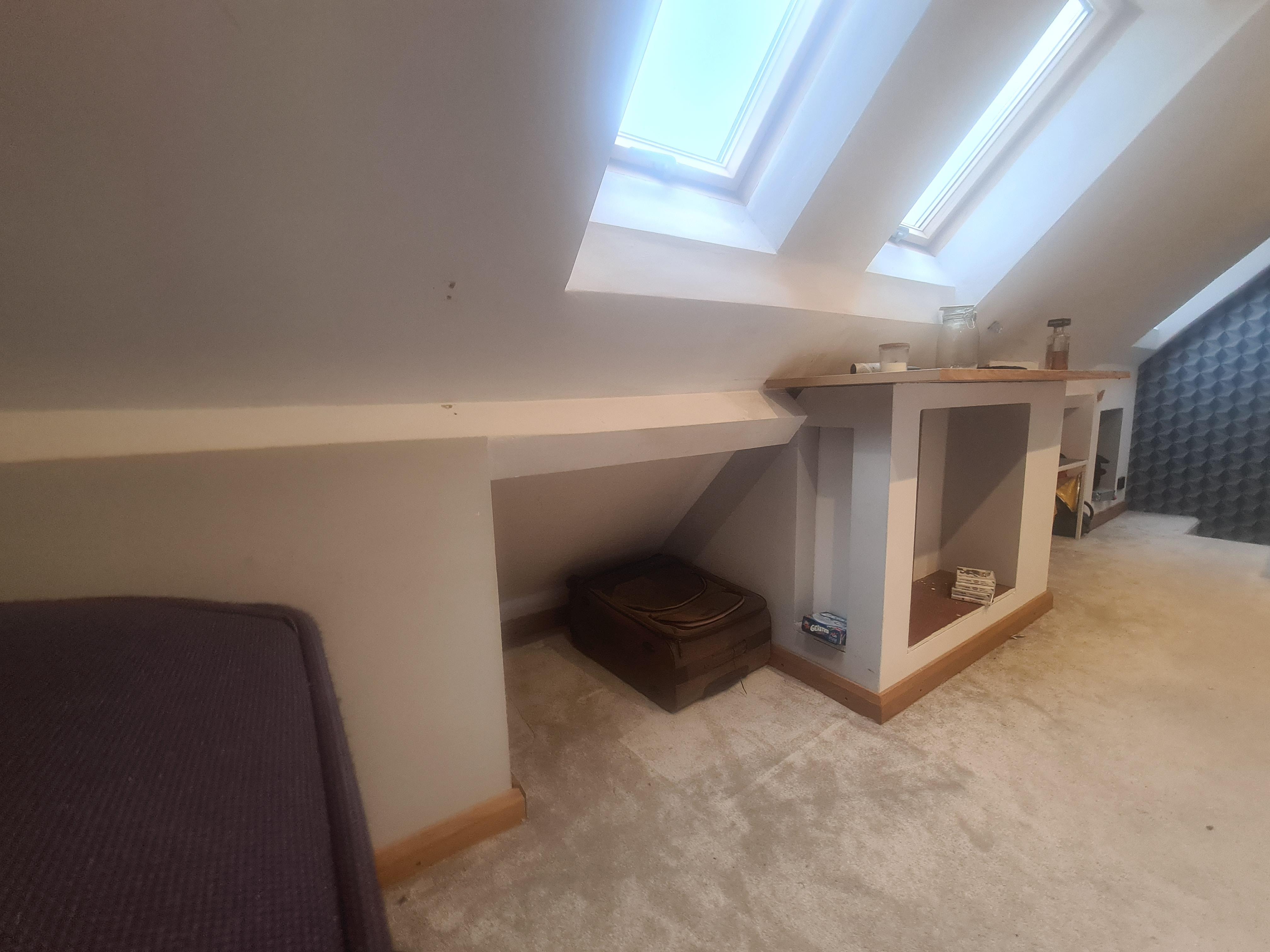

  18. I had exactly this on my loft. Steels directly below purlin timber upright every x apart, boarded front and back with osb. When widening the distance between the uprights the timbers were to be doubled either side with a caveat of no opening to be larger than x times 2. As for insulating I did it the hard way; the void was formed using the triangulation timbers at the eaves as the back wall- just enough vertical after insulation to put a skirting on- Stapled breathable membrane on the timbers fully filled gaps with wool, encased in pb and plastered insides. It's awfully awfull to do Plastering laid on your side in a trangular coffin. If your going to do it this way, do the awkward work in the eaves before before you make the purlin wall up. If you want to leave the void as a Cold space then just insulate the walls and any doors and use a good seal on the opening edges.

  25. It's been awhile since I converted my loft, but Im sure a portion behind the walls remains relatively un-insulated; So the floor was insulated all the way to the eaves tray vents,(the rafters had an un insulated portion of about a foot - where the timbers that bolted rafters to ceiling joists are) Then the dwarf wall was insulated vertically and between/below the rafters upwards untill the rafter tie above the ceiling. So there's a triangle at the top uninsulated and a triangle at bottom. They 're connected by a 50mm airgap, with lap vents inside and a ridge vent at the top. It's essentially an insulated cube inside a tringle. My felt was non permeable and there is a continuous airtight layer on the inner face of the insulation. You could insulate the entire triangle of the roof and not bother with the walls at all as long as its ventilation is sufficient.
