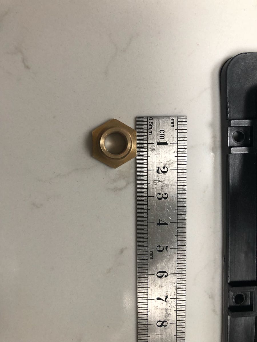

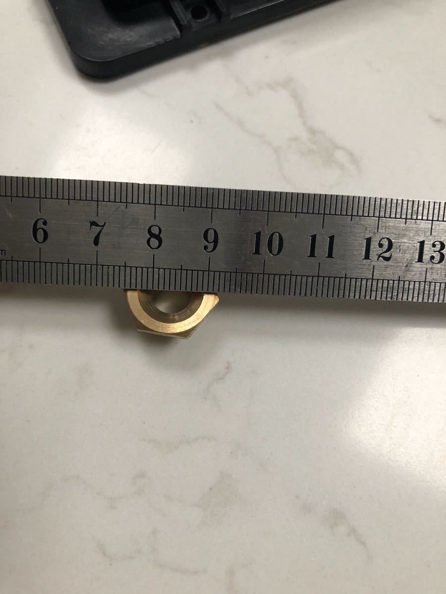

  6. FWIW the little brass fittings on the lights have a M12 thread so the hole through the middle is a lot smaller.

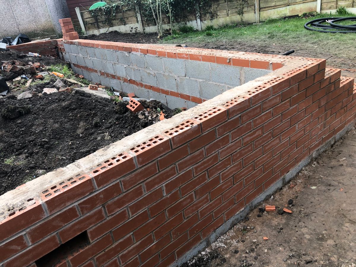

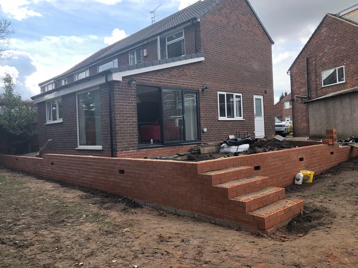

  8. You would need to ‘point’ the lights with mortar but I don’t consider them inaccessible . If they break/don’t work, just pull them out. Only 200mm or so deep, it’s not a cavity wall.

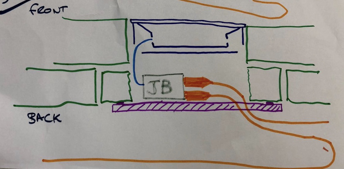

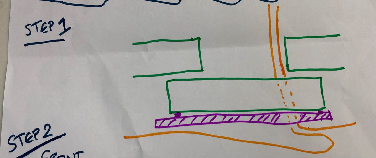

  9. Step 2 once the ground is back filled with stone and compacted and sorted, chase out the rear block, the sheet material stopping the stone falling in the hole. I’m assuming that after compaction there won’t be a large amount of pressure to burst through this skin, it should hold. Then you have more room to terminate the swa into a JB.
  10. Step 1 adhere some reasonably strong, reasonably durable with water sheet material to the rear face and drill through sheet and block to put conduit or swa through, reasonably long tail. Using long radius curves against rear of wall for cable/conduit.
  11. Do they need to be ip68? There will be a patio on top so no water soaking through the ground when it rains and they’re significantly higher than the grass level let alone any water table. And sheltered from the usual prevailing wind. I expect these holes to stay dry. Got an idea anyway.
  12. That’s the nub of it, leaving enough room to work. Taking out the equivalent of the 2nd rear brick might help.
  13. Now the dog can see the rabbit. 6 holes for 6 lights, cables need to come through rear block work.

  16. Yes

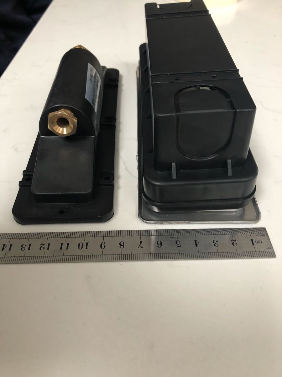

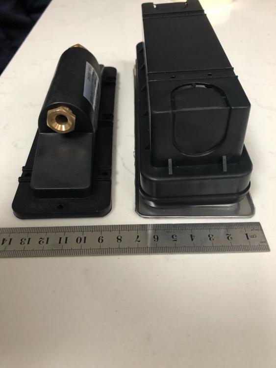

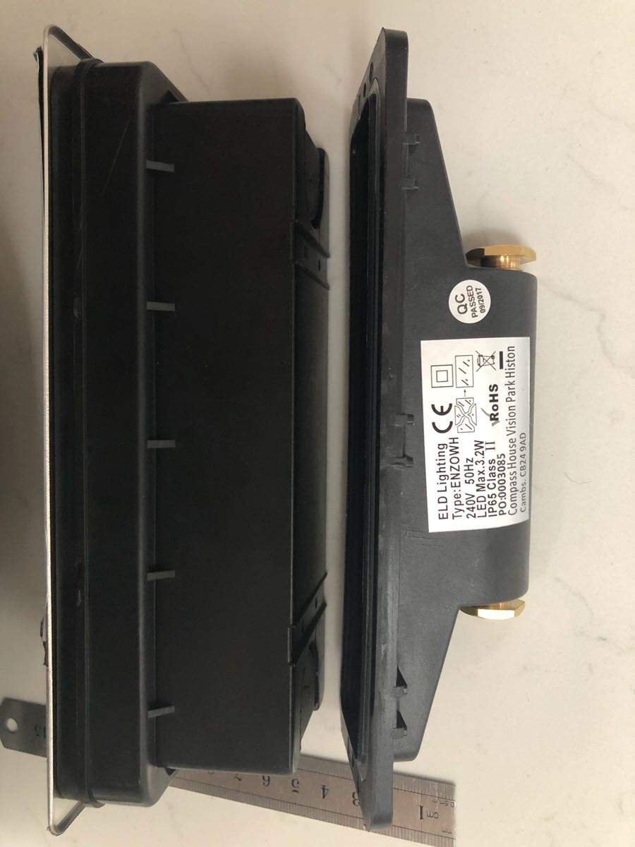

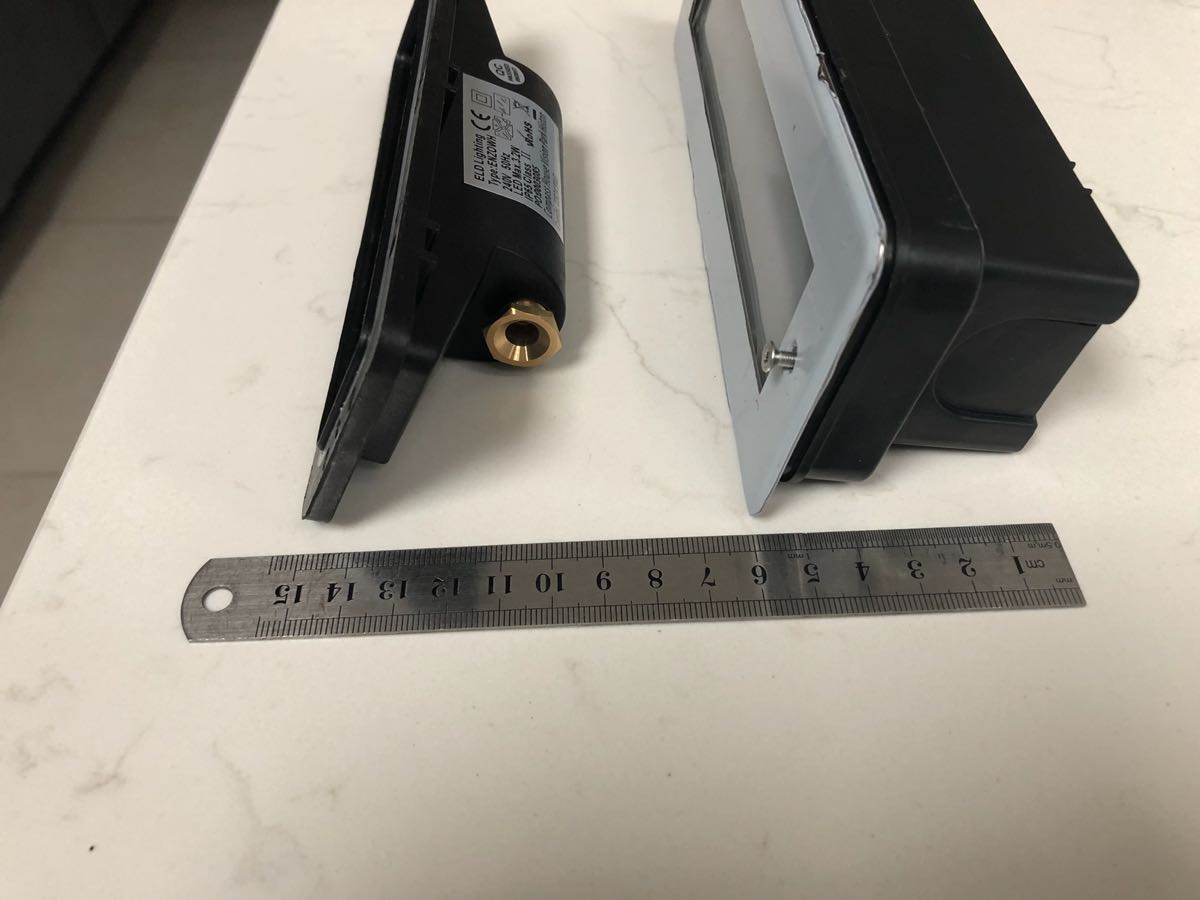

  17. No that bit with the details and sticker goes inside the bigger part. Just showing them separate as the smaller part is the interesting bit. Not sure on the thread. I’m away now till Sunday

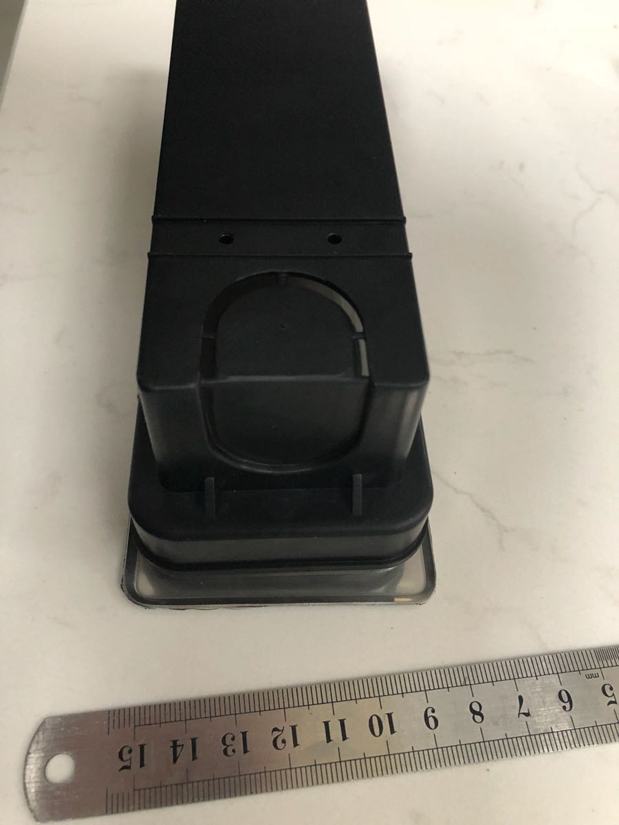

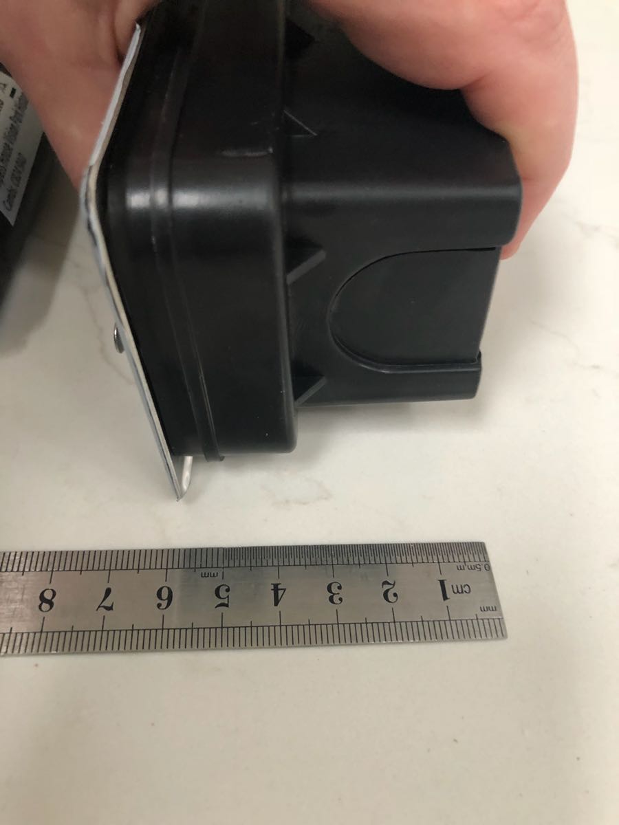

  21. Better photos of my lights. The face is a few mm smaller all round than a brick. The depth is only 60mm or so, not 100mm. The female thread the brass fitting goes into has some sort of thin/flexible membrane across it, presumably to slit for the cable and provide a ‘seal’ after. Can’t see there’s any way the swa is going to terminate that small. Despite the website listing as ip68 these are only ip65 on the paperwork. Should be ok in this use though. I’m now wondering if the only way to do this is lay 20mm flex duct now, complete the patio and then try to pull that more flexible outdoor cable through the duct after there is no longer any more potential to damage the cable? What do you think?
