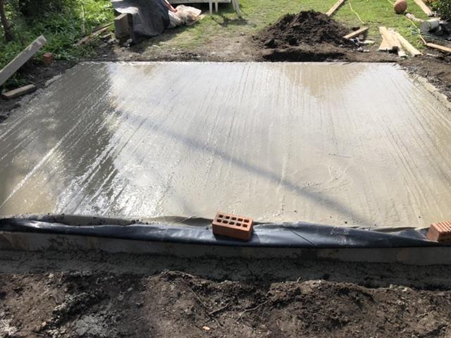

I'm not too fussed now, although the pigeons have bombed it, leaving holes to fill later. Its warm and sunny here so I've just watered it and pulled over a plastic sheet thats almost as big as the slab, will take it off tonight.

With the ‘extra’ concrete, I dig out the back and dropped it in against the back of the blocks. Not wildly impressed by our tamping skills but the forced labour wasn’t speaking to me. I am pretty sure it is not my fault but everything is certainly not fine. So it’s as good as we’re going to get ?

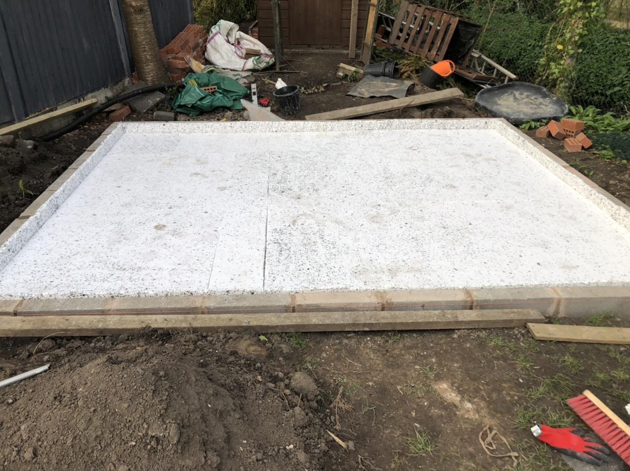

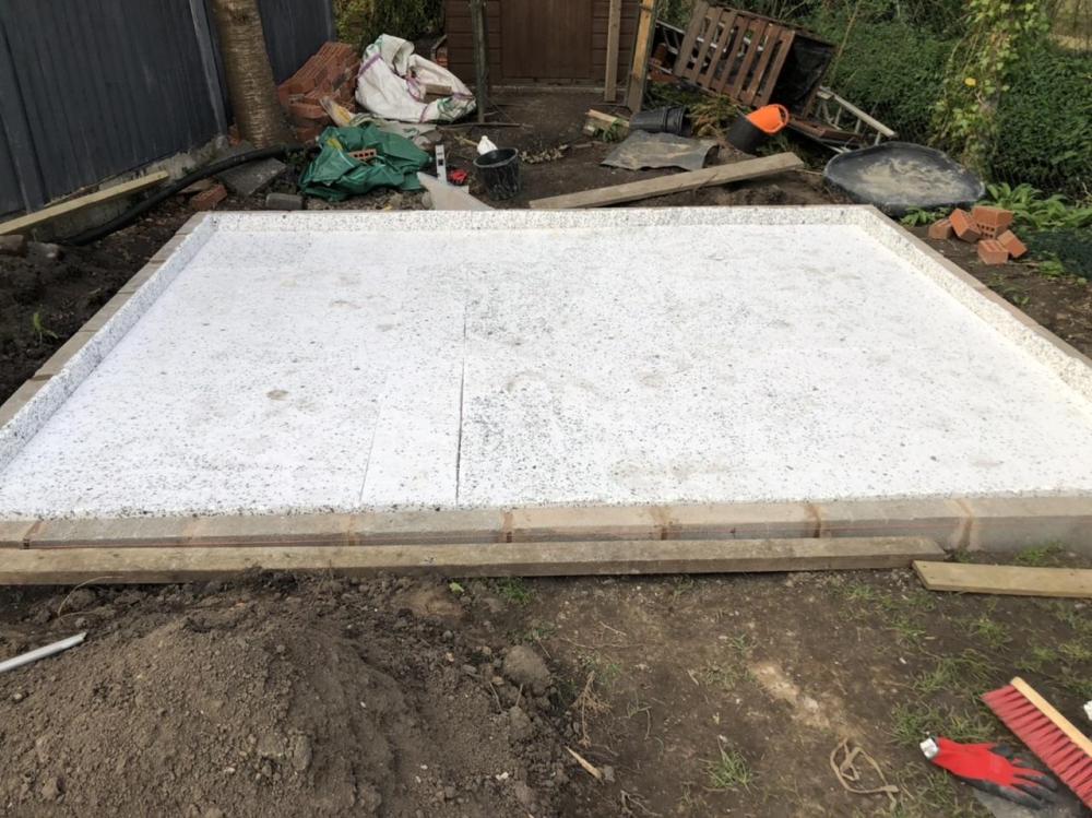

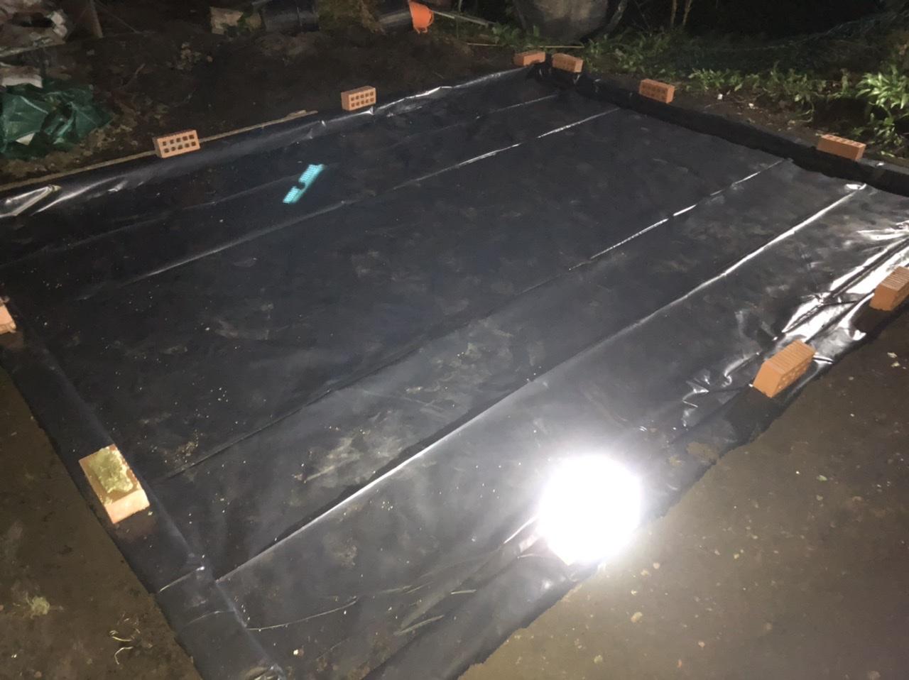

Got this far. Sub base wasn’t exactly level so the thin jablite is not sitting unless you crunch it down onto the stone. So the main layer is a bit up and down wobbly in places. I’m a bit high as well, probably only 75-80mm in free height left for the slab. Hopefully thicker in places where the jablite bends a bit. need to go out and put the DPM over it and backfill the trench so my blocks don’t fall over

I’ve been out till half 10 tonight (only started at half 4). Nearly there, standards dropped significantly but should be ok for the role. Concrete booked for Wednesday afternoon, hence the need to get done today. Will get up early to finish off 2 blocks. worried about them being set before the concrete pour. tomorrow night I’ll be putting the eps insulation down and membrane + significant backfill out side the blocks to keep them in place. 2 sides are pretty trenchy so I will slide to bricks in to prop them off the solid ground. The 2 more open sides will be banked up with a few planks and soil. I’m sure the instructions I’m following say blind the sub base with a 25mm layer of jablite. This is what I’m doing as there’s no time to get sand delivered now. Was just going to put the DPM above the jablite. But have to buy a massive amount so could put it under the main jablite layer as well as on top but don’t see the point unless anyone can enlighten me.
